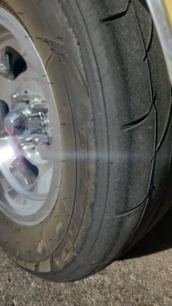

They're certainly rounded and the contact patch is less at the higher pressure. Everything is a compromise. I'm fighting sidewall deflection. The higher air combats that.... at the expense of contact patch. However, the tire deflection actually gets you some of that back.
Here's what 35psi gets you. Darn near scrubbed the letters on the tire. At 45 I'm just touching that shoulder indicator about an inch up from the edge of these scrub marks. At 35 psi I was understeering like crazy. At 45 I don't. My fastest runs are usually the 3rd run in a heat, after tire temp has raised, with tire pressure too.

after you posted this I read some other non-mopar threads about people running these tires (and other tires) and one guy made a very good point - contact patch is a good baseline, but it doesn't tell the whole story because it's usually taken going straight and not leaning in turns. Camber settings also affect how the tire will behave in turns. So, I'm inclined to run some higher pressures on mine and experiment. Thanks for the motivation! By the way, I'm only running the 555R's in the back and all season Mickey Thompson Sportsman S/T's up front, both 15". I may try some different tires at some point, but I'm 99% street.

No "chicken strips" on those tires!
