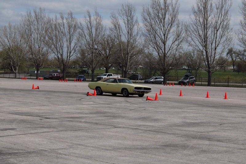

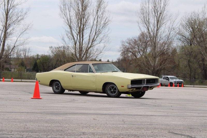

I thought I'd make this thread to log my progress and share info from taking my 69 charger autocrossing. If this is not the right place, mods please move it. I've read lots of threads on lots of forums and it seems like there's an interest in making these cars handle but not a lot of data to support recommendations. It's inspired by the b bodies and road courses thread by superbeemike. I've read that thread several times, used some as guidance, but also done my own thing.
My car is pretty plain. A 383 auto with an intake and headers. Stock cam. It still retains it's A/C even. With a full tank and me in it weighs 4080lbs. 2260 on the front 1780 on the rear. Weighed on a truck scale with 20lb resolution but close enough for me. I don't even take out my spare tire, jack, or other easily discarded weight.
I got the bug to go racing and so found a 7/8" rear sway bar and added a 1-1/8" front bar. Leaf springs and torsion bars are 65 year old stock pieces. Bushings, ball joints, etc good enough to drive on but not new. Shocks were the cheapest thing you could buy from napa. So a very cheap and very stock suspension aside from the sway bars. No chassis stiffening.
Tires are 205/70-14 front and 245/60-15 rear cooper cobras. Man talk about tire squish! I have video. Tires play peakaboo in the fender wells on corners. I played a little with tire pressure but found you really have to run them high to keep from driving on the raised white letters.
Brakes are 11" power drums on all 4 corners adjusted properly. I have no problem locking them up in a panic stop. Heat fade is not a concern. I've found my best times are the runs I use very little brake at all. But even if I intentionally push very aggressively my brakes don't warm up much.
So how does it run on the course in this trim? Slow. Not embarrassingly slow but I'm generally in the bottom 3. About 9 seconds off the top fastest guys on what we'll say is an average 50sec lap. Unfortunately I don't have a baseline with no sway bars. That might be interesting if I could unhook them at an upcoming event.
But how does it feel? Honestly not bad. If you try to brake hard in the corner it pushes pretty bad. If you're hard on the throttle it tends to get a little loose but if you can maintain a neutral throttle it feels balanced. But the tires are 100% giving up. So it's kinda like, the front slides, the back slides, or you d a 4 wheel slide. You're guaranteed to slide.

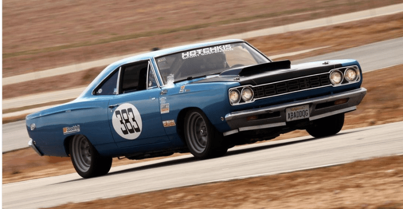

One word of caution - I also run an auto trans (big block 727) and have road raced my car a few times, but only once every few years. One of the guys frrom Hotchkis runs a total vehicle system on his 68 RR and tracks his car very often. I've seen him run in person a few times and have read a few articles where he talked about his autocross experience with that car. One thing that stuck in my brain was his transmission experience. He said he burned up three separate 727's before he converted the car to a manual trans setup. Transmission heat is your enemy and if you track your car often and end up pushing your car hard with that automatic with all the quick speed ups / slow downs, it may give you trouble sooner than you expect.

Here's Dan W's 68 RR and the article in question I had read:
https://www.motortrend.com/features/ccrp-1112-dan-weisharr-1968-plymouth-roadrunner/
Transmission:Obviously, a TKO-600 transmission is not original to the car. Dan finally switched to a manual trans after burning up five 727 automatics while competing in autocrosses and open track events. "It got to the point where I'd have one rebuilt and ready to go, one on the bench in the process of being rebuilt, and one out of the car waiting to be rebuilt," Dan says. "My friends and I got really good at doing the job. As soon as I felt the one in the car start slipping, we'd swap it out for the freshly rebuilt one." Realizing a manual transmission would be more suitable for the type of driving he wanted to do, Dan took the plunge on a new Tremec from Hurst Driveline.
In later articles I've read that when running his car he often just leaves the trans in 1st gear and uses the throttle, steering, and brakes to do the rest. The motor is a mildly worked 383 with not a lot of power.

OP, we need some full size photos of your car:) we're suckers for 2nd gen Charger photos around here.
