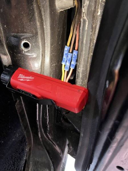

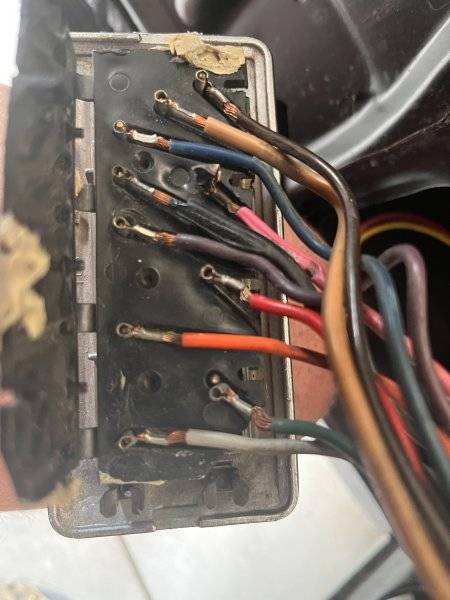

Harness is jacked. Last owner cut the wires in the door jams. Terminals at the switches are sketchy, and so is the 4 position switch.

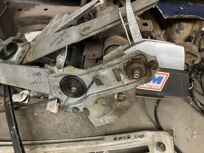

My 71 happens to have a section of quarter removed. This is inside.
This is the manual removed showing the spring. You likely have to pull the whole assembly. I’ll try and find a pic of mine out of the car.
No pic. Probably the only thing I missed on all the processes!
When you un-bolt the motor the spring is no longer controlled.... It won't dent the auto body but it can cause a severe injury to any flesh in it's vicinity... DAMHIK...
I've removed and installed many dozens of regulators both front & rear from B/C & E bodies... None have required that the motor be un-bolted from the regulator...

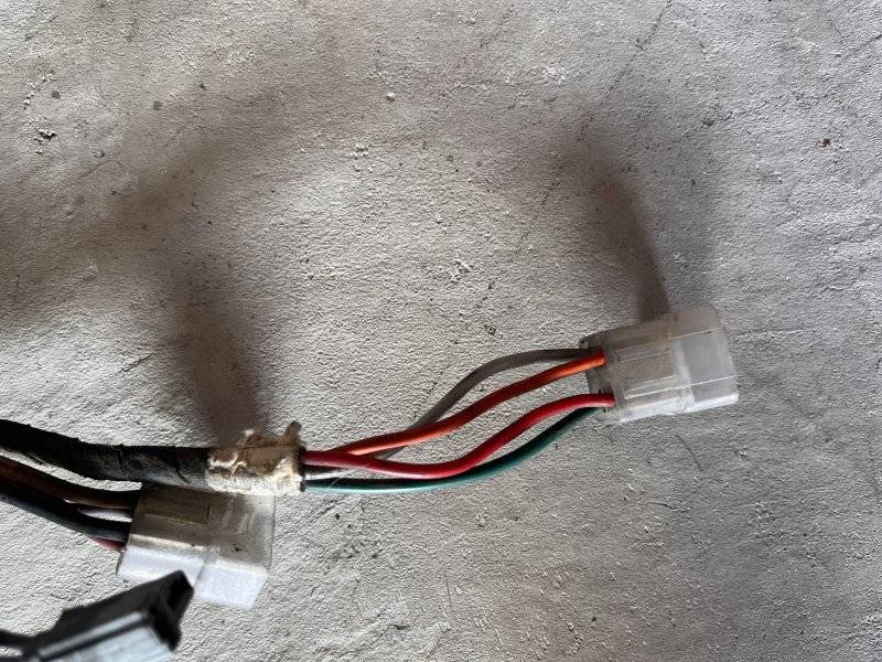

Do you still have the back cover for the wiring connector? If so I'm assuming the little lock tabs are gone? I use a couple tiny (2-56) screws & nuts to close the connector... It'll never give you another problem... It the cover is missing I grab another connector shell, they were used on many body styles for many years so they aren't that hard to find... And the screw trick will still work on good connectors making them more secure than they ever were when new...

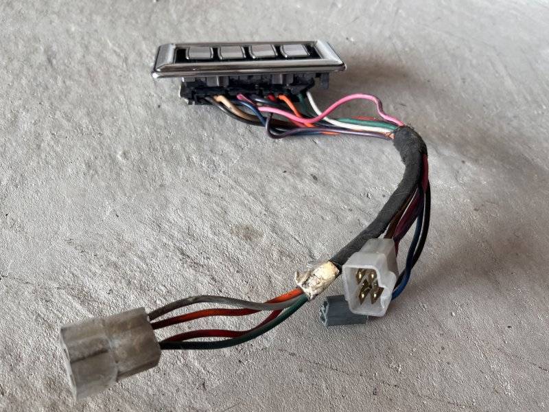

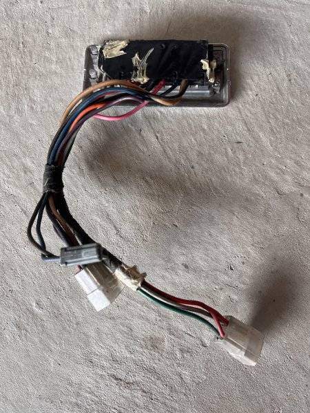

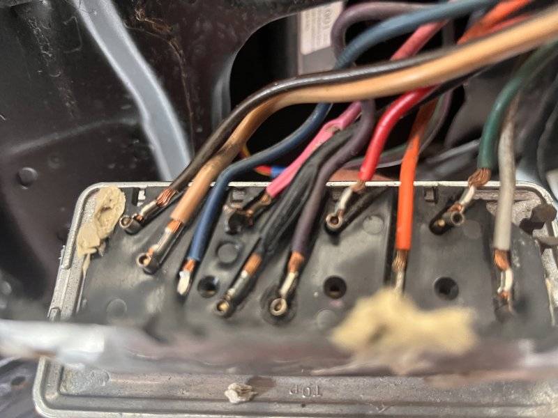

Thank you for those pics. That is what I was thinking it would be. I will now be able to build a harness since mine is missing.
