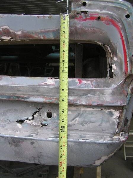

No problem. I am just thankful for those who want to help. I am pretty sure I am off. I just have to figure out how to fix this. As I see it I have two options. (A) cut it loose and move it up that 1/2. I really don't want to do this but....... (B) live with my mistake and bend the bumperetts so it will bolt up. But the bumperetts are contacting the lower valance so that might be a chore.
I guess there is another problem to leaving it where it is. The trunk lock support has not been welded in and it would have to be modified to fit better. And not sure that the bumper would look right.
Well, I've got the same measurement you have, 13 3/4". How accurate was this fit up from the factory?
I also have not tried to fit the bumper up yet.
QOTHL, It looks like that 13-3/4 is the magic number. I'll bet if you put your bumper on with the bumperetts it will look good.
It would be nice to get a couple more to check and see what they are getting.
Sorry, I reread your post and I have a 1/2" deeper measurement. Sorry, sometimes I'm tired and not paying attention.

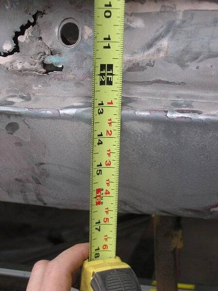

Don here is a couple more pics to confirm your measurments
Thanks, It looks like your tape reads about 13-3/4 right?
Any chance I could get another dimension?
From tail panel edge down to center of bolt hole. (just like in my pic)
