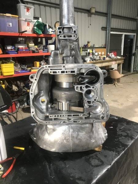

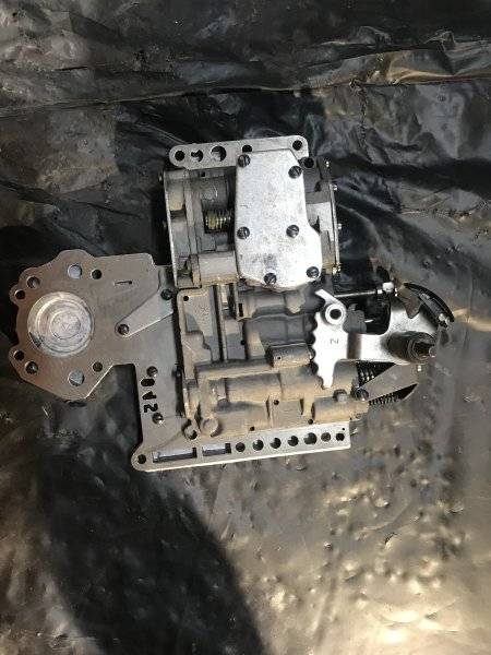

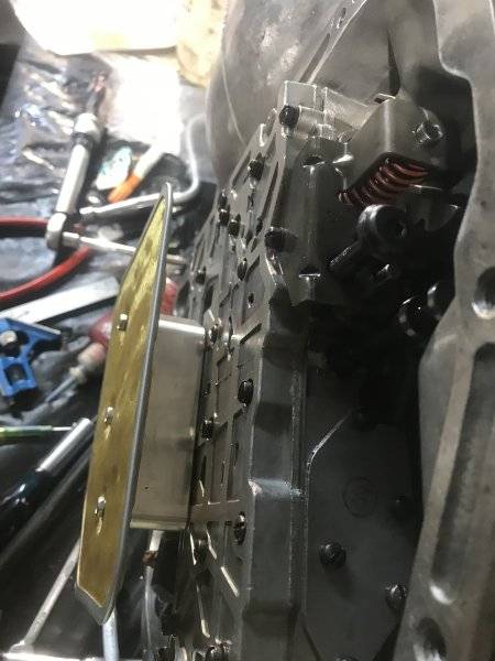

So I started assembling the transmission and got the shift kit installed. TF2. I got the transmission completely assembled on the weekend only to realise I made an error. I was looking through assembly photos and realised I hadn’t used any extra springs in the front drum like myself and the transmission guy had discussed. I had only 9 in there, where he recommendeds to use 15 and a different retainer. Think it’s a CRT piece. Anyway so I’ve had to disassemble and order more parts for it. On the plus side I know how to build one back the front because I had it all together and had to disassemble because I dropped the little E clip on the parking rod in there. Measure the end float and was within spec. So pretty happy with how the trans in going. Looking forward to it being together
I typically use either 10 or 12. Seldom used the 15. 12 is a good safe combo. Not sure what the TF 2 wants.
Maybe to do with the 4.2 kick down lever and billet servo? I don’t know. I will just build it as per the trans guys plans because I don’t have any idea haha
The 4.2 lever is a good choice. If your guy knows his stuff, go with it.
Well ive heard good things about his work so fingers crossed everything goes ok. Very helpful. Anytime i need something i just text him or call and he responds within 30 mins even on the weekend.

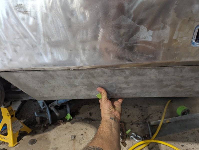

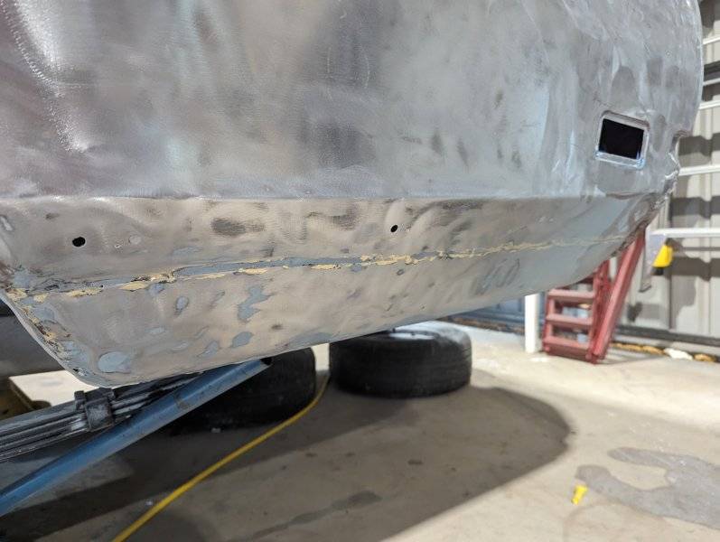

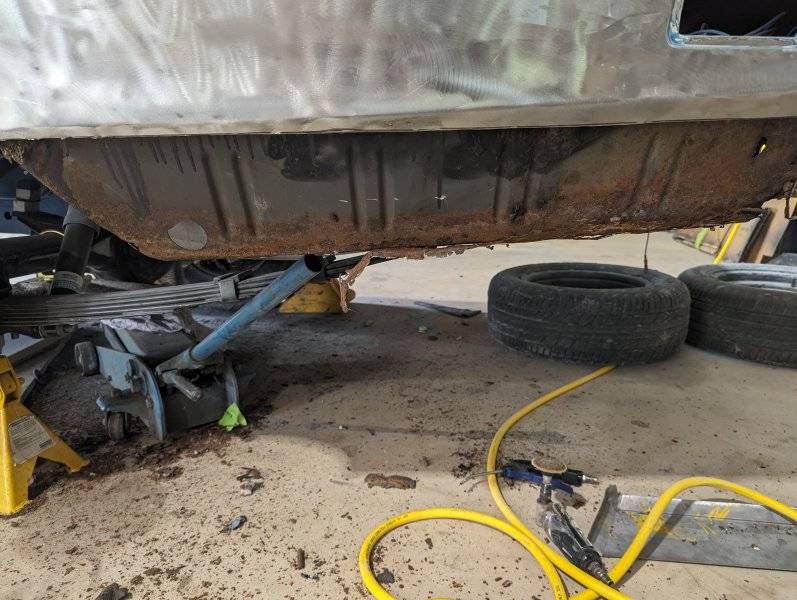

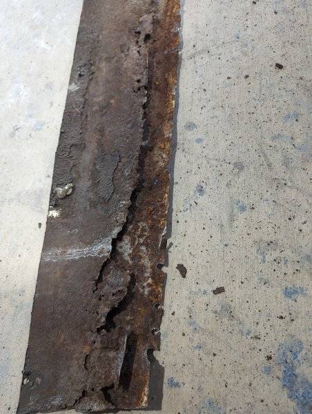

I've also started cutting out rust and previous shitty work on the body. The bludgers had just slapped a sheet of steel over the top of a rusted panel and brazed it on there. Anyway took it off to find more rust underneath.
Good thing you cut that brazed piece out. Fillers don't stick for long with braze underneath. Probably from the flux coating.
