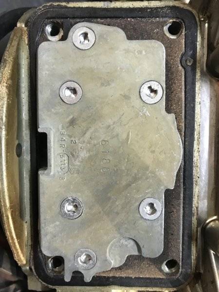

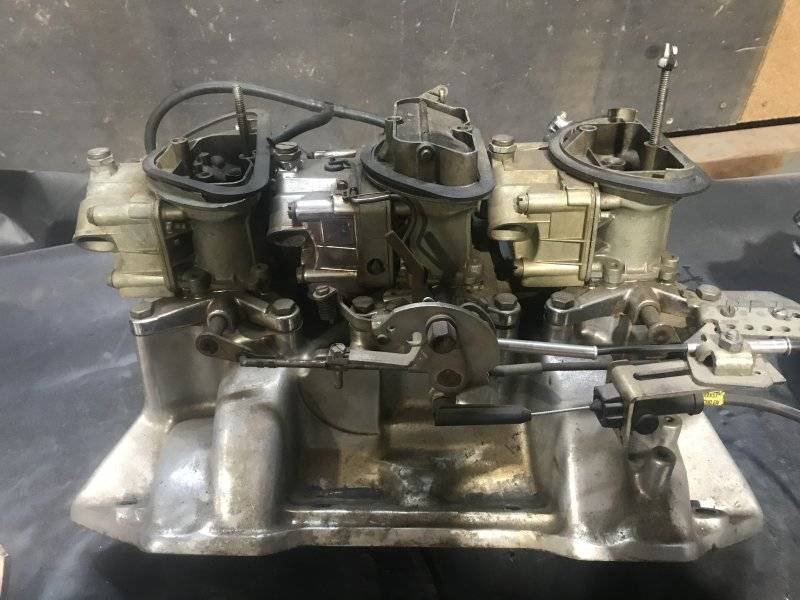

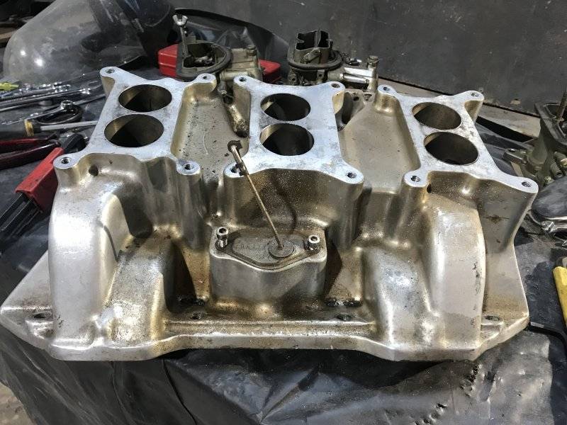

If the manifold is aluminum, it's either an original A12 or the EDE CH6. A very good manifold. The meter plates appear to be the '69 1/2, the '70 & later plates have different shape.

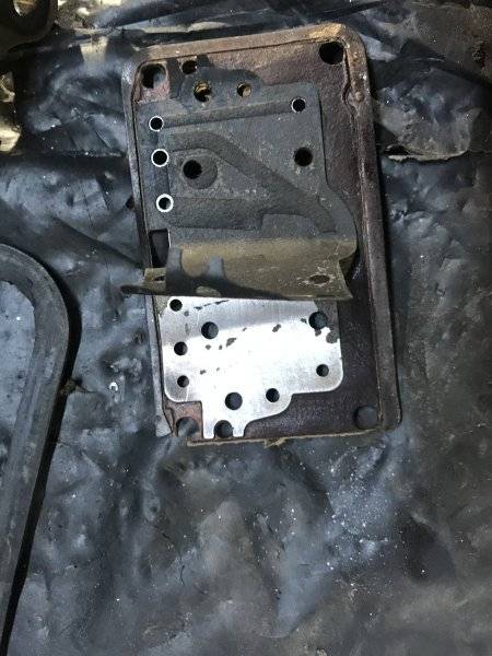

Yeah it’s aluminium but has no casting numbers or brand on it. So is the 69 1/2 plates not as good due to the modification? That thin plate is all bent up now. Not super bad but definitely not straight.
Photos of the intake.
So apparently some one ground off the numbers. My set off '70 carbs worked the best. Not sure why.

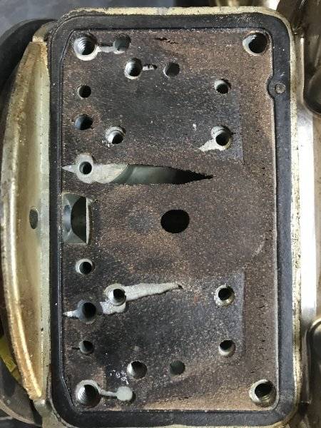

Looks like one of the contributing factors on the plates being stuck was the use of cork gaskets from a parts store rebuild kit and not a Holley. Hopefully the secondary bowls don't have the big nut stuck/stripped.
Why would anyone grind the numbers off? Well it fits in with the rest of the weird things I find on this car haha.
No idea why. But I know both the OEM A-12 manifold and EDE aftermarket version had casting numbers. I had both. Back in the day, I ground a lot of stuff off, but never off the intake.
Yeah maybe they just wanted it to look flush. Would have been nice to know what it was.
Yeah they are really stuck on there good. The only kit i could source locally isnt the 6 pack kit. its a holley fast 2300 kit, but it doesnt look like it comes with the secondary metering plate gasket. I have to try hunt that down now
Back in the day, was able to get the Holley 6 Pak kits. They had the different versions of the end carb meter plate gaskets. The meter plates were a separate purchase. I was lucky to have a Holley distributor warehouse about 20 miles away and had any part I wanted. The Holley 2300 kit that I got for my oddball modified 500 CFM center carb was not even close to the 6 Pak kit.
Check out the needle and seat units. If they are brass with a big jam nut, stay far away from it.
I did find some 6 pack kits, they werent cheap and the shipping killled it for me. Hopefully this kit i am gettting does the job otherwise this poor man will have to pay twice.

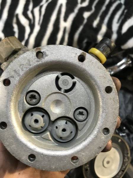

I’ve stripped my fuel pump to inspect the internals. Does anyone know the specs of this pump? I’ve tried searching the web but no luck.
Also when I took it apart a small foam block fell out. Where does that go?
Ive seen this pump online at summit, it doesnt have the same appearance as the one i have, well the inlet side at least. Is this style for the use with a vapour separator?

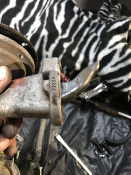

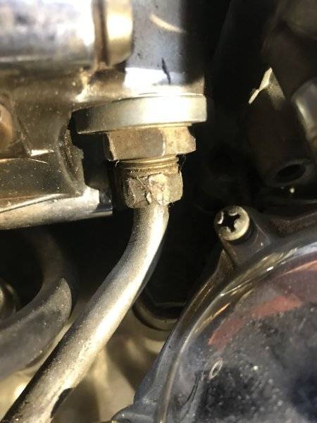

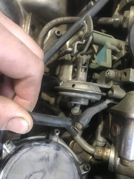

I have started the tear down on the carbs. I have found they had the secondary hose blocked off. Is that a common thing? The fuel nuts were all stripped so i will have to get new ones of those. The metering plate was stuck on there and to get it off it’s now bent. If I don’t go with promaxx are they pretty common to buy? Also can anyone ID the intake. There are no markings
If you hose those down with carb cleaner and let it soak in, those plates will peel right off.
Nice. I will do that tonight.
Any advice to bring that aluminium manifold to look a lot better?
It looks like it was sanded and polished, possibly? I've used acid to brighten cast iron before, but not sure on yours.
