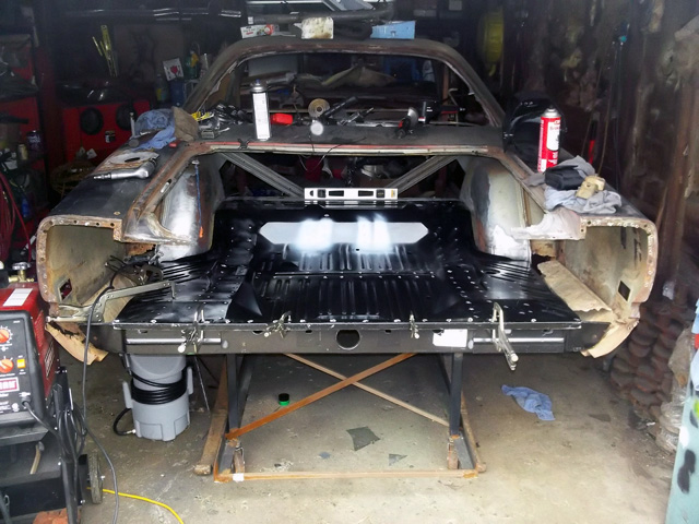

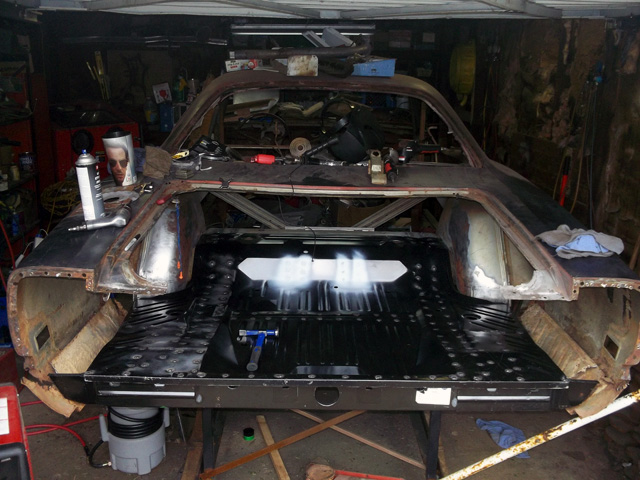

Today's a red letter day in history. I got my trunk welded in. :hello2::hello2::hello2::hello2: Tomorrow I install the flux capacitor. It only requires 1.21 Gigawatts to power it.

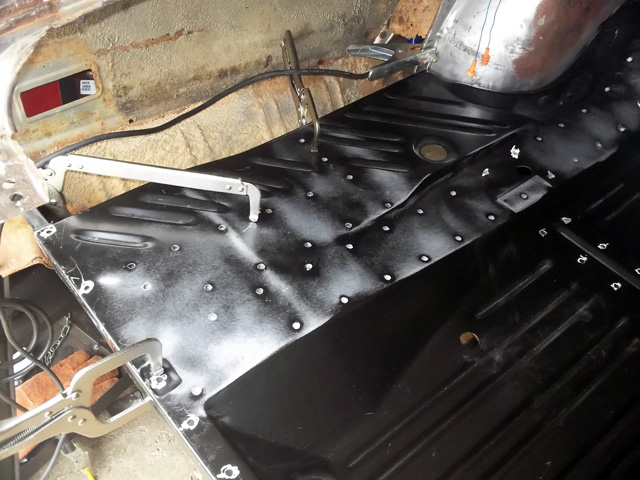

Here it is after the holes were drilled and it was aligned.

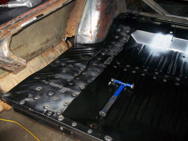

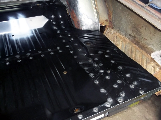

And then after a marathon of plug welds.
Tomorrow starts the all day process of grinding the welds flat. I actually have a sunburn on my right arm from all the welding today. LOL Who needs a tanning booth! After that I'll weld the inner fender wells to the floor and start bracing. Once I resave the money, I'll get the package tray from moparmark and start on that.
