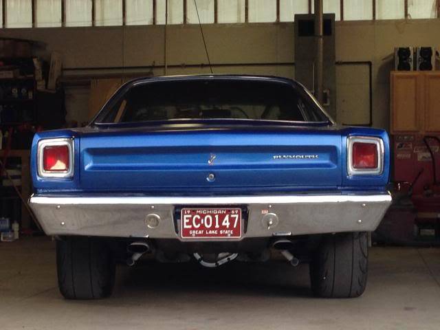

those have more room than my roadrunner. i have a 325-50-15 on a 15*8 4.5 back space. wheel lips are rolled. dana 60
Whoooaaaa!!! Really!?!? I couldn't even stuff just the 325 tire in the wheel well. Crunched between leaf spring and non rolled fender.
