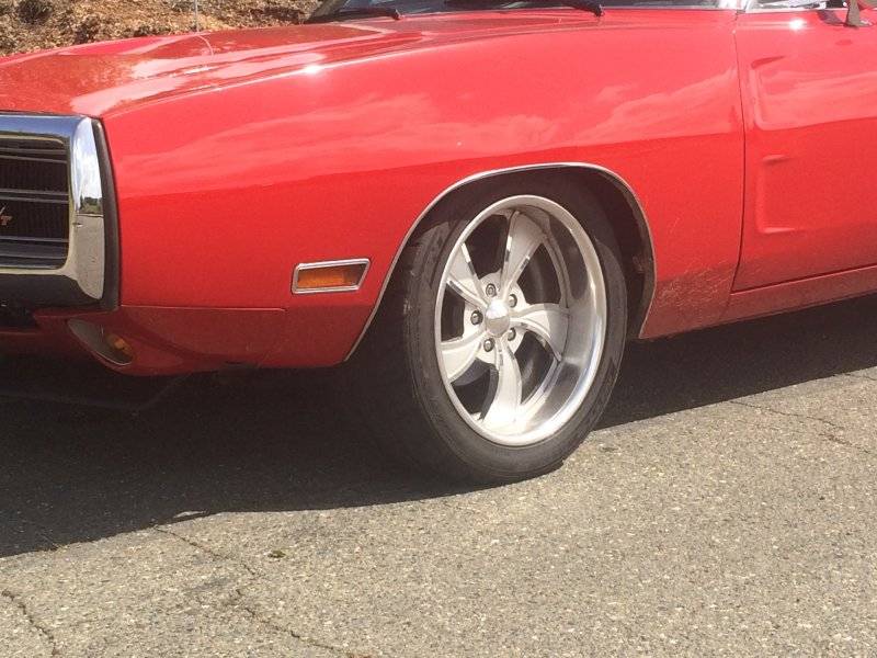

Granted, these are 18” wheels, the width is actually wider given that these are aluminum wheels. I could measure “front spacing” to see how much wheel and tire sit out from the mounting face.

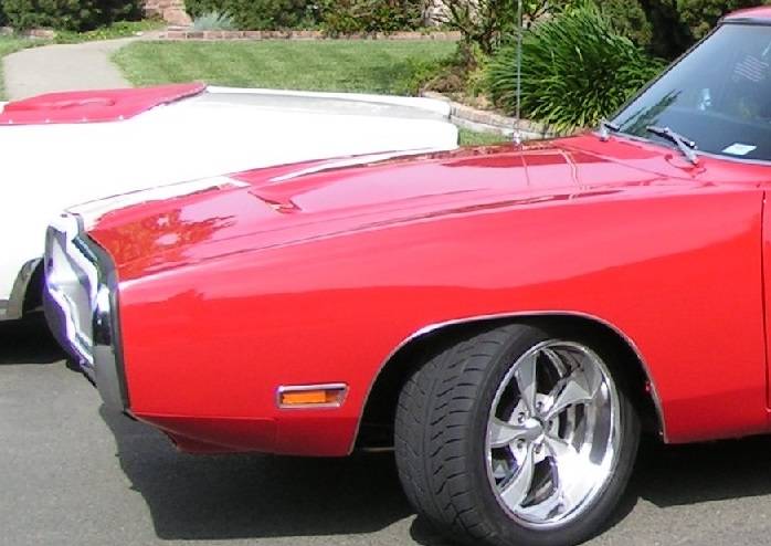

18 x 9" wheel, 275-40-18 tire:
