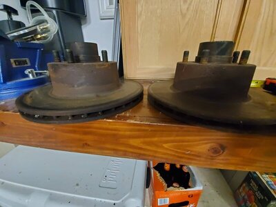

So I picked these up at Spring Fling and I am trying to figure out if these are the correct parts for doing the swap. Some, but not all the measurements match what is called out in the DISC-O-TECH article. Spindle measurements match except the diameter of the shaft. Rotors come out at 11 1/8, which doesn't match any measurements. I'm starting to get frustrated and wondering if I wasted money getting these instead of just buying a kit. Any help is appreciated.

" diameter of the shaft " It's my understanding the diameter of the spindle, near it's base, is the kicker. Apparently the early disc spindles used a smaller diameter inner wheel bearing and obtaining stock rotors for those is difficult. Do you know what these rotors and spindles came on originally, especially year model? Were they assembled when you bought them, or did you buy spindles and rotors from different vendors? Pull your inner (larger) bearing out and see if it fits your spindle. I intend to do the same swap on my 69 bee. Also you need to be aware (providing everything checks out and fits) the caliper will hit rhe sway bar if you mount it on the front like they came from the factory (disc brake cars). The solotion is to swap the spindles side to side, then deal with obtaining brake hoses that fit (do-able). Don't be discouraged, it's been done lots. jess in ky
The bigger inner bearing came out in I think 1973 or maybe 74 B and E bodies . Not sure about any other models, but I would assume same years
I don't know what they came off off, I was just told they were from a B Body. They weren't assembled when I bought them, just all in a box together. I bought it all together as a set: spindles, rotors, dust shields, calipers (four piston) and all the hardware. The rotors have all the bearings in them and they fit properly on the spindles. The Disc-o-tech article says the spindle diameter should be 1 /38 (1.375), and mine are measuring out at 1.250.
Starting to sound more and more like I wasted money on these "wrong" parts :BangHead:
4 piston is older b. You can sell that stuff to someone wanting to do restoration type upgrades keeping it looking correct for the period. Not necessarily wasting money, just postponing what you need. Get ahold of the b-body upgrade book from AndyF @ arengineering.com,amazon or from Mancini.
Well dam. That's what I get for jumping the gun and not doing all my research first. Guess I should have just stuck with my original plan of buying an aftermarket kit, since that is where I am at now anyways. Chalk it up to a learning experience and move on. See if I can maybe sell this stuff to recoup some of what I paid for it.
Do some research. Those pieces you got may have some big value to those in the numbers matching/perfection circle.
