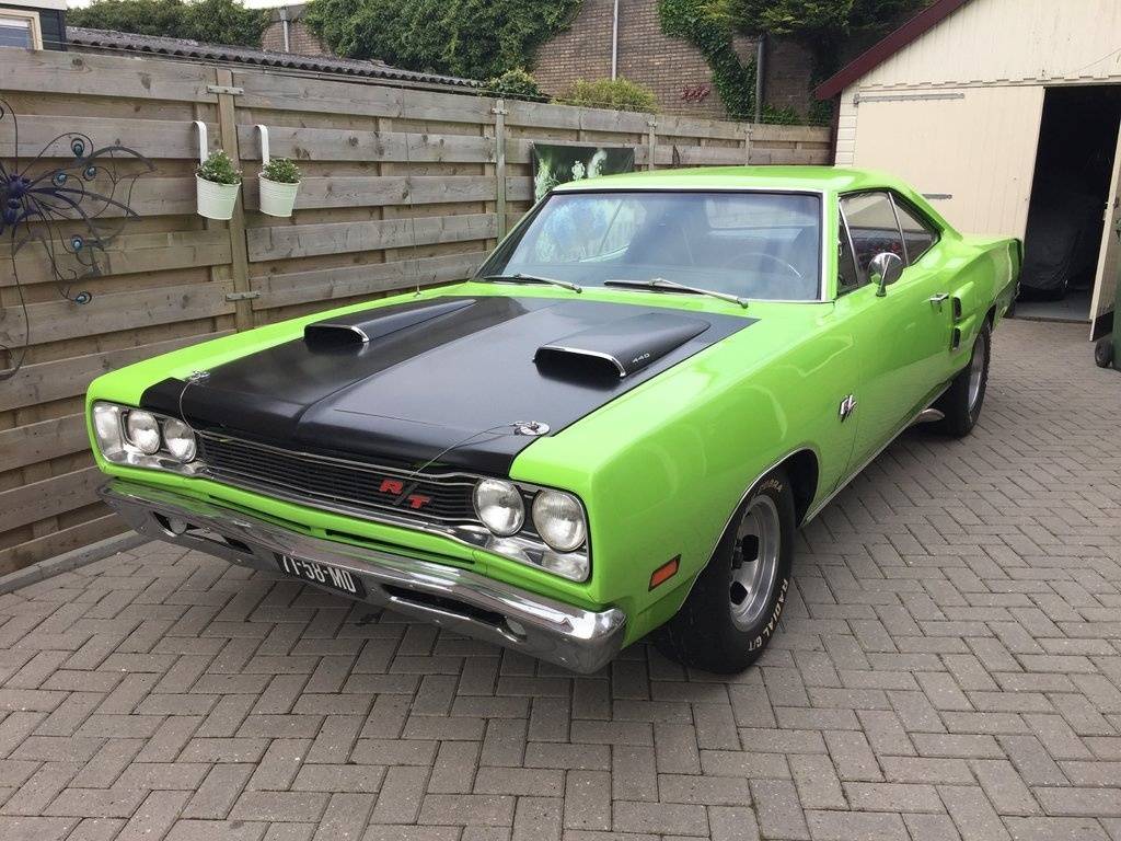

Hello all,
I am looking in to doing up my chrome of the grille and around the head lights, but what is this?
Is this chromed or stainless steel?
I don't want to start rubbing with stainless steel polish and find a nice coat of copper after i am done.
Anodized aluminum that has been brite dipped.
Nice Car
See if a magnet will stick to it.
If not then it's probably stainless

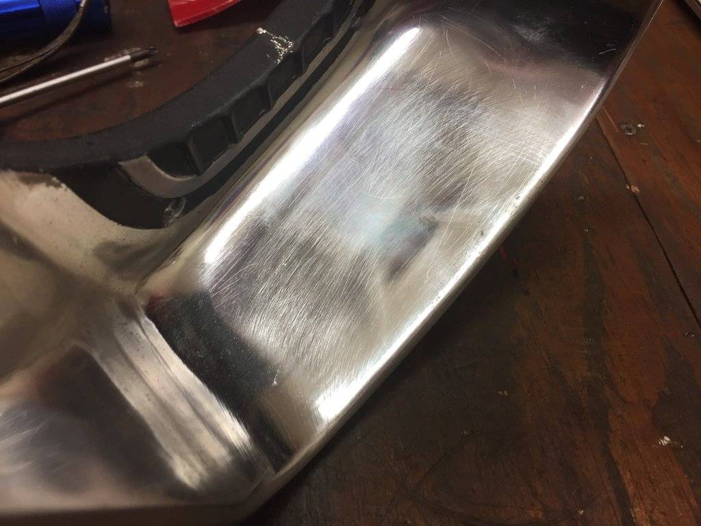

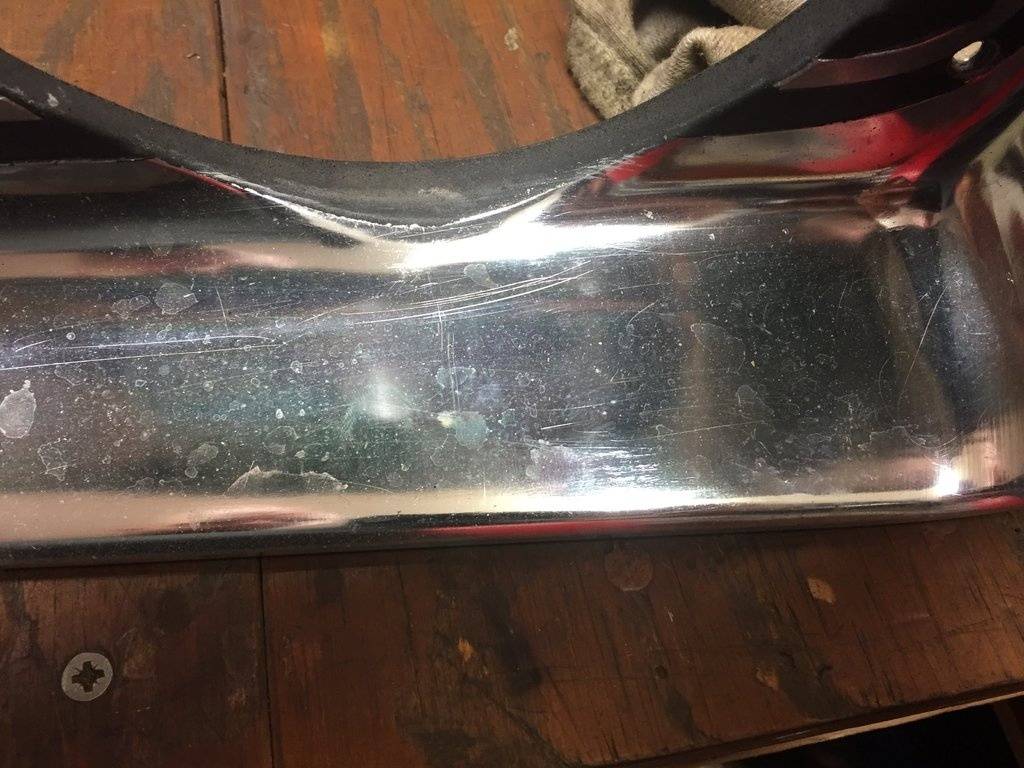

See pictures of the fine scratches in the surface.
I will need to polish it quite hard to remove it so i am afraid i will remove the chrome...or whatever it is.

You cut through the anodizing already. You can't polish that out. It would have to be completely stripped, polished, dipped then anodized. Those spots can be covered if they were painted correctly with silver argent paint.
X2 has to be redone.....

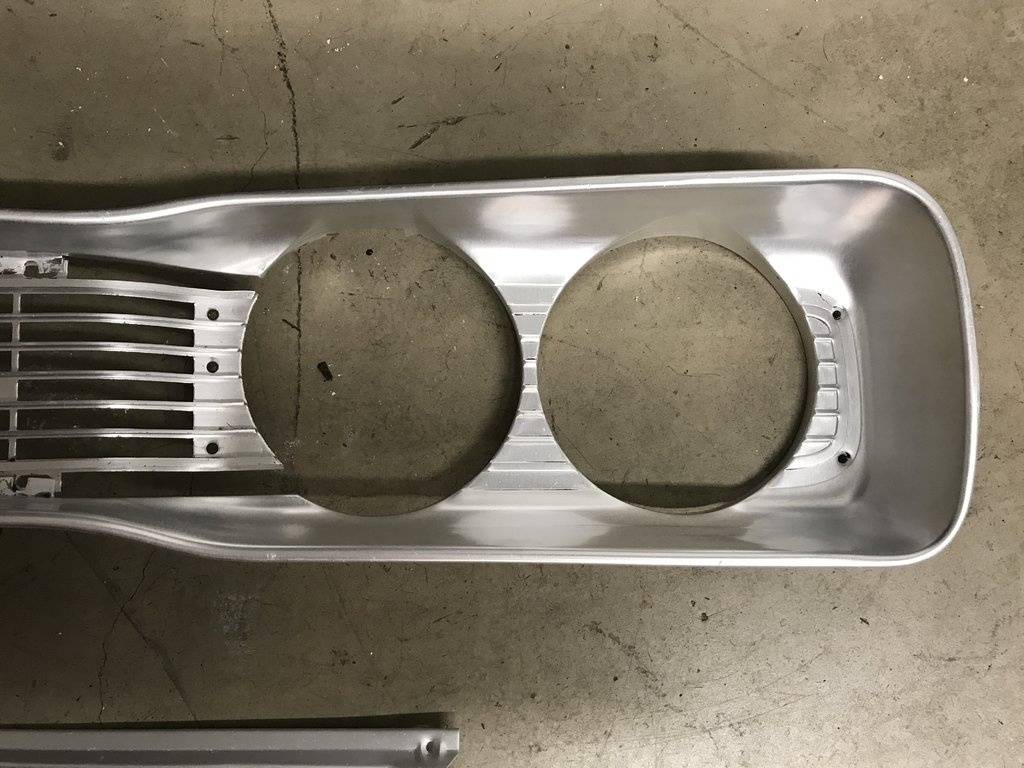

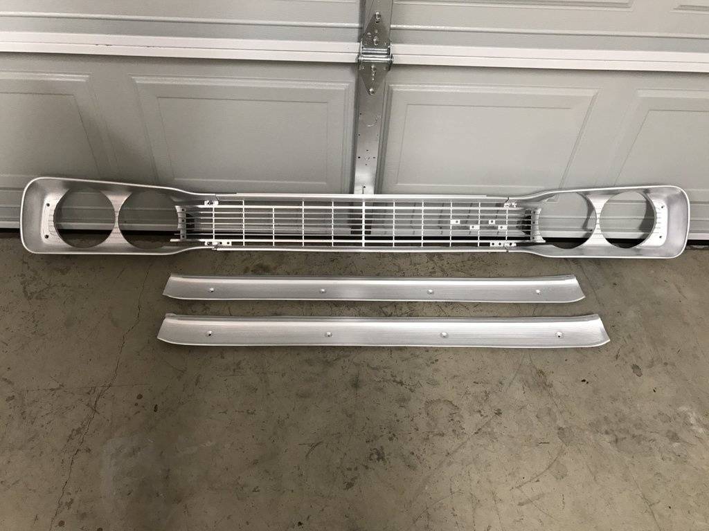

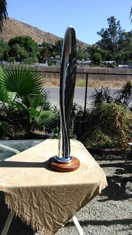

Here is what it looks like with the anodizing stripped off. We're working on the same thing. I took mine to a plateing company near me. I'll polish them, then send them off to get replated. Not bad for $20.
If it was me, bc i don't care about purism, i'd have it chemically stripped & have a reputable polishing house sand & polish them ultra brite & leave the natural finish. Anodizing, even clear powder coating will step down the glow. Nothing prettier than natural polished alloy.
Beautiful work. Wish you were closer, I'd have ya do all my stainless trim.
Thanks Texas! I was born in San AnTone. Stainless is tough but fun cuz one can be more aggressive with it & the right effort produces Brilliant results. Again, far prettier than chrome & other platings/coatings imo.
I just did one section up with some stainless steel polish, which cleans it up and makes it shine quite nice.
Scratches can still be seen but it looks better then before.
