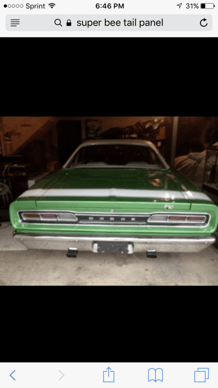

Guess that why the PO blacked out the complete tail panel on my car as it will be harder to get that back to original state.

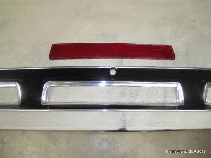

If you take it somewhere to have anodizing removed, all paint has to be removed first. Paint can be removed with a can of lacquer thinner and a roll of towels. After anodizing is removed, then you can polish the aluminum. Your tailpanel should look like this for a Bee.
View attachment 513920 If you take it somewhere to have anodizing removed, all paint has to be removed first. Paint can be removed with a can of lacquer thinner and a roll of towels. After anodizing is removed, then you can polish the aluminum. Your tailpanel should look like this for a Bee.
Toluene is good for stripping paint also, the solvents are hot, penetrate like lacquer thinner, acetone, mek but does not evaporate as quick.
