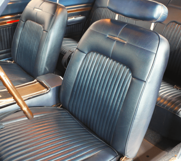

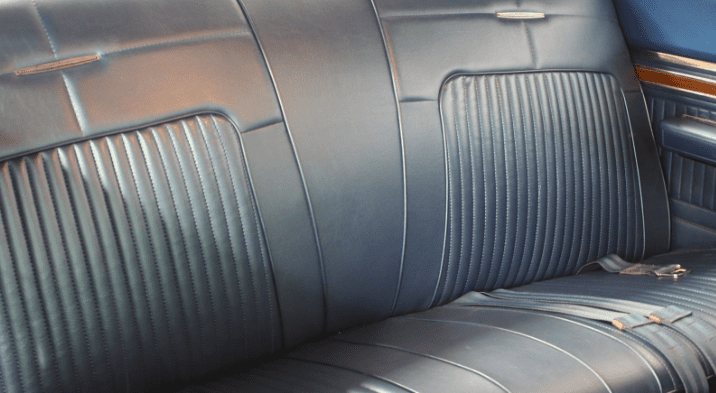

Now I know the front seats have a medallion, but does the rear seat also had these?
I have seen some pictures with and some without the medallions on the rear bench?

Loud and clear! I need to sets of these medallions then.

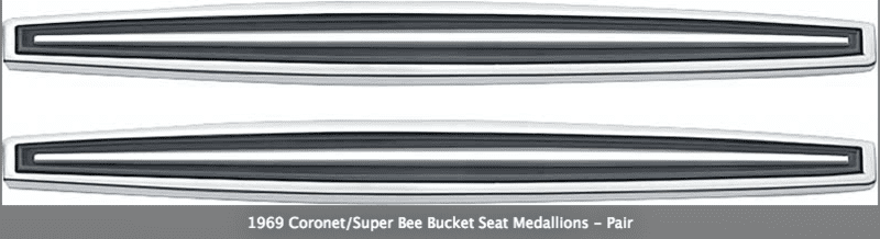

What medallions in front seats?
These
Nice. Thanks. As an owner I should have know that.

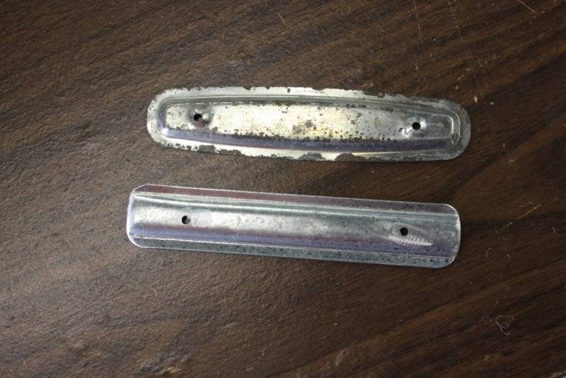

The backing plate that holds the emblem in is not reproduced. If you do not use it and just clip them to the seat, yes, you will have a "branding" moment as they will protrude from the seat.
Below is a picture of an original and a fabricated one.
D
Damn, never thought of what is actually holding it in place..
Indeed will need to fabricate something similar, i can see the use of these backing plates how they will pull the medallion "in" the seat.
