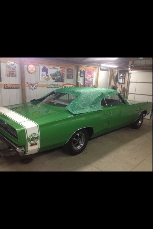

He thinks this car could be one of the very rare 1969 Mod Top Dodge Super Bee hardtops. When he got the car it had a black top, but a few years later when he started prepping it for a repaint, he pulled that black top off and found some strange material along the edges. He started researching it and found that there were 28 mod top Super Bees made in '69 and there's very few of those still around. From everything I've found, the mod top code would have been a "V1H", this tag has a "1H" code, but these Lynch Rd tags are pretty strange so I was hoping to get someone who REALLY knows to take a look at it.

I would say yes. The v is rather redundant. Anything in that position would start with V. Its the other number and letter that are important. The car is the right color. And there were remnants of an old top found.

That's what I thought as well. I just wanted to get other opinions. I checked out that site and they had some info but nothing about the LR code. I did see that he gives reference to a company that (at least in 2008) had the vinyl material necessary to re-cover the top. I'm passing that on to the owner because he was under the impression that he might not ever be able to put the top back on the car and return it to the original configuration.
Very interesting find, love the car regardless of what color the top was. What kind of shape is the car in?
He had the car taken to bare metal and repainted the original green, then some reassembly started, but the restoration stalled because he didn't know what to do about the top.
I'm hoping we can find that material and put the car back to original, as it should be, since I believe it's probably one of the rarest Super Bee's out there. It's going to be a BEAUTIFUL car.
