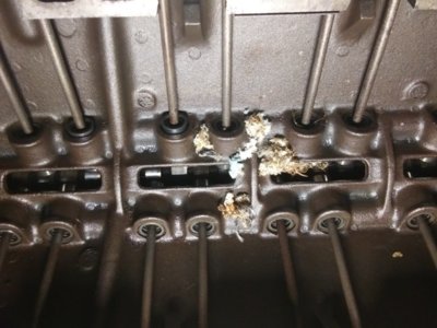

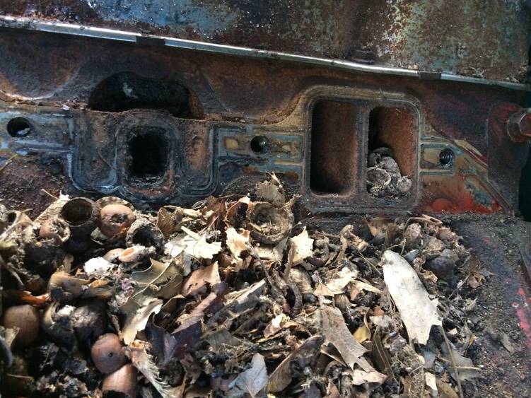

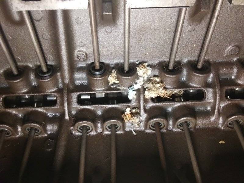

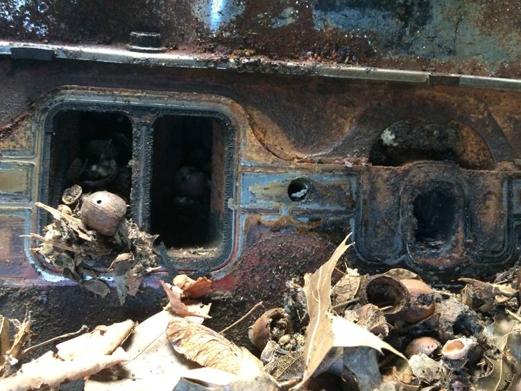

Well the reason the motor wouldnt spin all the way was acorns in some cylinders! Cleaned them out and sprayed everything with PB blaster. Spins great now. Do you think it would be OK to try and start it?

IMO, Change oil & filter then prime the system verifying you have oil pressure on a mechanical gauge. Then do a compression test.
uh, I would at least remove heads, and check them over and clean any remaining debrie and look at what you got, since your half way there already. but to each there own, could fire right up.,
From your photos I can't see what you have to lose. Fire it up! Is the exhaust plugged up too?
Mike
I thought about pulling the heads, but a full rebuild is in the near future so Im going to oil it up and give it a rip!
Just know that if that crap gets in the bearings you may score up the crank..
X2... Looks like a lot of crap. Probably rust from rodent piss too. Why take a chance on screwing something up if its coming out for a rebuild anyway?

I'd pull the heads to check the bores. You don't want to score them.
Picked up an endoscope. Going to take a look in each cylinder first
Holy crap! That's a lot of acorns! I found mice remains when I pulled the intake and it was on a stand in a shop. Those little bastards get everywhere!
Yeah, I'd probably drop the oil pan and check it before starting that. I had debris block the pick up once.
