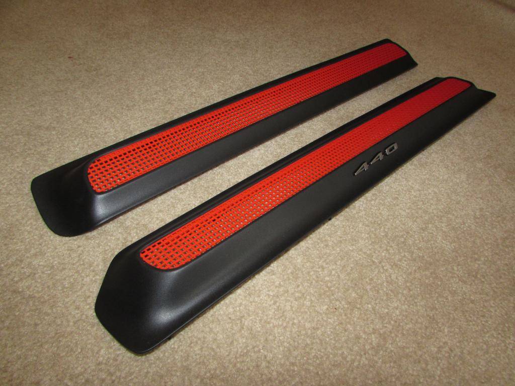

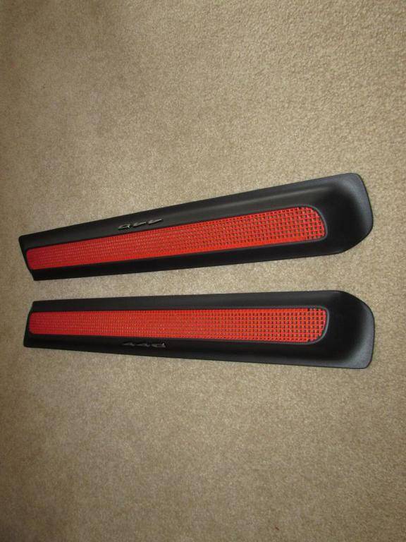

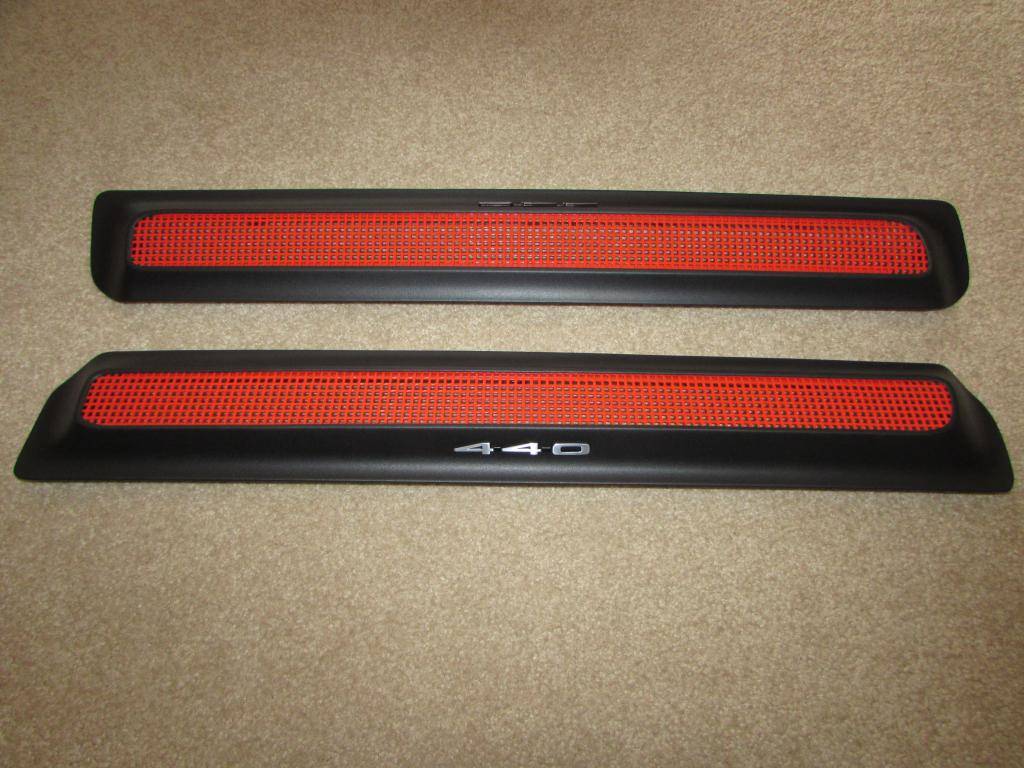

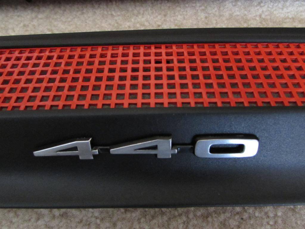

Hood scoops, engine size emblems, and air grabber screens all repainted and installed.
I'm almost wondering if it's a hood stripe thing. Orange screens with stripes and black without (AG only).
Nice job on the inserts!
Could be. But then again, I heard of hemi cars with the black out stripes with black screens. Then I have also heard that St. Louis cars came with flat screens with another plant had the woven screens.

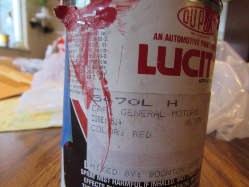

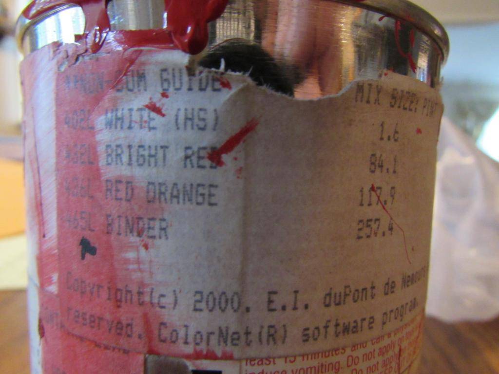

It was a version of R4 red paint. R4 for my 1969 Charger was called Bright Red but was known as other names such as Ralley Red. The touch up paint I had on the label had a GM paint code (which I imagine was shared at one time with Chrysler). The paint can is at my Dads house and I can try and post a picture or the paint code for it the next time I am at his house, which should be early this coming week. The downfall with this paint that I used is that it is Dupont Lucite which is no longer made. The paint code could still be the same, however, I have been finding that some paint companies no longer are making certain additives or colors for paints. I ran into this issue when I was trying to repaint the T7 door frame color for Dad's GTX. Dupont no longer made that color paint, yet PPG did.
