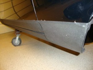

Bump. Got lower rockers holes welded and rockers sanded if any one can take a quick measurement would be greatly appreciated. Dont want to sand above body line until I know. Want it to look right Thanks!
The trim follows the body line and the 1/4" reflective (red or white) stripe goes 1/4" below that. Remember when drilling holes for the side emblem, they are not in the same location on both sides. One is farther back than the other.

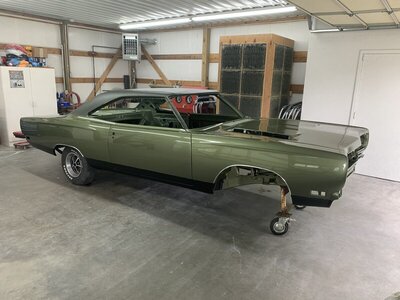

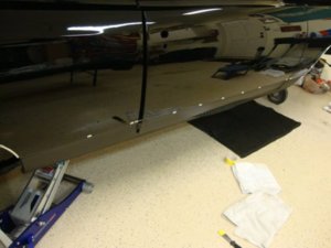

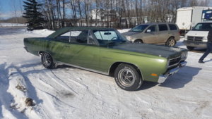

Looking at different pics its seems to be above the line not on it. Look at member moparnation74s resto (see pics below) It is well above, if you put the trim directly above the line it is too long. There has to be a space. Distance between the hole and the line
My car is currently in paint jail, but am going to check on progress on Sunday. The holes are above the body line, but IIRC, the bottom of the trim is right on the body line. I will measure distance from the center of the hole down to the body line and let you know.

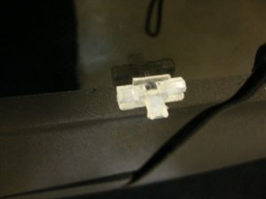

Does anyone know a vendor that currently carries the side moulding clips? It looks like there are two different clip types used along with teh acorn nuts. THanks -Jake
I bought the set from R/T Specialty. Have not installed them yet but expect to very shortly.
