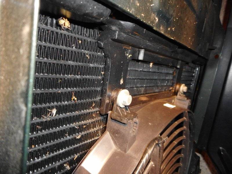

I have the stock belts and pulleys - mounted a 16 inch pusher fan on the front of the stock 22 inch radiator. Not enough room behind the radiator even with stock pulleys. With no fan or shroud makes it much easier to change the oil filter and work on the front of the engine.
Made two brackets to attach fan to the radiator mounting bits of metal. The fan sits off the radiator core about 2 mm.
The way I did it you can remove/install the radiator with the fan mounted to it.
Cools fine.
