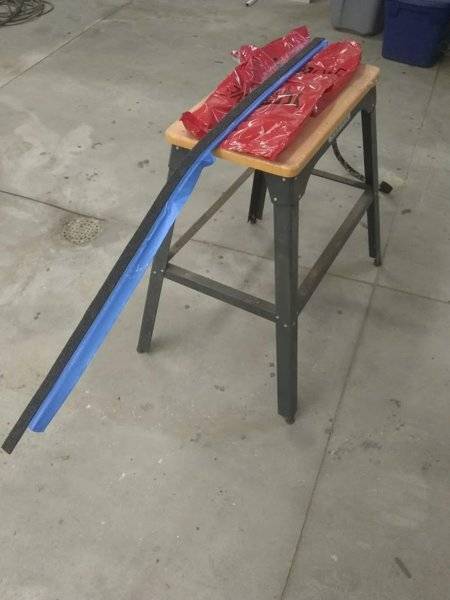

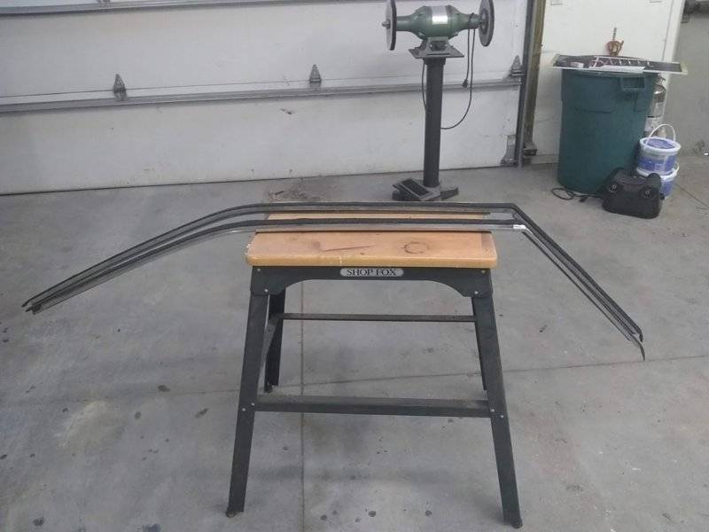

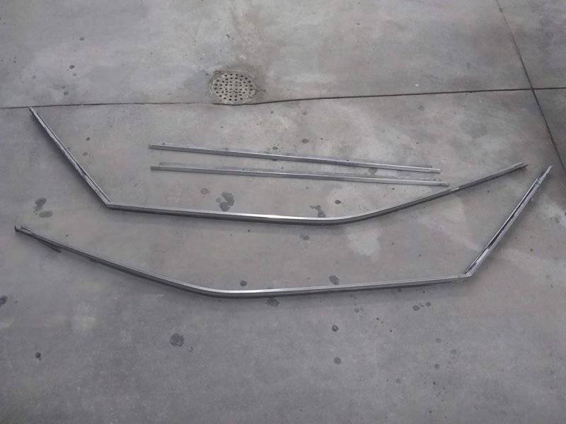

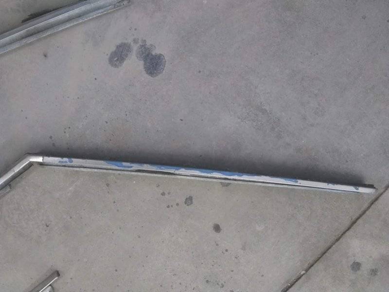

So I did get a little time in 2 weeks ago. Dug around till I found my roof rail trim.
Notice the paint from the last paint job! I buffed it all up and cleaned the surface for the foam seal.
Applied 3M spray adhesive to both surfaces and applied the foam. Now I just need to figure out the correct screw to attach them.

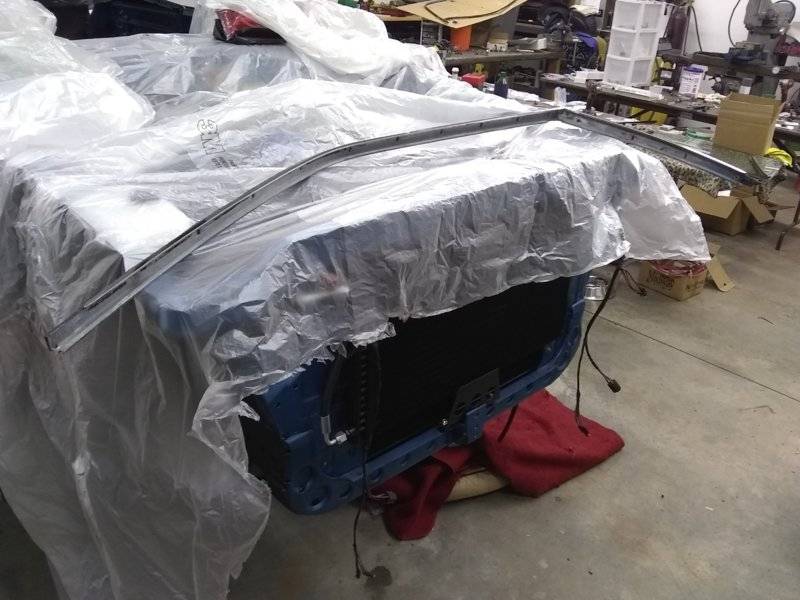

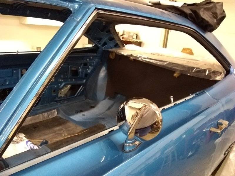

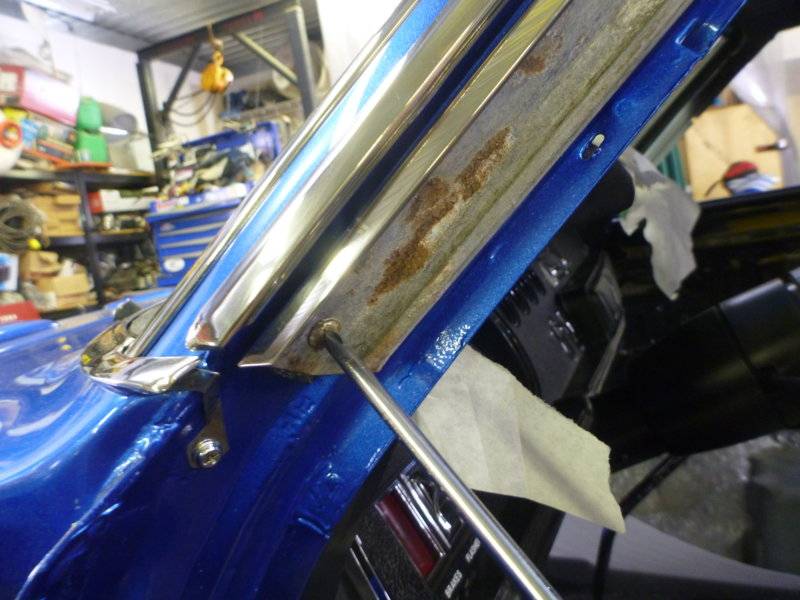

So I got a little garage time on the X. I got the roof rail trim installed.
I first installed the trim with all the screws loose, then started at the top of the wingvent and worked both ways tightening the screws. I had a couple on both sides that didn't want to pull down so had to use a larger screw.

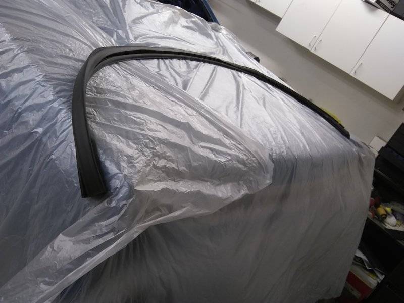

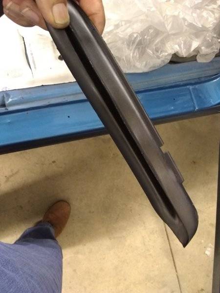

I had laid the seals out for a week to get the curl from packing out of them. Instructions say to glue these in. I didn't for now, just in case I have to pull them off later for something. The seal has a notch (picture) that fits the bottom front of trim. I was able to put them in ok with my fingers and a popsicle stick.

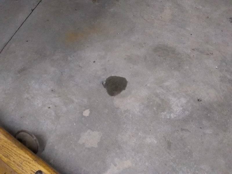

And well there was this!
At some point I think I have a drip from either the PS hose/ cooler. I wiped everything off and I will see if I can locate where the leak is! I'm sure it's probably those darn spring clamps and new hose.
