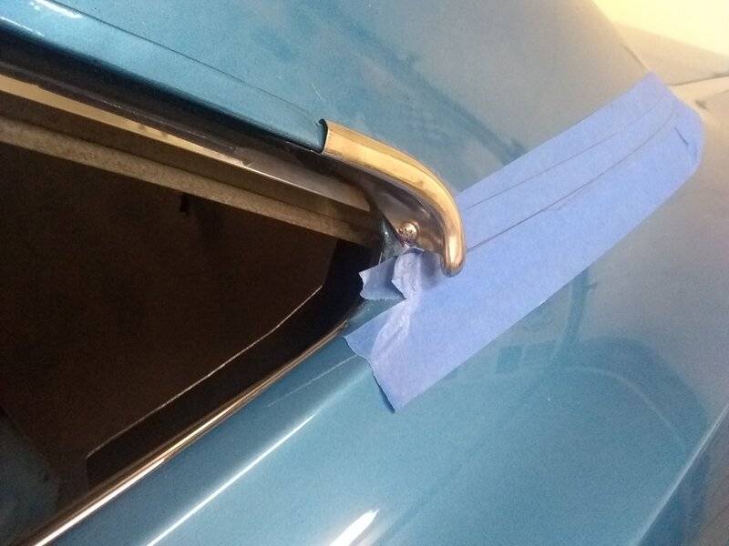

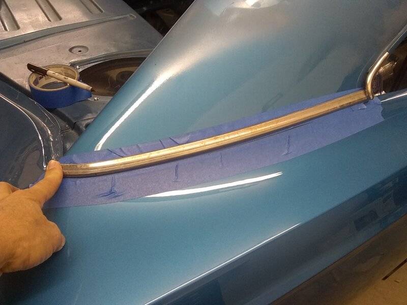

Trim located. Going to get holes drilled. I thought I saw once there were 3 clips for the trim & 2 fasteners to hold the vinyl. Can anyone confirm that?

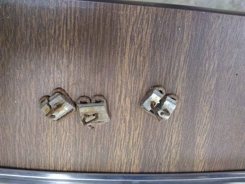

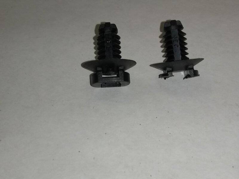

so a little more work today on the X. I found the clips for the rear 1/4 trim. But they don't fit the correct trim. I checked with Richard and he didn't think they were available as a repop. Hmmm so rather than try and track some down I thought I'd take a shot at making something.
So I found some fir trees from some zip ties. I sanded down the head so it would fit snug
I think this will work. BTW I had one Dodge pc & one Plymouth pc. The Dodge pc is just a little wider and the clips wouldn't fit in trim. Unless someone has 6 good ones I'm going this route.

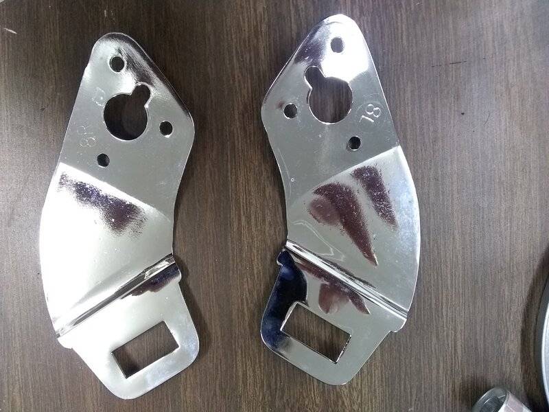

Installed seatbelt clips, visor rods, dome light base. Getting closer to having everything ready for Mark @ Day Apoulstry. Still need to scuff top, install the teeth I got today, and clean up bows.

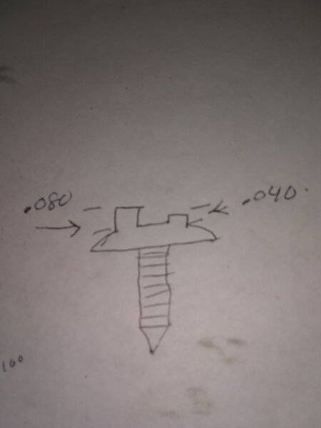

my GTX roof and upper quarters are untouched....... the 2 small holes were small phillips head screws holding down the edge of the vinyl.......prayers for the pooch
eldub, thanks for the picture. If I might ask what size hole/screw? Looks like maybe a #6, .12 hole?
