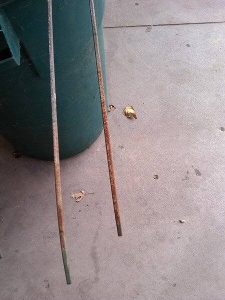

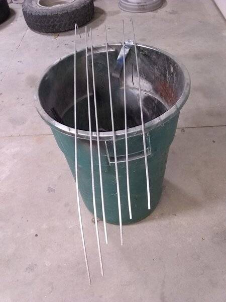

Had a few minutes yesterday, and as warm as it was I thought I'd sand the rust/scale off the headliner bows and paint them.

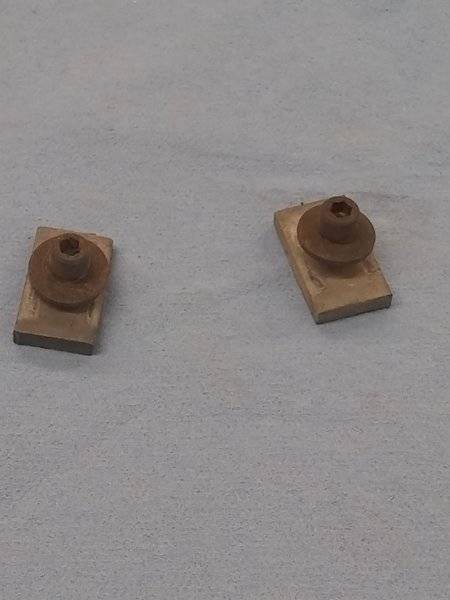

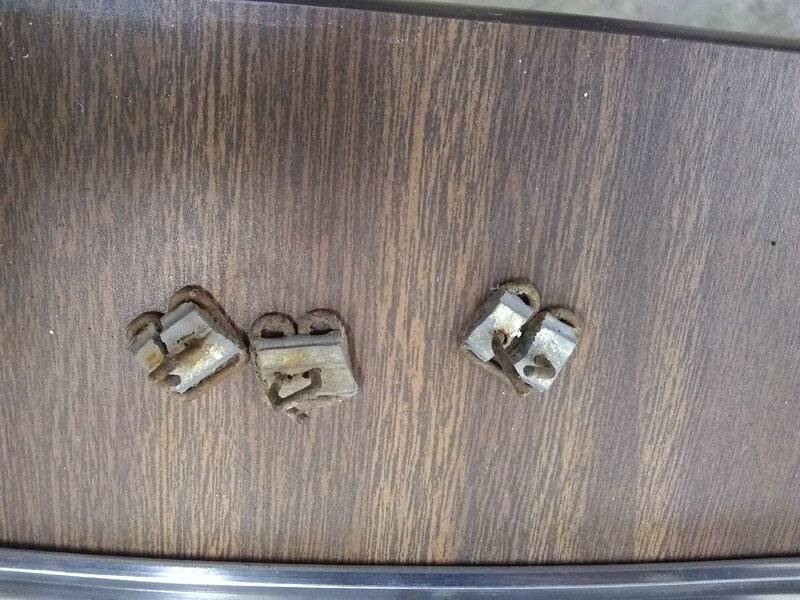

View attachment 1020300 so a little more work today on the X. I found the clips for the rear 1/4 trim. But they don't fit the correct trim. I checked with Richard and he didn't think they were available as a repop. Hmmm so rather than try and track some down I thought I'd take a shot at making something.
I needed some of those also and got some from some guy here that sells a lot of hard to find stuff. I can't remember who it was tho. Do you still need them? If so I'll look thru my receipts.
Kid if you wouldn't mind looking, yes please.

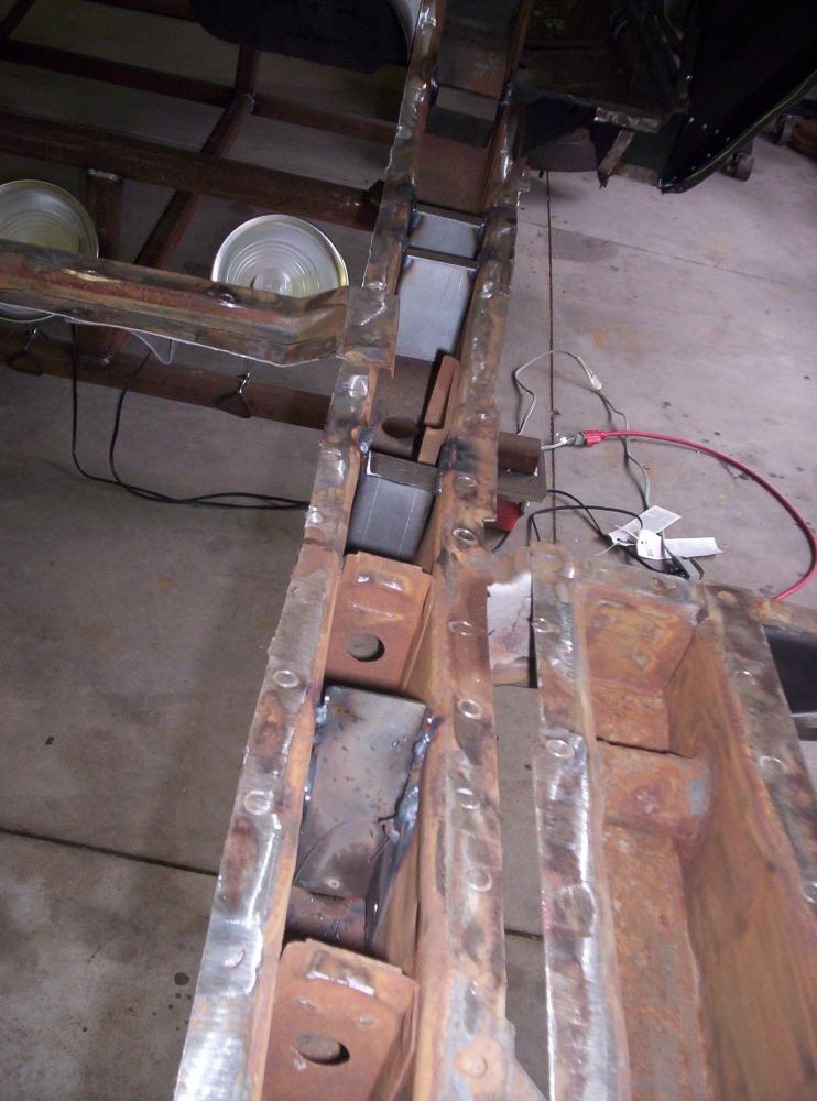

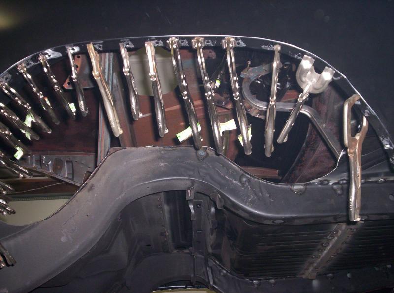

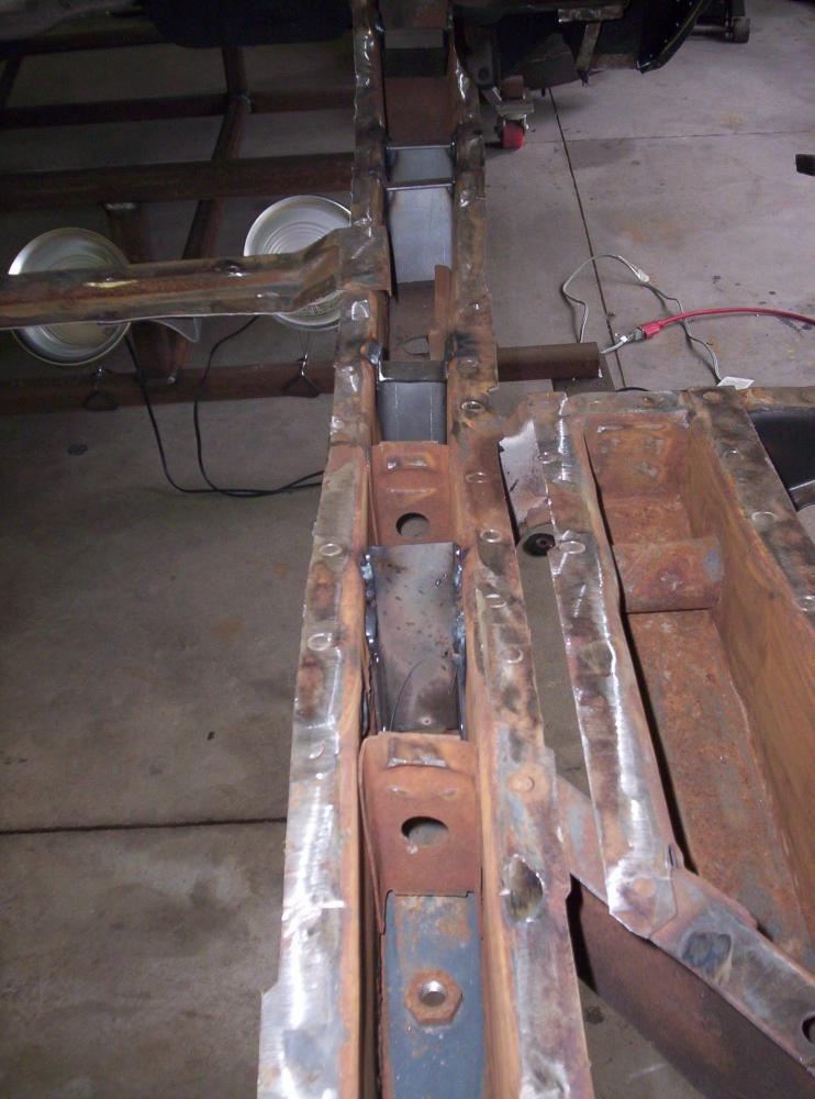

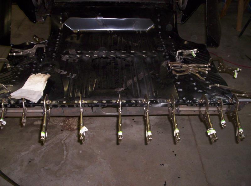

So after a hard week I got about 90% of what I wanted done! So I'll kinda breeze through here a little. First I found on my car it was easier to hang the 1/4s in place and work backwards to we tubs, trunk floor trunk ext.'s, tail light panel. It was just easier to get everything to mate up. So I mocked everything up, checked my gaps, body lines, window opening, and for level then put sheetmetal screws in for referance to reassemble. Once apart again I put my frame rail gussets in (see above) then POR 15 them.
View attachment 198040View attachment 198041

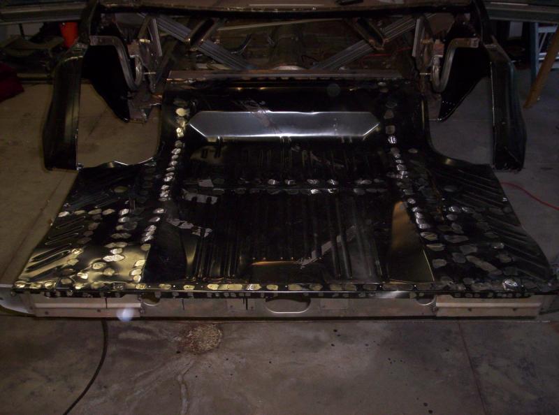

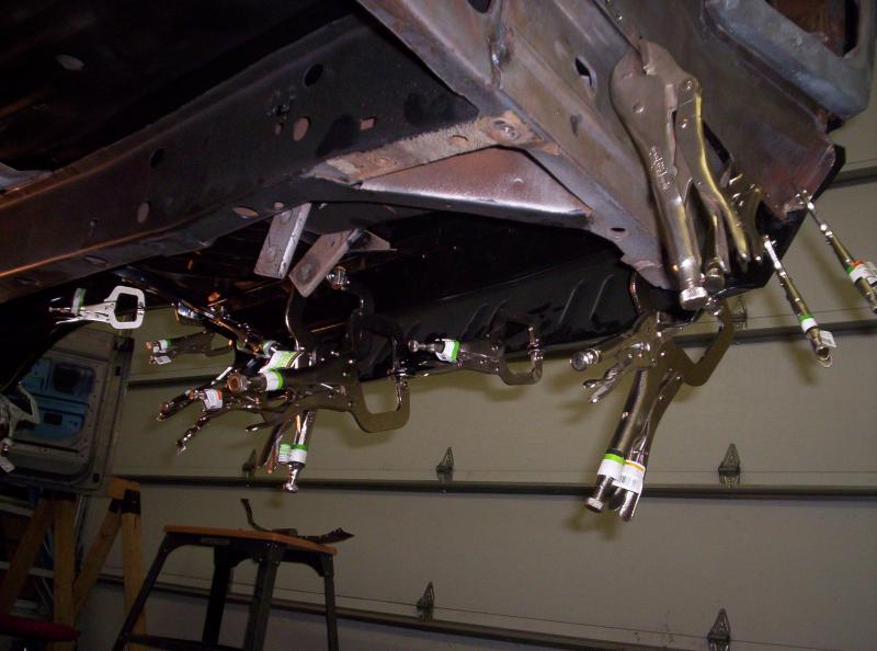

Screwed the trunk floor back on and started plugging the 188 holes I just drilled in it, then sanded smooth with a flapper wheel on the grinder. Note here, I bought 2 of the cheap harbor frieght grinders on sale for 10$ a piece and have a cut off wheel and a flapper wheel on them, plus my good one with the grining wheel so I'm not constantly changing out the wheels! Speaking of Harbor frieght also bought 20 vise grips on sale for 3.99, SCORE!!!!
Next I moved to the outer wheel tubs and did the same with them.

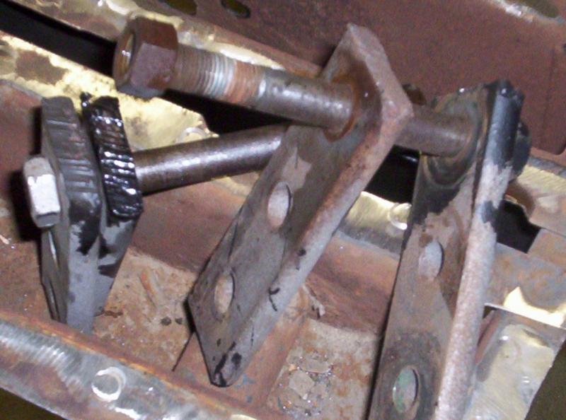

BTW check out these custom tourched shackle I took off!
View attachment 198043View attachment 198044

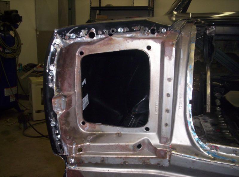

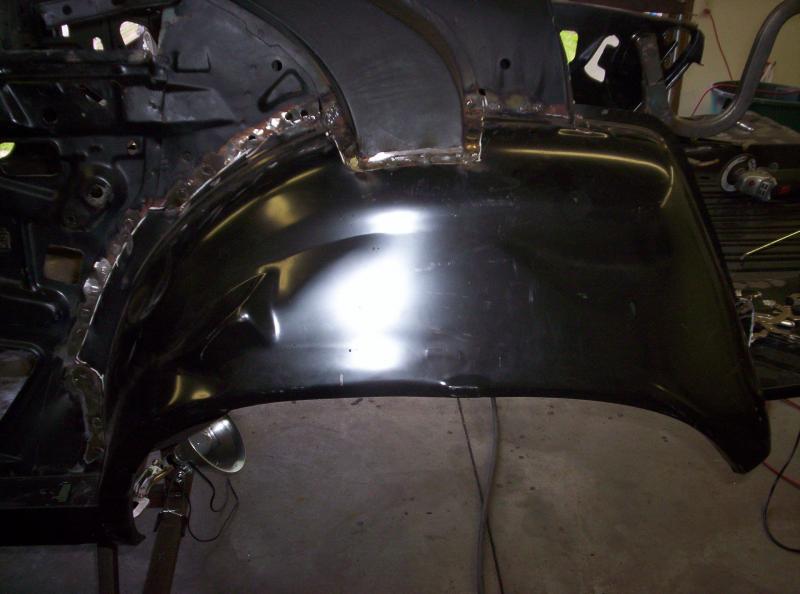

Next I hung the 1/4 back on and rear window filler. Once in place and real close I screwed them down and started welding at the door jam, then down across the rocker, back to roof seam, then to tail light panel. Then back to outer wheel wells.
View attachment 198045View attachment 198046
View attachment 198049View attachment 198048

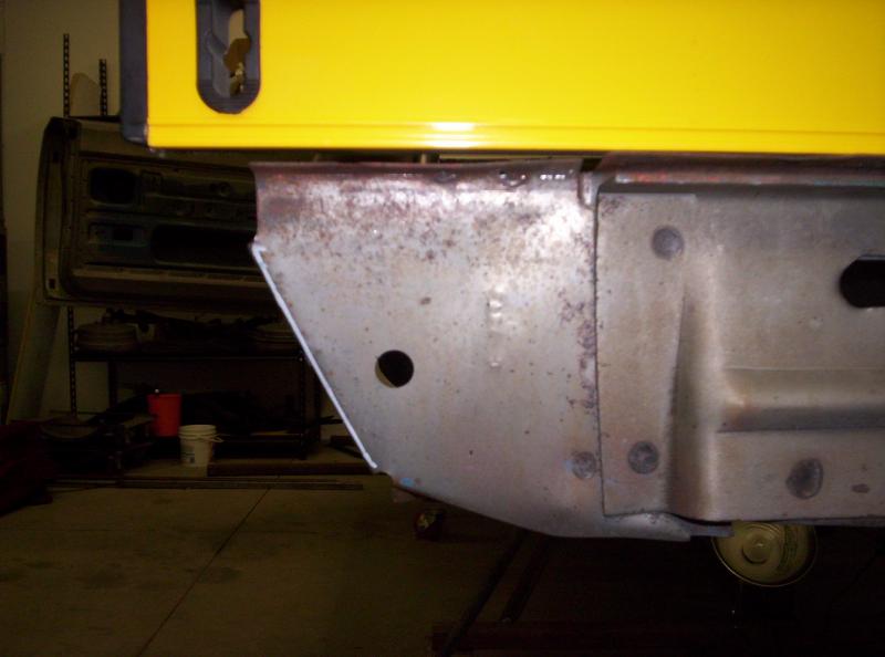

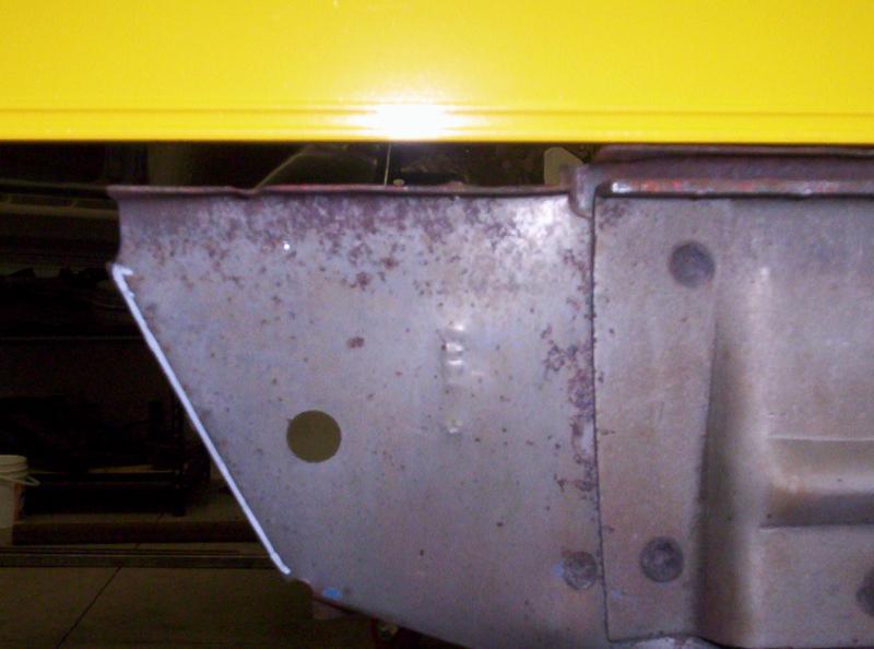

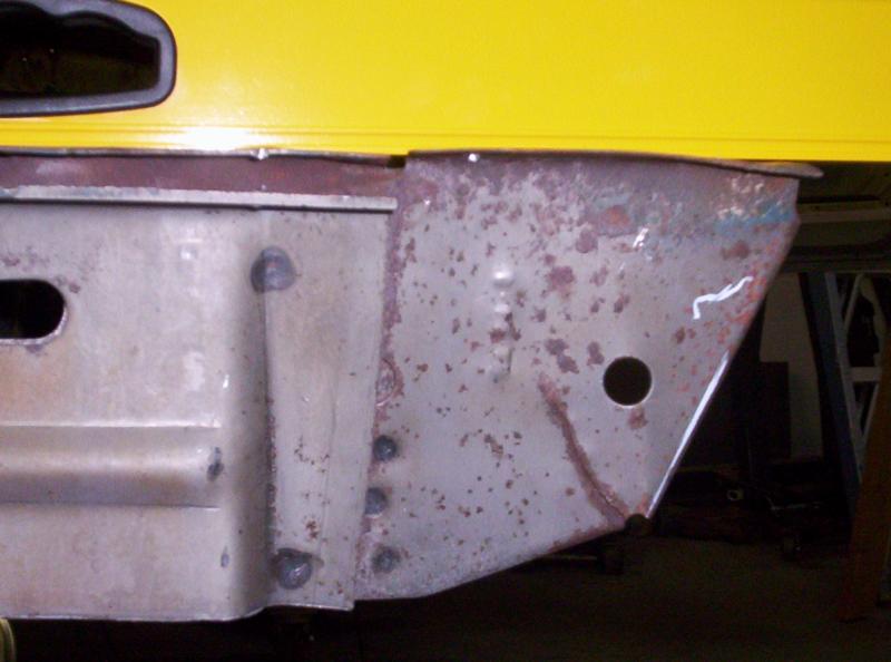

You can see how far off the trunk ext. pads were off from right to left from the factory! so I corrected that a little.
I can't stress enough that get your body lines right & gaps right also. I know it's a pain I had the 1/4's on and off at least 4-6 times per side getting everything as close as I could. I have 1/4 gaps at the doors and trunk and the trunk was a stinker getting right. Another thing check your drip rail piece that goes in the rear 1/4 window also I was lucky to catch that one.

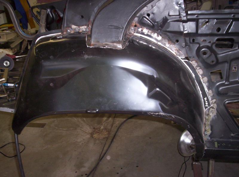

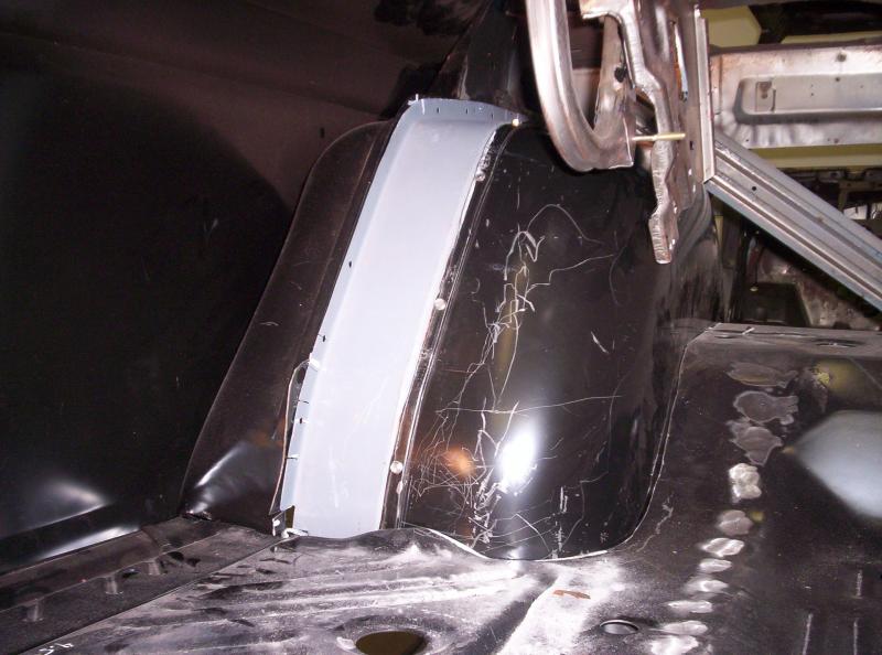

So theres the left mini tub mocked in place. Looks pretty good huh. I rolled a step in the 2 pieces so when I weld it and sand it smooth it should look pretty clean. I'll have the body guy give it a swipe of filler if needed. Oh I forgot I used Eastwoods rocker panel sealer for the inside. stuff works great. I did combine to of the 18" hoses so I could make sure I got overlap at the middle of the rocker when coming from both ends. Also used it on frame & to shoot in between the trunk panesl to seal it up a little. 6 cans in all.

The strait shots of the extensions were perfect!!!
I printed the photos and matched up my parts.
Conclusion: The AMD parts are REAL CLOSE to the originals in the pictures.
So, for me, I need to figure what is wrong, maybe the quarter patch panels welded on 20 yrs ago are out of wack :(

What did you coat these with? I currently have mine out of evapor rust and coated with Boe shield for now but want to paint them.
I used galvanized paint. I bead blasted them very lightly first to remove the crud. Then coated with cold galvanized paint.
