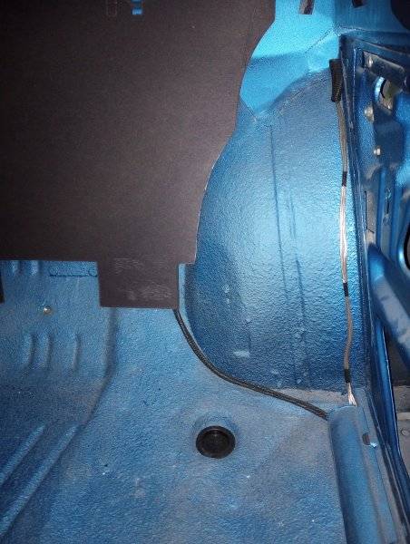

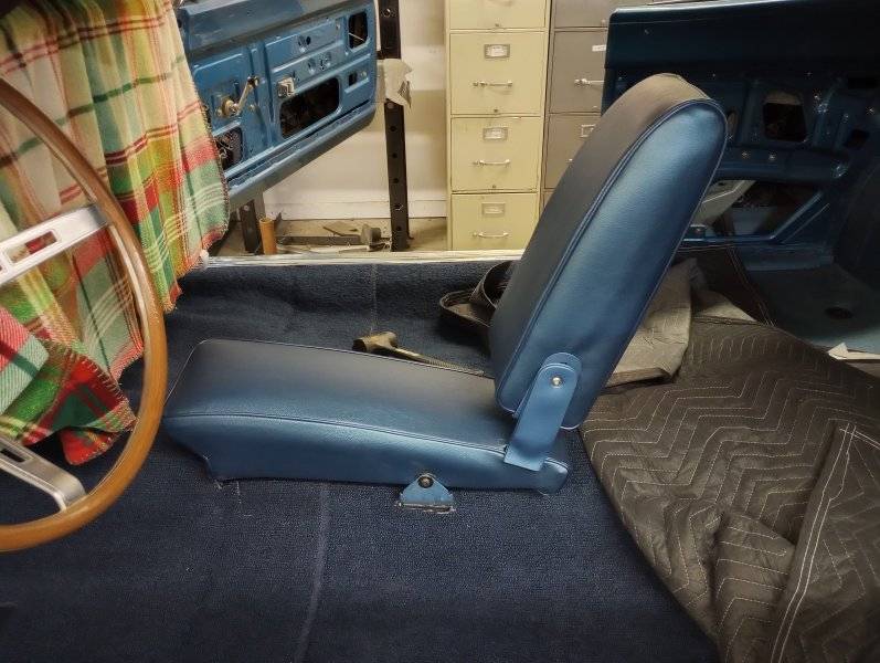

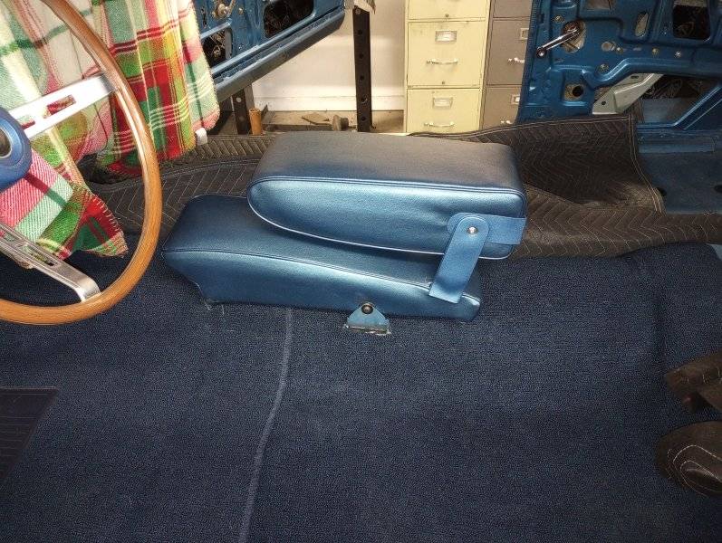

Got the back installed.

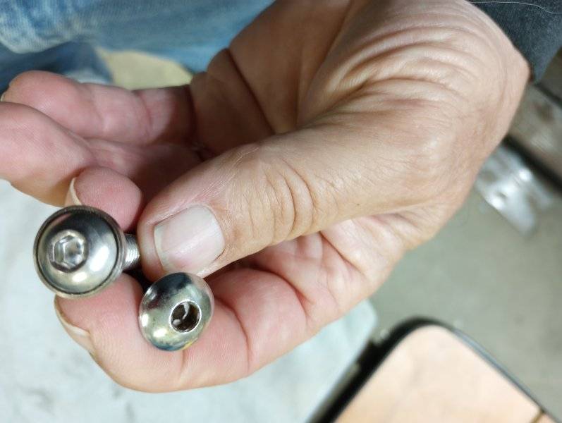

Put the holes in for bracket mounting bolts. I bought some rubber washers to put between bracket and seat. Also used button head bolts to avoid sharp edges. I almost had to much sound deadening/carpet. I really had to push down to get it bolted in.

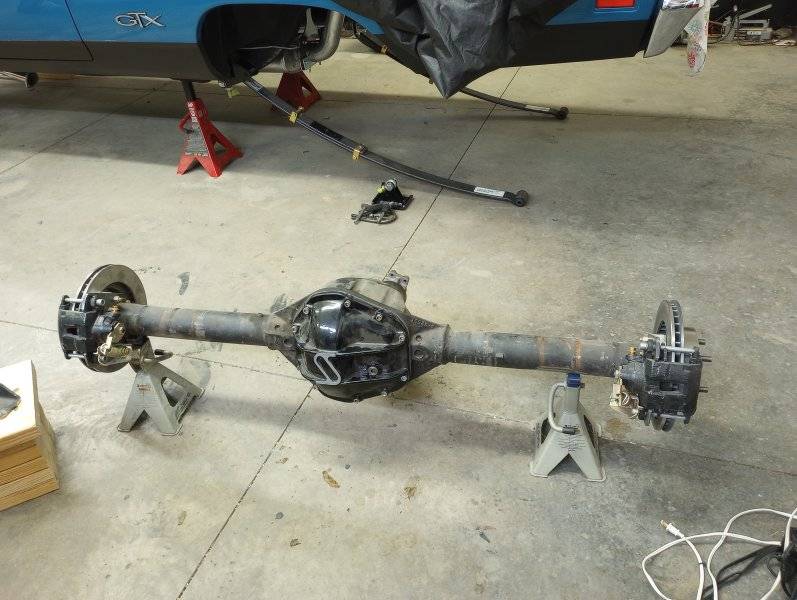

I worked the rest of the day checking driveline geometry. I'm going to need a new driveshaft because of the gear vendor. I found my pinion is about 1.25" to the driver's side of the engine/trans centerline. Which is about 2.5° I'm wondering if this is going to be a issue. Going to be doing some research. Also need to check with Cal Trac for their recommendation for pinion angle.

So today I pulled the rear end out. I kinda got the pinion angle close just for giggles for a visual first. Going to take it to a shop for inspection and a front pinion seal. Also check the suregrip. It currently has a 3.73. It's a truck Dana but with the cal tracks the absence of a pinion snubber shouldn't be a problem.
Dana is going to the shop for a checkup before going back in for the last time. May 8th. That should give me time to pretty it up and get spring perches welded on.
I think 3° down. I need to call Cal Tracks to confirm.

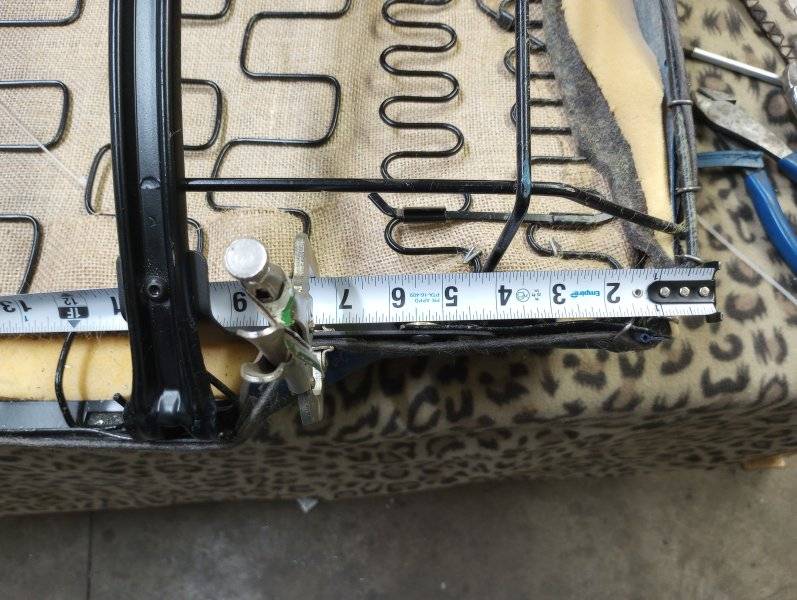

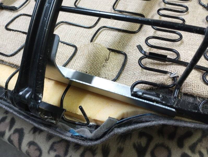

So I thought I'd throw the seats in Saturday before doing exhaust. But I quickly realized that I forgot something. When I mini tubbed the car I didn't check the rear seat frames before I had the covers installed. Guess what, they didn't fit......
First I had to revise the package tray clips. Had to customize the bend and lengthen the slot.
I already modified the divider board. I widened the wheelhouse 3".

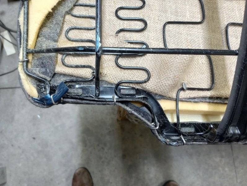

So the rod that curves up then over, I pushed down . I basically moved the radius clear over to the perpendicular rod. The one at the bottom I bent the bottom sheet metal piece and rod. That did the trick and it went in. Had I thought ahead I would have cut it loose bent it then welded it back. But with the seats covered I just used a rubber hammer and beat them into submission.

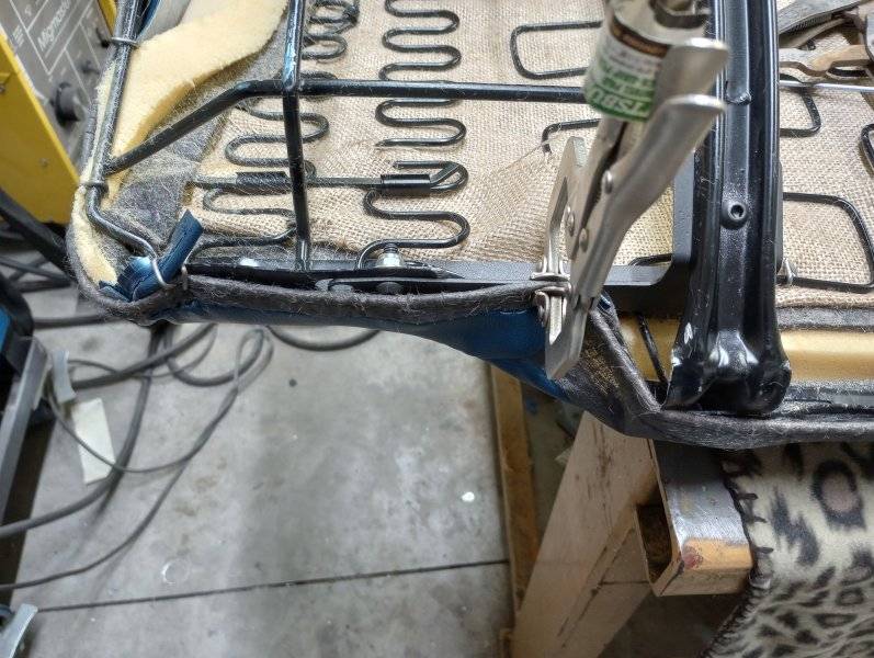

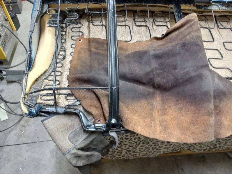

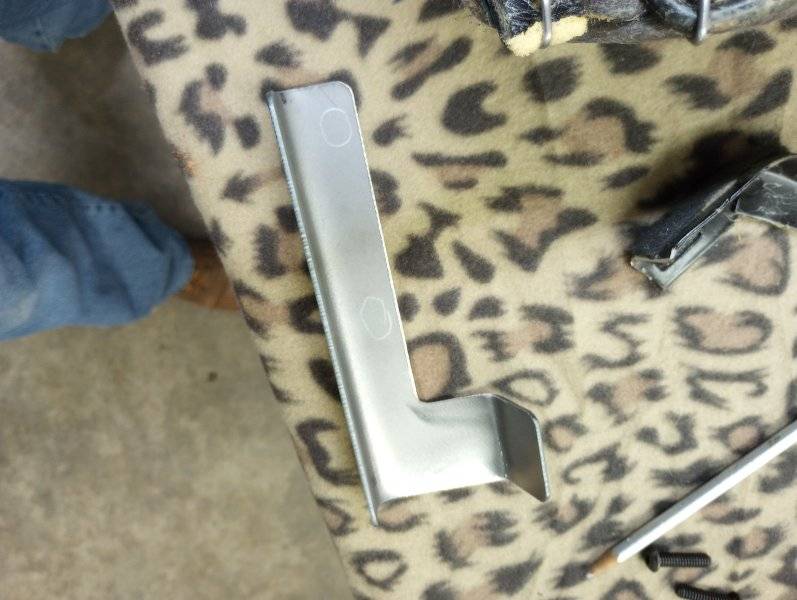

So I tried the bottom half and same thing, no fit! So I basically took the stock relief and moved it 3" in board. So I cut the hog rings and then cut the angle piece out clear over to the first brace.
So with with the piece removed I used a license plate to make a quick pattern to see if it would work. It looked good so I had my friend plasma cut me 2 pieces and put one one of the bends in. I planned on putting the second one in as I fit them.
I added hog ring holes for the upolstry too. I vise gripped them in place the matched drilled them. Painted them and then bolted them in. I think I have enough clearance now. I'll get some hog rings tomorrow and then see if it fits.
So then I started putting the tracks on the front seats so I can install them after the back ones are in. Enough for today.
