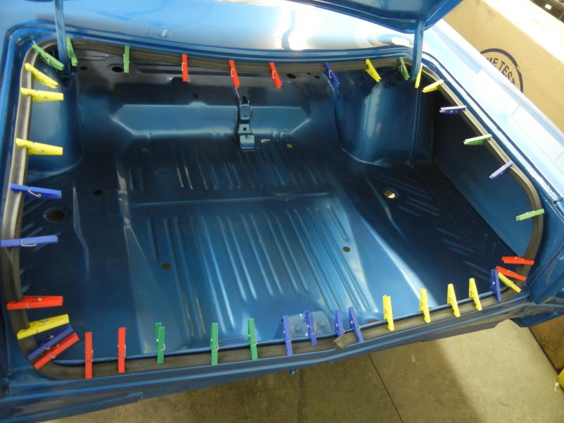

Will I picked up 2 tubes of the black 3M that should be enough shouldn't it? Also 2 pkgs of clothes pins (50).

(2) Tubes is more than enough. Always good having some extra though. I'm sure you'll find all kinds of other things to use it for. Should be good on the clothespins too!

I wasn't sure on the tubes of 3M and figured I didn't want to run out with a foot to go. Did you do it all at once or in sections. Thanks again for the info and better hunting next time. We will be coyote hunting next, look out Wile E Coyote.

As far as the installation, I do it progressively (work a section at a time). First I lay the seal out and position it where I want it, then Clothespin it in place. After that I just work from one end to the other, taking the pins off, applying the 3M, putting the pins back on, then starting another section. I've found with that route you end up with a nice uniformed, level seal.

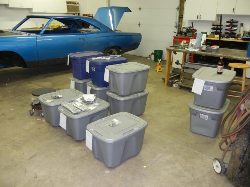

So I went through all the boxes and sorted them by where they went & put them in totes with a list on the outside for easy refferance.

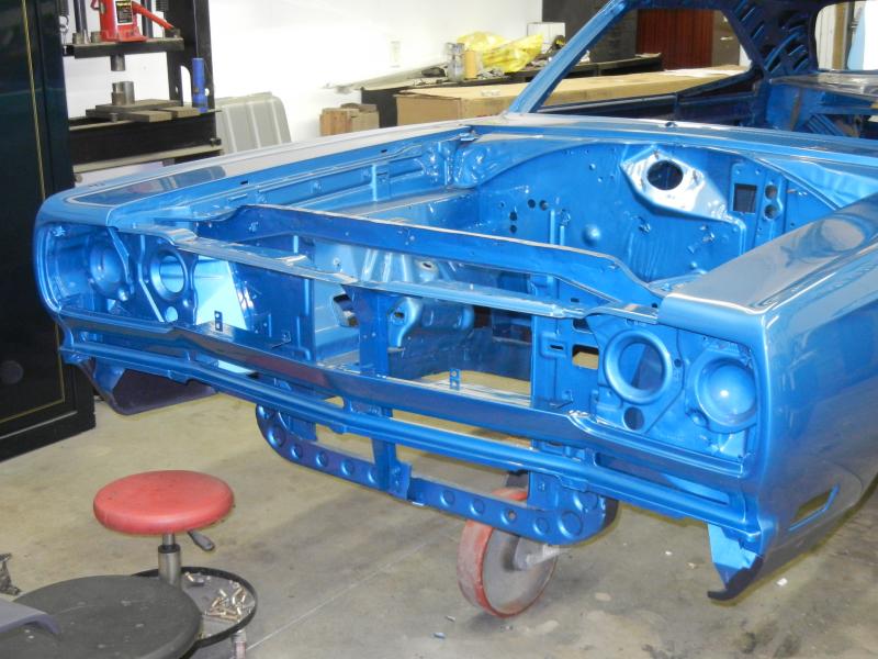

I loosely bolted the front end parts on so they wouldn't be laying around
So I decided to start in the trunk so I got the trunk seal out and clamped it in place so it can relax and form to the trunk. I'll glue it down in a couple days when it relaxes. I als put the trunk lock in. That would have been much easier before putting the trunk lid on! I also put the lower door seals on before instaling the windows so they also could relax and take a set. I went to a swap meet today and scored a complete bumper jack with lug wrench for 5$, great buy I thought!
