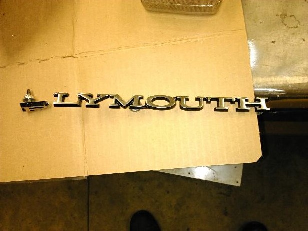

So some friendly advice, I ordered new emblems for the trunk lid. They are very brittle! I would suggest putting them in a soft vice to run down the cutter nuts the first time. I tried holding it from the outside of the trunk while tightening and you can see the result. I think the plating on the stud or maybe the wrong diameter of the stud are to blame. Good news is Year One sent me a replacement at no charge.
I had the same problem with a new Charger nameplate for the headlight bucket, I ended up having to thread it and put a regular nut on it. That really sucks!
Good thing was they replaced it and I didn't scratch any paint. But I did cuss a blue streak when it happened.....just knowing I scratched something.
I've been trying to think of something better for attaching these things., How about a few drops of gorilla glue somewhere?, maybe on the studs inside and nuts barely tight but glued..
The old emblems were made of softer material & not plated on the back. I think we need to just remember to take great care when installing them. They certainly aren't cheap!
I had to use old cutter nuts when possible, and I took new ones and reamed them a little since it felt like studs would snap easily; on old and new emblems

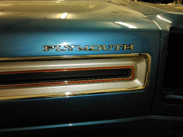

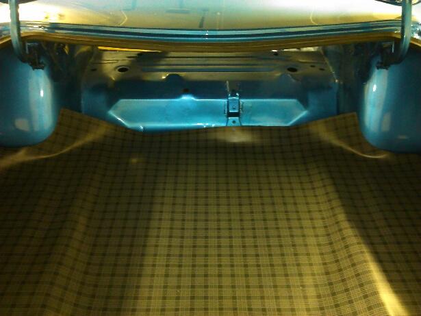

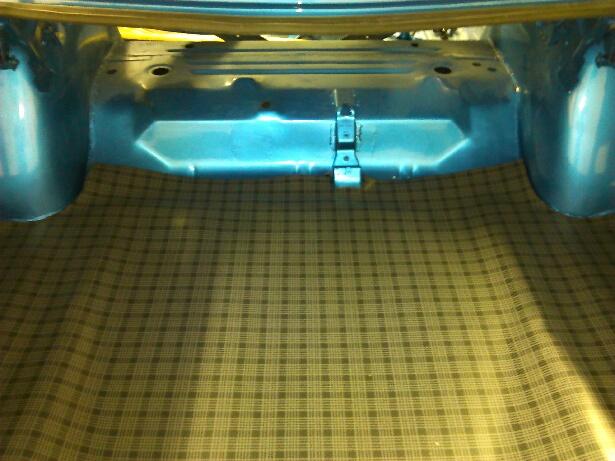

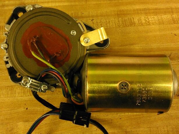

Had a little time on the GTX today. Trimmed the trunk mat for the mini tubs, and got the replacement emblem back on the trunk lid.
looks like that trunk mat fits pretty darn nice ! How is it around the wheel humps and the cut outs on the tail panel bracing? Also, is that tan or gray? (sorry, I can't tell from the pics)
Gray, tail panel cut outs were real close only about 1/4 inch trimming on braces. Year one piece. Fit wheel humps pretty good except for the mini tubs.
