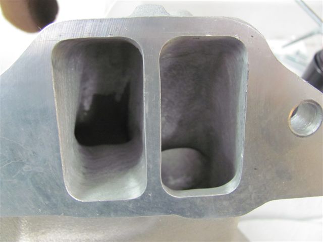

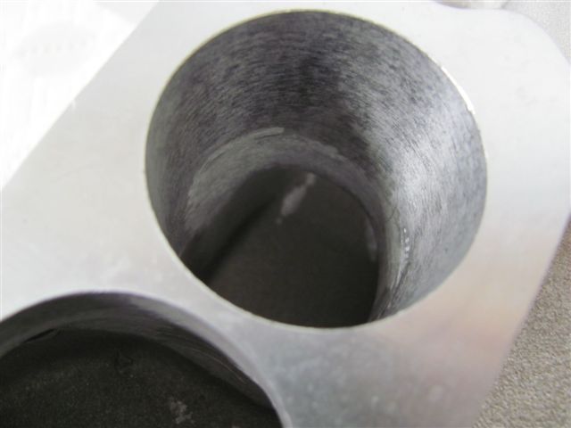

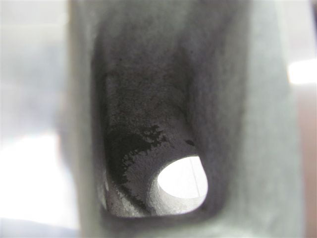

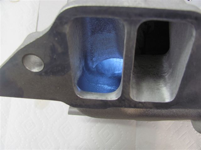

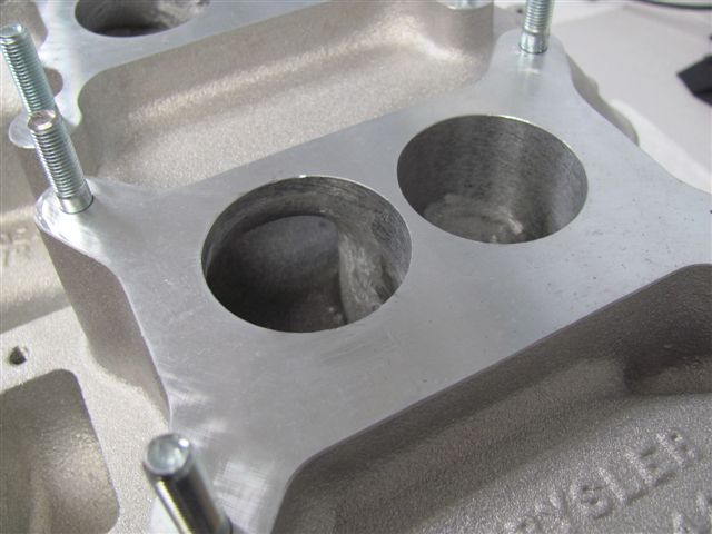

On that note, Jim has been doing some port work on my 6 pak intake and it looks great. If he gives me the ok I will share his work here. I'm very encouraged by his #s!!!!

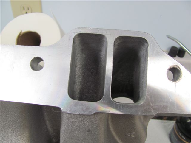

Well I got some good news from Jim (IQ52) yesterday, my cam is finally on it's way! He also sent me some pictures of the work he did on my intake, with some flow #s for comparison. Tim Borrall 440 002.jpgTim Borrall 440 003.jpgTim Borrall 440 005.jpgTim Borrall 440 006.jpgTim Borrall 440 007.jpg
#1 your head port 4 or 5 slightly cleaned up with no intake on it
#2 your head w/ OOTB 440 RPM intake
#3 your head w/ ported 440 RPM intake. This intake made 640 LB-FT and 627 HP on a 496 stroker with a bigger solid street roller but with heads that only flowed 292 cfm @ .500” and 309 cfm @ .600”. Again, your head is in column #1
#4 your head w/ ported 6-pack intake
#5 your head w/ported Victor 440 intake, slight mismatch as the intake opening was bigger than your head port opening (wrong way mismatch).
Lift...........#1............#2..........#3...........#4...........#5
.100..........77...........77...........77..........77...........77
.200........157..........157........155.........156.........153
.300........228..........217........224.........222.........230
.400........283..........246........264.........262.........279
.500........328..........270........286 ........291.........312
.600........341..........276........297.........295.........326
.700........337..........284........309.........301.........332
So we’ll test combinations #3, #4 and #5 on your engine.

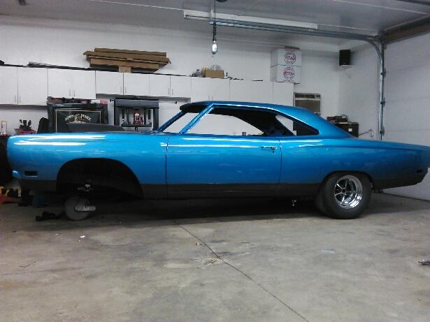

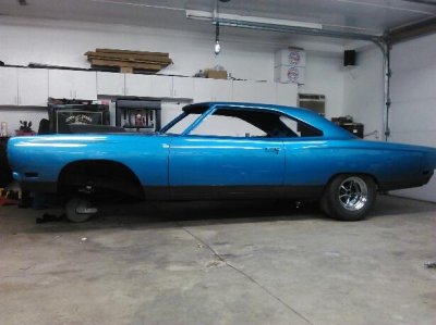

Gotta wish my GTX happy birthday! 47 years ago today at St Louis. Hopefully she is back on the road this year.IMG_20141215_172759.jpg
:bday3: Happy 47th, doesn't look a day over a day old.. Mine turns 46 somewhere around this time of year.

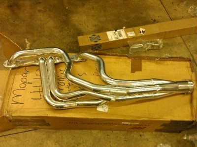

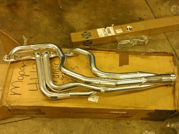

Got a present for the GTX last night, some TTI 1 7/8 ceramic headers. Man they are nice!IMG_20160128_180003.jpg
Got a present for the GTX last night, some TTI 1 7/8 ceramic headers. Man they are nice!View attachment 304481
TTIs are simply beautiful and the fit matches the look. They also end up at the cross member evenly. Can't get a better present than TTIs.

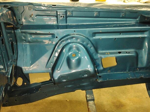

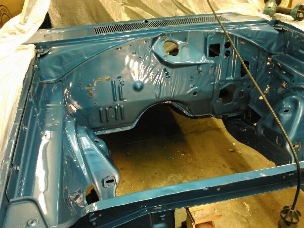

Well I spent Fri night & Sat. buffing out the engine compartment. The buffing wasn't to bad but cleaning the compound out of all the cracks, seams, and spot weld low places was a pain. But at least now it's done and I can now start bolting on suspension parts.
