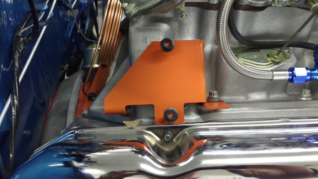

Got the coil bracket painted & installed.

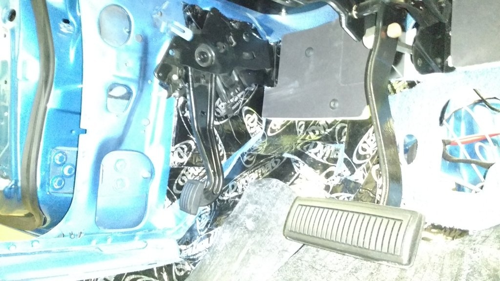

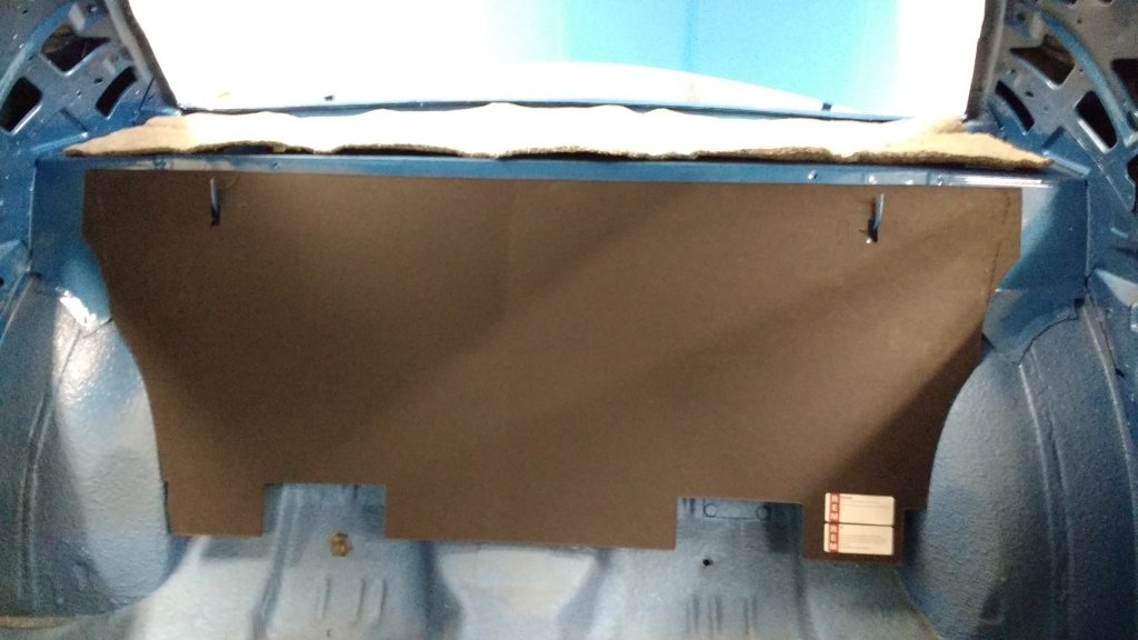

Didn't have much time last night but I did get the rear seat divider trimmed for the mini tubs.

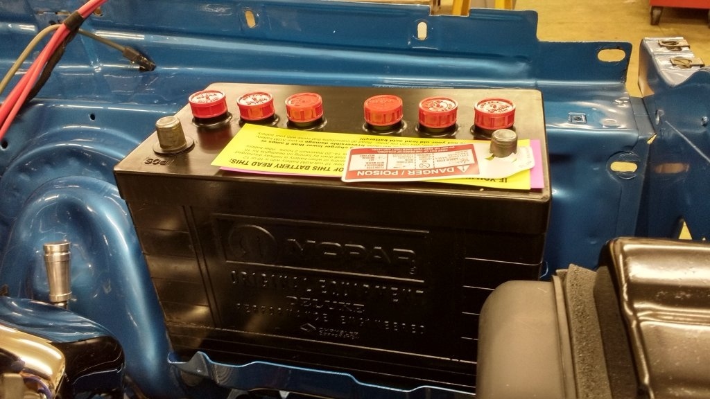

Something about a interstate or Wal-mart battery in these cars doesn't look cool to me.

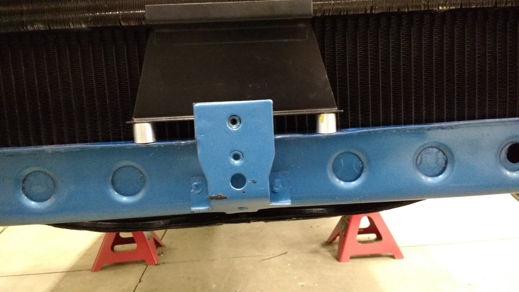

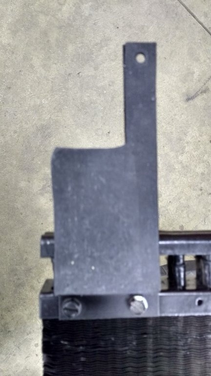

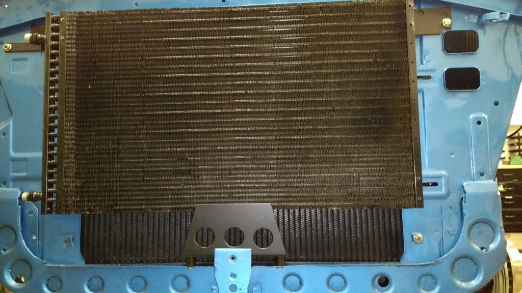

well I'm pushing forward with the ac system. I had to cut some of the length off of the stud for the 22 to 26 radiator brackets I made. It was interfering with the condenser bracket.
I drilled a second hole in the bracket to move it up a bit, then clearance the bracket for the opening.

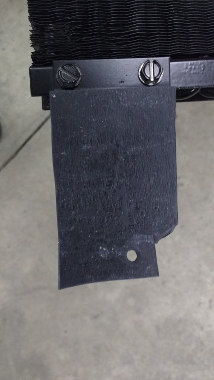

I put some rubber on the back side of the brackets to keep it from rubbing & squeaking. Straightened all the fins and touched up the paint.
I moved the condenser up a little so the bottom bracket needed moved up also. I had a couple aluminum spacers I made to move up the condenser bracket.
I also put some airflow holes in the bracket while I was at it. Straightened some fins and touch up painted everything.

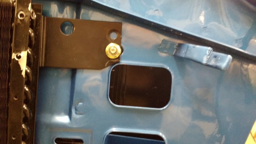

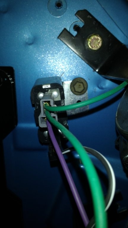

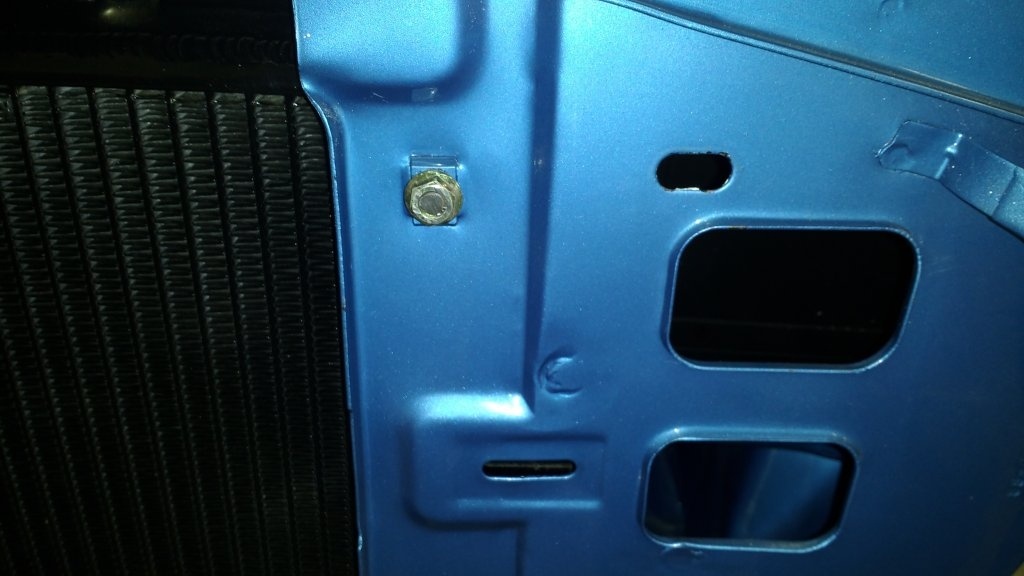

The upper pass. side bolt hole was covered by the horn relay. So I used a buttonhead Allen screw for that bracket.

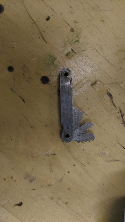

I started taking inventory of the fittings I'm going to need for the ac lines. This is a great tool to have in your box. It will tell you how many threads per inch a fitting or bolt has. And rule out metric hardware.
