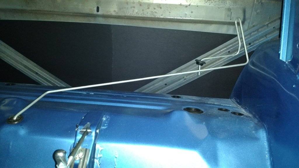

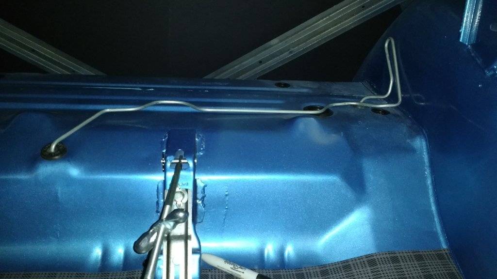

Opps! Forgot I mini tubbed the back. Had to rework the upper vent line to make it fit. Shortened the leg going through the floor and put a couple extra bends to shorten the leg to the wheelwell. All this will be behind the spare so no one will even notice. Fuel line in now complete to the front end! I just nee to tie up a couple more small things and I'll be firing it up (hot wired). Can anyone tell me, do I need a yoke in the back of the tranny to stop a dextron lake from forming upon startup? Need to fill the tranny & PS pump. Going to leave off the alt & AC belts for initial start up. Don't want to run the AC compressor till it's charged.

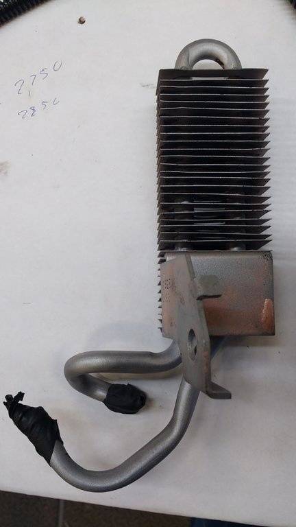

A friend from here offered me this little gem! A little work and it will be a nice addition to the PS pump!
Another "cool" piece to go on the GTX!

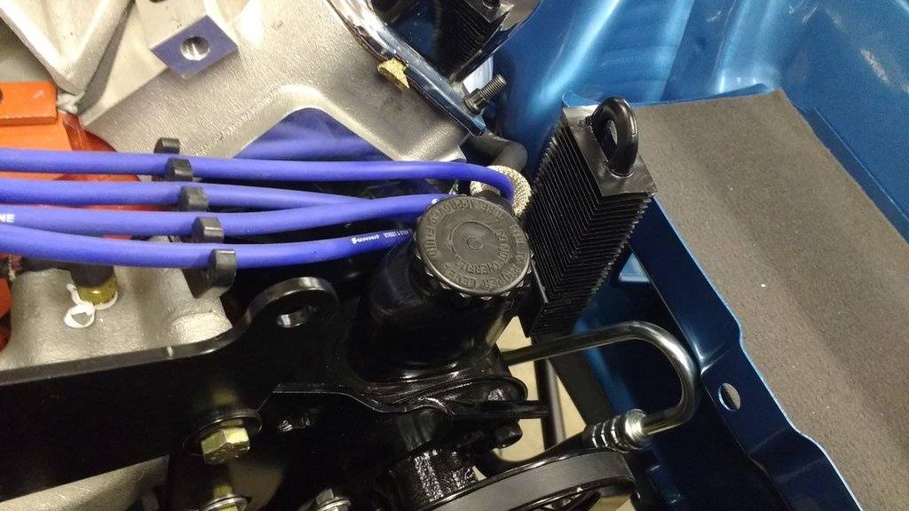

Got a little done over the weekend. Got the PS cooler painted & installed.
I would recommend installing one on the pump before putting the pump on, much easier!

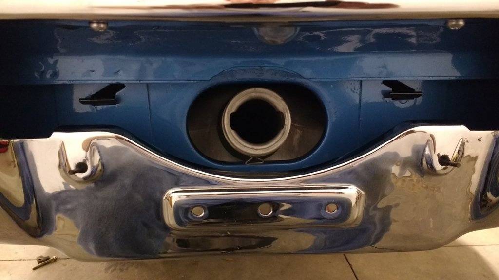

Got the filler neck & grommet installed, again it would have been much easier had it been installed in the tank first. A little oil helped things slide together. Anyone know if the little bracket that slides in the band that's bolted to the body is body color, black, or zinc?

The Bracket is zinc plated...midway down the page for reference
