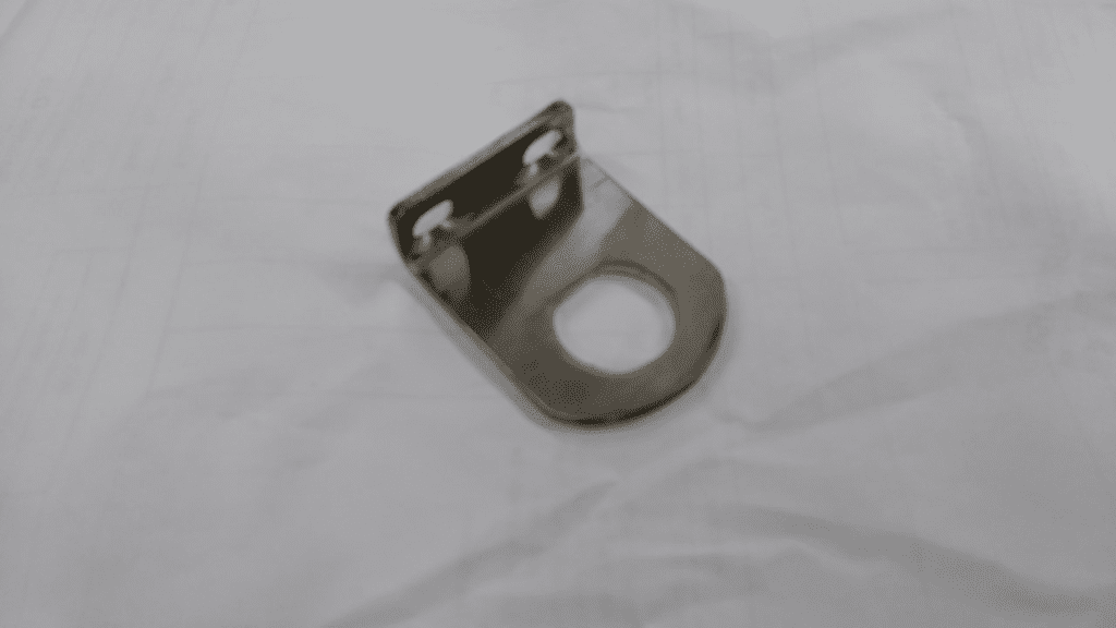

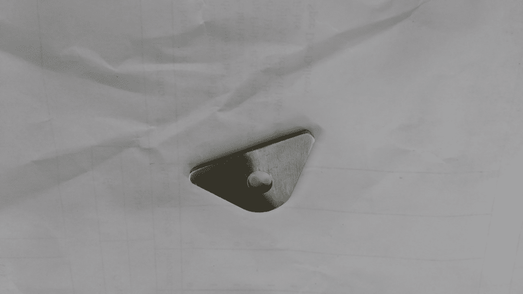

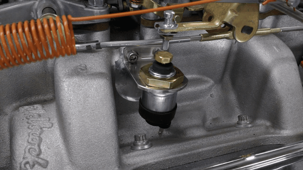

Well I managed to get the shop cleaned up finally after the home improvements! Even spent a little time on the X. Got rev 2 of the idle solenoid on and also made sime washers for the stamped steel valve cover. All out of SS. Between the 12 pt small nuts and the stamped steel I figured it could use some help sealing the gaskets. If anyone wants a idle solenoid bracket I have extras. I used the holley one. A friend used the OEM style one from year one but it didn't last a year, so that's why I went this way. I have the phenolic spacers under the carbs so had to adjust accordingly. And make sure it cleared the outboard carb linkage.

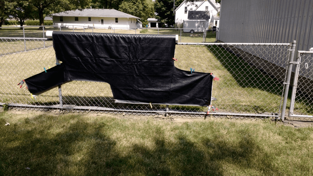

So I did manage to do a little something. Dug the vinyl top out to put in the sun to get the wrinkles out. Been in the box since 14 so hopefully it'll relax or I'll order a new one. I want to get that on before fall. With the 90+ temps I thought this would be my best chance of seeing if it will relax.

Also I'd say about 80% of the wrinkles are out of the vinyl for the top yesterday. These 90+ sunny days sure get a black top hot. Think I'll hit it with the temp gun just to see what ir measure compared to a light color. My 69 RR that was this color had a white top, never to late to change my mind.
Lay it on the top of your cars roof it will flatten out especially with a little heat....It needs to relax a bit after being in the sun...
