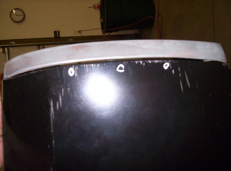

Will and Minn. Guy you can see I also have gappage to deal with:angry9:

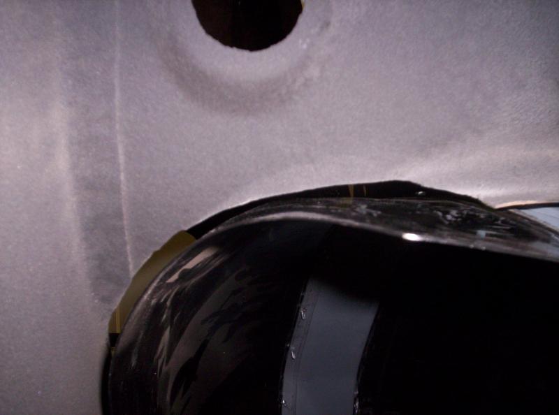

Dare Devil here's minitub from underneath. Thought it was easier to get a picture.

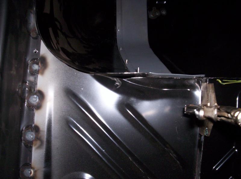

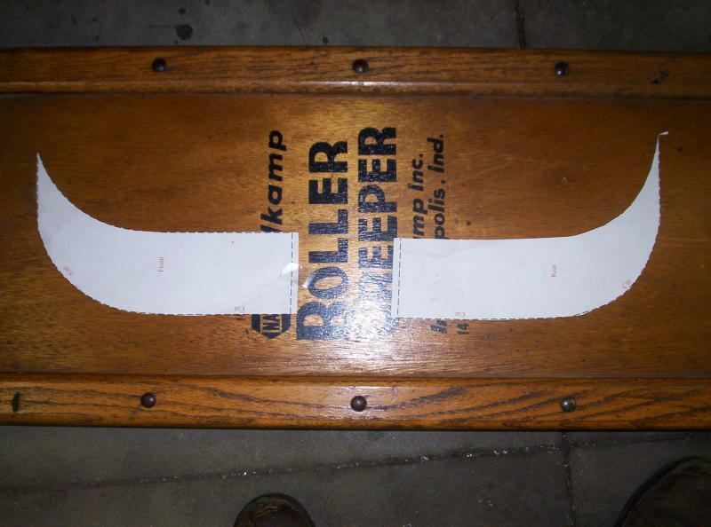

First 2 are rear left tub from underneath, 2nd 2 are left front from underneath. Also here are the patterns from US Car Tool.

If you can't get the instructions to print off their site PM me with your address and I'll mail them to you.

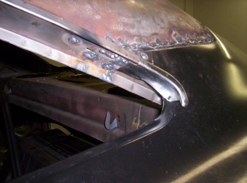

Drip rail trim I was talking about being aligned. I still need to sand off my spot welds also.

Yes sir, I have the same issues. The bondo bucket is used here to fill in those areas. Your body shop shop will get that corrected.
I'm thinking I will build it up with weld to get it close. I got one tub welded togeter and ready to go in and ran out of welding gas so to the weld store I go tonight. The trip with the better half is this week so don't know how much I'll get done till the following weekend. Aug 1st will be here fast!

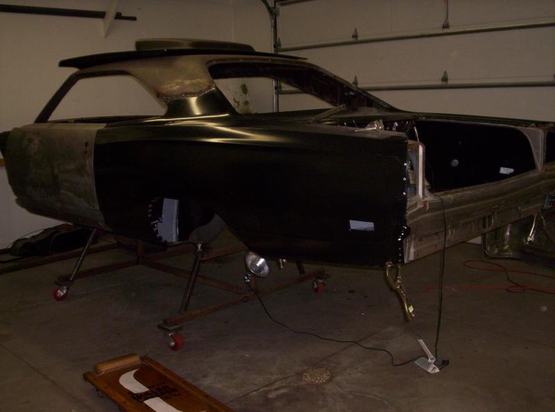

Back from vacation yesterday and got the left wheel tub welded in Looks pretty good. Time to start on the right side! Hope to have all the tin work done this weekend. My body guy John text me and said he's ready for the car any time. Can't wait!!!!!
......this stuff is a science and an art. It amazes me how the factory fit & finish was so off on some the panels. Incredible work my friend.

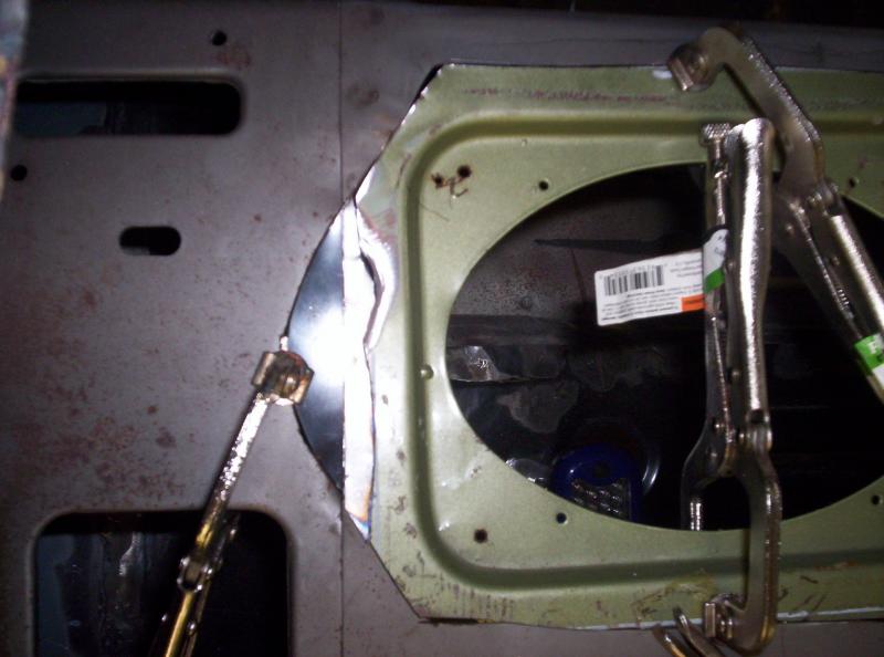

So I welded the trunk floor to the frame rail before final tub assembly.

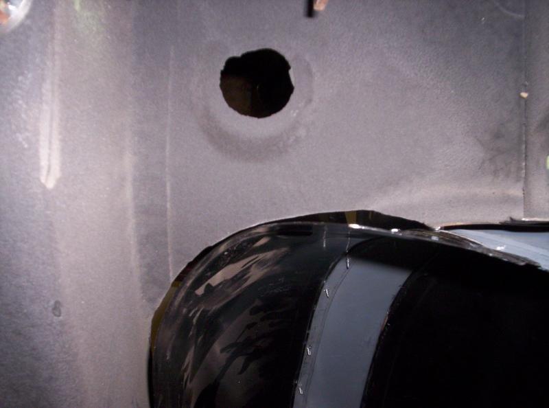

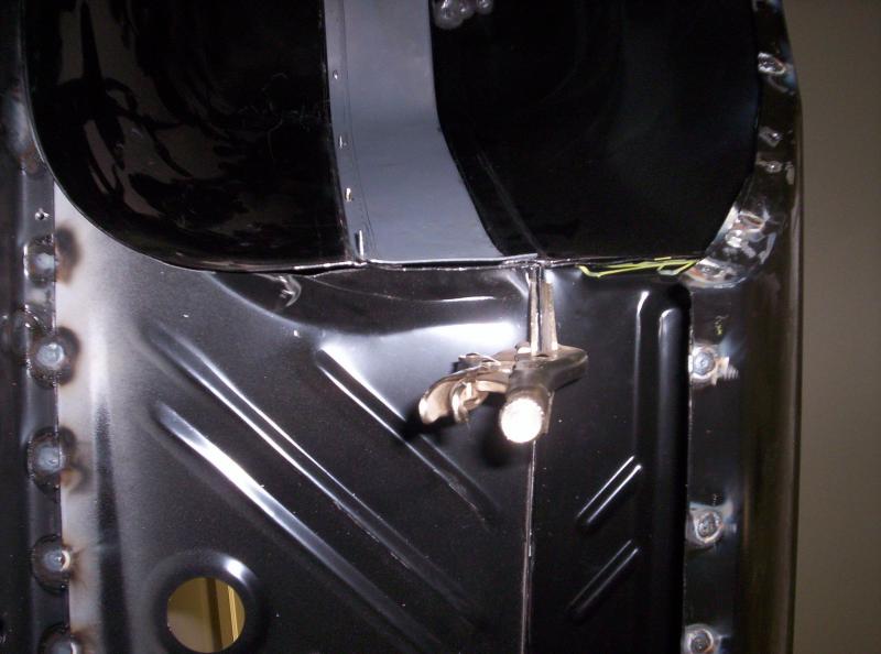

Got the tubs welded in.
Ruler for referance.View attachment 202279

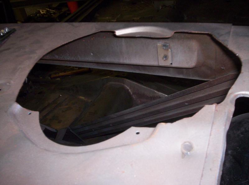

I had to tweak the trunk hinge brackets as it was to narrow by about 7/8 of a inch. So the flattened brackets I was going to use can canned. I cut out the recess in the middle and it gave me enough to get it back where it needs to be.

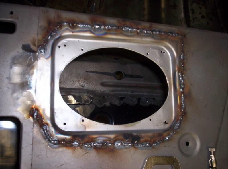

Next is repairing the big speaker butcher job!

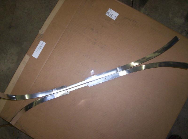

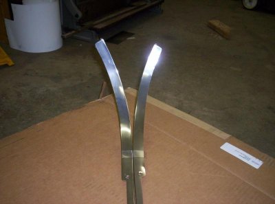

I also ordered the wheel lip moldings made by Metro, big mistake, fit like crap! They didn't even look the same left to right.
I ordered the wheel lip moldings made by Metro, what a bunch of crap that was. They didn't even look the same left side to right side. Sent them back!

Guess I'll keep watching for some OEM ones....
Well hope to get the speaker patches welded in tomorrow. Got the paint blasted off of them. Next offset front spring hangers.
Thanks for update on wheel well moldings. I still need them for my 69 GTX ..They didn't look good. I bet Metro sends them to someone else now? I thought they had the better stuff?
I will be calling Jim's today they advertise "better fitting" wheel lip moldings. I'm going to propose if they don't fit like you say, they pay all the shipping round trip. This set cost me 25 in shipping, although if I'd bought them from Classic it'd been closer to 60!
Thought I hit the jack pot, Jim's told me they would fit, shipping guarenteed. Got all done with shipping info then they said oh yeah these are full RR moldings, Dammit people why do you advertise something you don't have! She said just cut them down........ This isn't a Gas Monkey project that I'm just scabbing together here, I want it right, the first time. Ok I'm done ranting..............for now.

T She said just cut them down........ This isn't a Gas Monkey project that I'm just scabbing together here, I want it right, the first time. Ok I'm done ranting..............for now.
"just cut them down......."....WTF!!!!!
That wouldn't be a problem if they are stainless or aluminum. But if they're plated they can't be buffed out where they are "cut down". Also if I'm going to put that much effort into them why not just get some OEM's to clean up.
