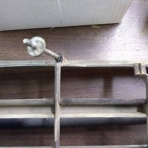

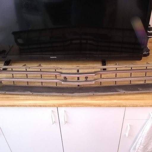

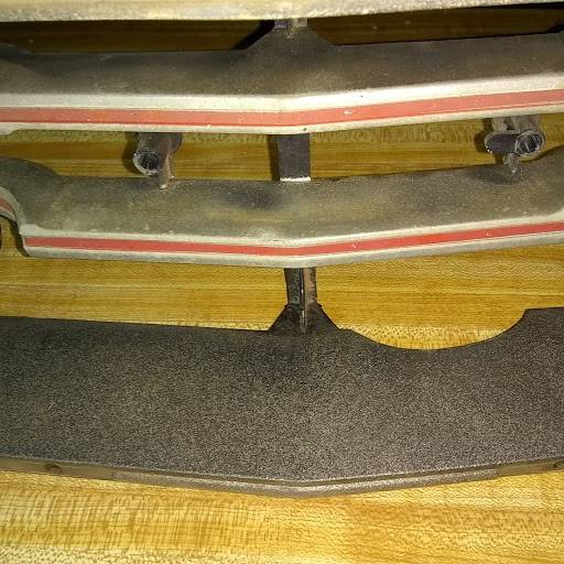

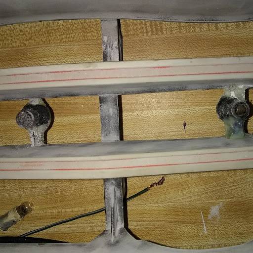

More work on the grill last night. The good grill I removed all the studs & brackets. I had one stud that was bent, got it repaired. Man is it nerve racking removing those studs!

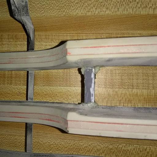

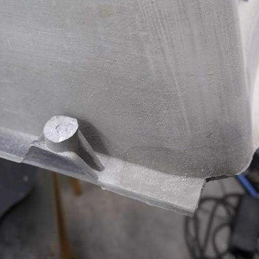

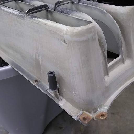

Made a new pillar for the one stud on the old grill. And fixed, glued the broken corner. I'll dress them up and then mix up a acetone mixture to add some more material for strength.
Oh boy, you ain't kidding. They are brittle. On that new mount, what did you use to glue it?
it's a permatex product for "welding plastic" 2 part glue" has a hint of Testors airplane glue smell...

I'll post a picture of it. Sets in 5 min so easy to work with.
View attachment 615946 View attachment 615948
:fool:
I haven’t had much luck gluing things like that over the years but adhesives have come a long way in the last ten years. Can longer studs be used so that they bridge the joint between the new part of the tower and the original grill? Just curious.
That stud was missing, so I was panning on gluing in the stud that I had to make as a replacement. I also planned on adding more plastic material around it to give it more strength.

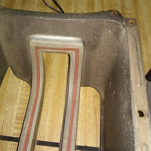

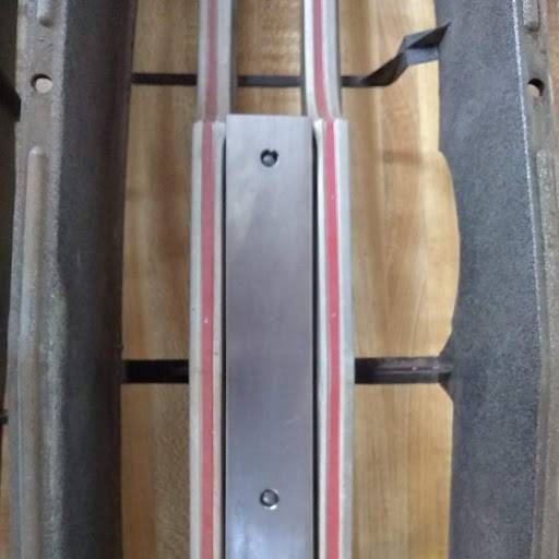

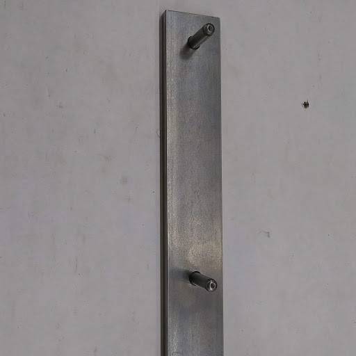

Here's the fixture I made to locate the GTX emblem.
When I did mine I used Brownell's Acraglas Gel, which is used for bedding rifle actions. The stuff works extremely well. Better than 2 part epoxy imho.
Took lot's of reference pictures for overspray and colors.
Tried out the fixture on the good grill, fit like a glove. I made it so it lined up with the corners on the grill. Should work just fine.

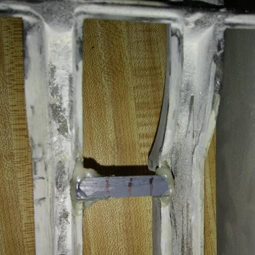

So I tried working on the grille last weekend. It was middle 90's and the epoxy glue was trying to set up a little to fast for my liking so I only glued the one side in. So I finished and filed the epoxy down to make it look presentable. Then when I got home I got everything in the garage where it was cooler. And finished up the mount for the other stud locater.
Tonight I'll do some more finish work in that area. Then I'll start prepping for paint. If any of you guys need a grill this one will be for sale after I finish it. I always try to give the guys who follow my thread first shot at anything.
