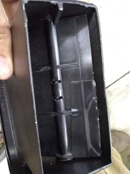

I used Q-tips, Dawn soap, and old toothbrushes, and magic erasers to clean the flappers on the center vent. Also a coat of black for the outside vents.

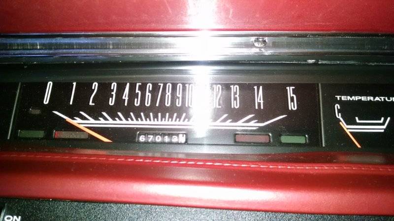

Tim to answer your gap question between the cluster and the trim, mine I can almost stick the tip of my index finger between them....When the dash sits level in the car you cannot tell this....Below I took some pics but is hard to do in the car with my phone...

Thanks Justin! That is the same gap I have on mine. I may put something in there to put a little pressure on the gauge lenses. With it just sitting there, I don't want a rattle or squeak. You also answered the next question on the trim for the hockey sticks. I couldn't figure out how they mated, but I guess they don't very well.

It’s looking great. I’m especially impressed with the mouse repair. I would have never thought of that!
It's stiff enough, but still flexible, and best of all I don't think anyone will ever see it! Thanks Mike.

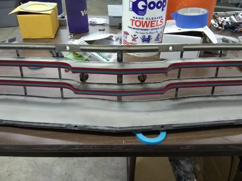

So back to the grille. I found some tape at the local hobby shop that was the perfect width, as bad as I didn't want to buy this brand I did.

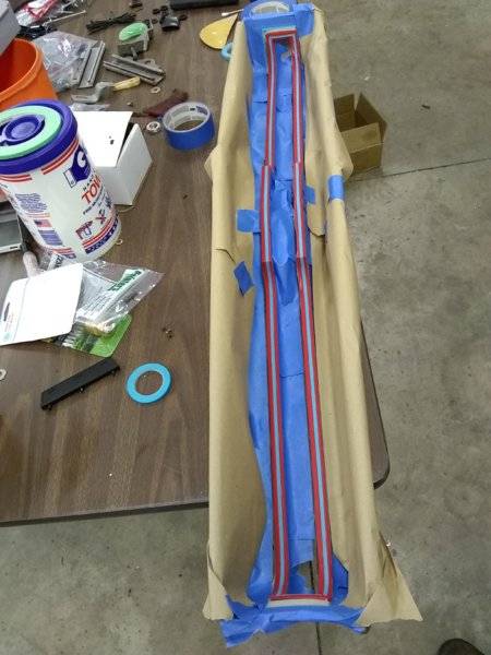

So I did mine the opposite of the advice given me .I was told paint the silver first then brush in the red. My hands are only that steady with a gun. So I painted the red first, then laid the tape in the groove over the red . I figured I'd get a much cleaner line. So here goes.
So I did mine the opposite of the advice given me .I was told paint the silver first then brush in the red. My hands are only that steady with a gun. So I painted the red first, then laid the tape in the groove over the red . I figured I'd get a much cleaner line. So here goes.View attachment 639832
Silver first and spray the red and the final color is the dark argent.....That was the original format...Back in the day they used "rubber forms" to mask off for mass production...
Who the heck said to brush the red?
I originally bought all Totally Auto paints, I was also given a tip by partsmonsta for subs . I gotta say I could not tell the difference on the silver. Out of respect for him I won't say what it is, but you can ask him.
