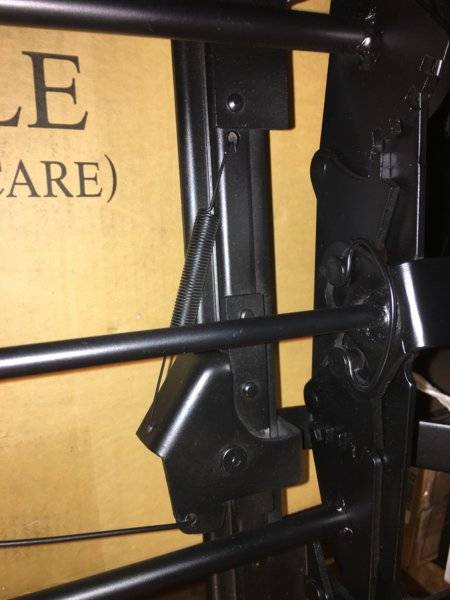

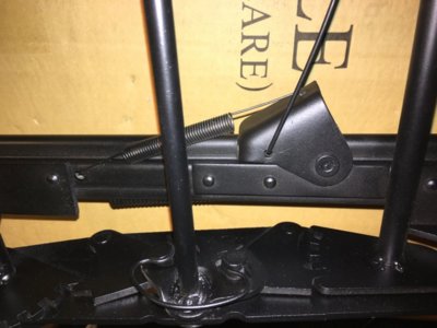

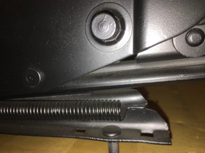

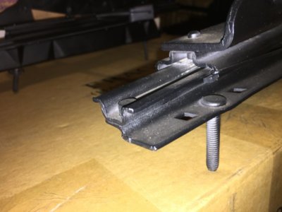

Hello, does anyone have any pictures or other information showing the correct location of the forward/back spring located on the right hand side of drivers seat? This would be on a 6 way seat base for a 69'. Pictures I have seen show a spring between the two track releases, but mine has a wire rod that ties the two releases together. Other pictures I have seen of the forward/back spring, only show a glimpse of the spring, but doesn't show where exactly it attaches to. Any info appreciated, Thanks!

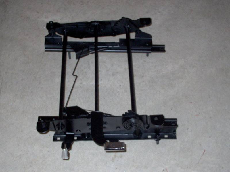

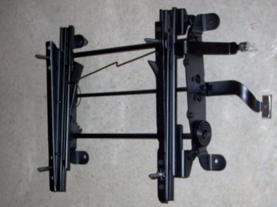

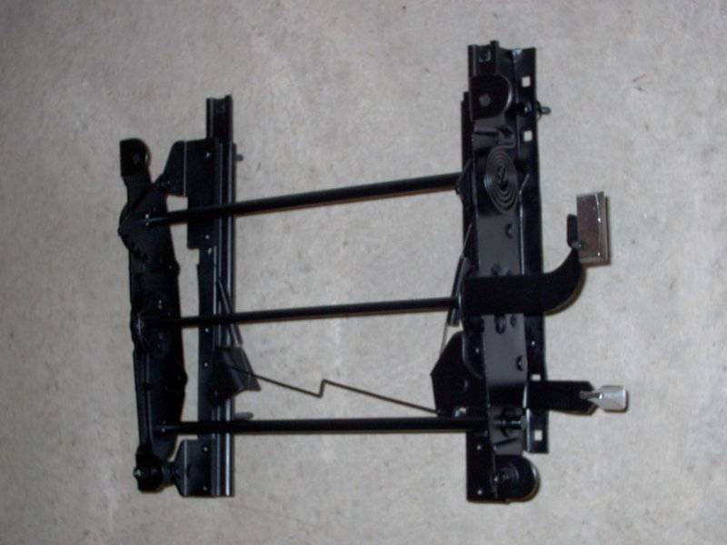

Mine ... '69 also

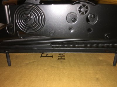

Stanton, do you by chance have a picture looking at the opposite side rail from the control levers? There should be a big spring down that side.
Wow, that is exactly what I needed to know! Thank you so much!! Now I just need to try and locate that spring, because the one I have isn’t correct. Not much information for parts for the 6 way out there that I’ve seen, might have to make one.
