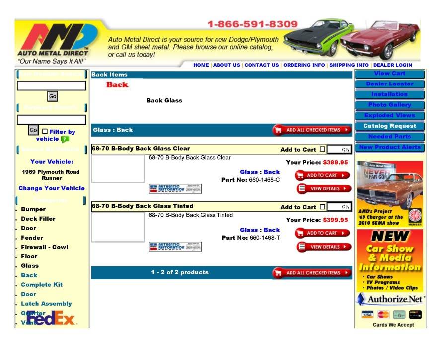

Keep in mind, while you can buy a new windshield you cannot buy a new rear window for these.
(prolly already knew that)
Sure you can Runner...........
Trick is not having to. 1969, lot of good ideas on here to go by and like General said, avoid twisting/prying too hard... Real good way to chip/crack the glass.
Huh.....learn something new every day
