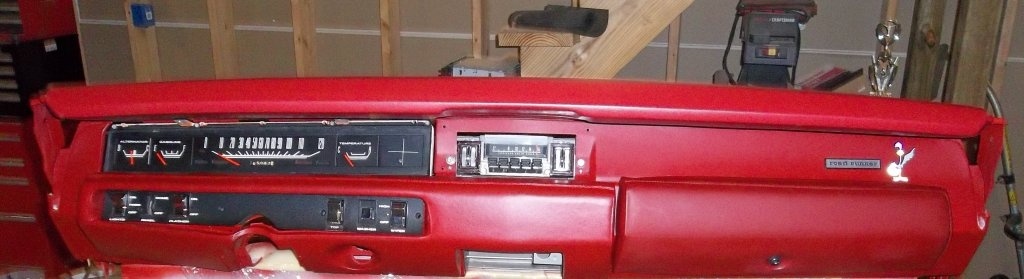

I am trying to restore my switch panel. I know it originally has a texture finish. What is closer to the original texture? John Deere Blitz Black or the Rustoleum Texture Black
Any ideas what black finish the glove box hinge should be ?
Blitz black doesn't have texture in it. Very good quality paint, though. I've used many cans over the years.
The texture for a switch panel on a 69 is made into the surface of the panel. A 68 switch panel is smooth. I used semi gloss on mine and it looks great.
When prepping the 69 switch panel, don't use sand paper as you will smooth out the texture. A scotch brite pad works great for this.
Rustoleum texture black is very nice on these!
Thanks everyone. I ordered a can of Rustoleum black texture.
