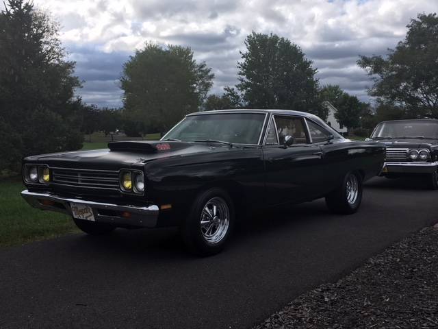

I ran a 295/65r15 on the rear with 15x8” wheels (4.5” bs) and super stock springs. Probably can get away with a 275/60r15 with stock style suspension (that’s a 28x10.5). Honestly, you want the smallest tire that will hook. Less unsprung weight and more power to the ground with a smaller tire. If you're running a 4.10 gear, going from a 28-30" tire will decrease the effective gear ratio around - 0.3:1. So, 4.10 to 3.80 effective. I would go with a 4.30 gear if running a 30" tire.

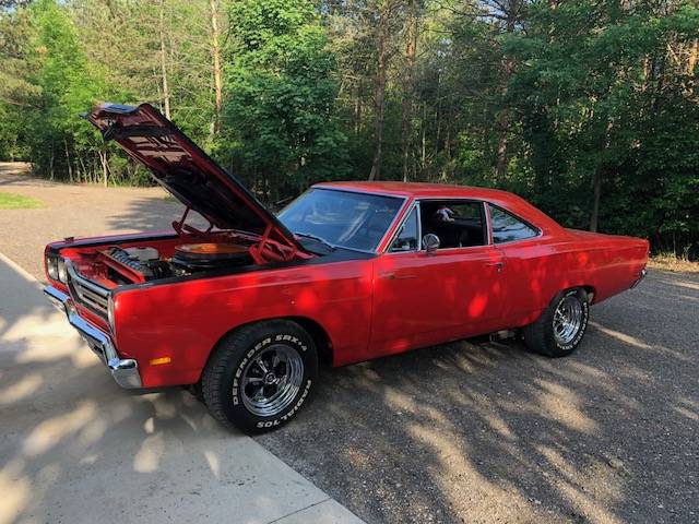

15 x 8" with 4.5" back-spacing and a 4.5" bolt circle. I run 275 60-15"s. No rub. Have also run the same wheel size with 29.5 x 9 x 15 M/T Bias Ply Slicks. They look even better!
