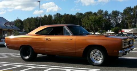

Ok thanks guys I think I got it figured out, I'm going with 26x9.5x15" with bf goodrich t/a. On weld draglites.

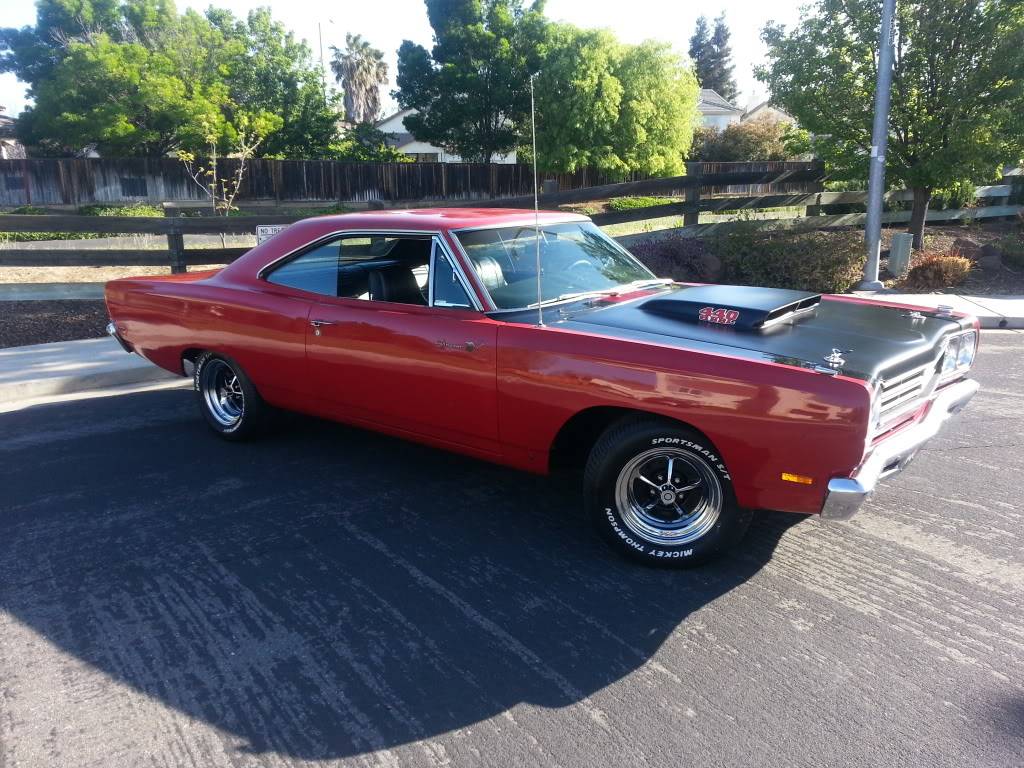

Awesome car, I've got a T5 Runner as well. If I remember right my rims are Crager SS 15X7 in the front with 235/60-15 and 15x8 in back with 255/60-15
