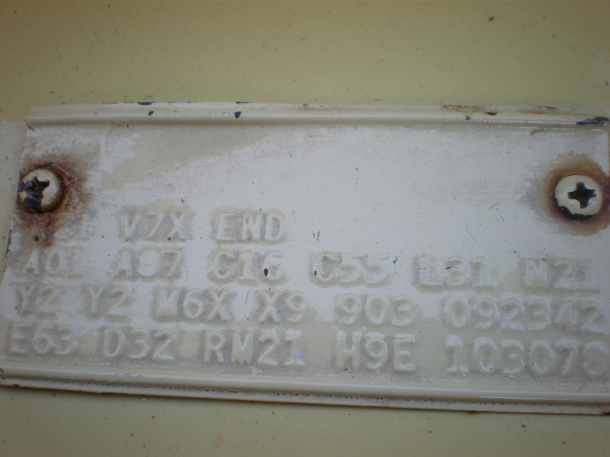

Ok so I just got home from a holiday to the states, while I was there I bought came across a sufire yellow Roadrunner and fell in love with it. I think it's called sunfire yellow, anyway the gentleman I bought it off was the second owner and said that aside from an exterior paint job and a couple of crome pieces under the hood and obviously the wheels the car was essentially original. Now I don't really care as I like it how it is but i'm quite interested in what the fender tag means.
I looked in another part of this site and found some decode information but i'm still scratching my head a little. My questions are.
A87-Decore package, is this a trim thing and does it include the stainless steel trunk moulding and rear tail lights as mine has the plain tail lights with the little bird sticker in the middle.
V7X-Longditudinal Side Stripe, what does this option look like mine has it on the tag but it's not on the car

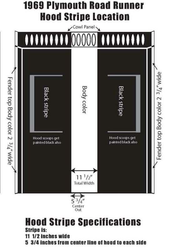

The other thing I couldn't really figure out is did all Roadrunners have the black hood stripes or were they an option. Mine has a plain yellow hood with black vents which doesn't seem right to me, I'm just trying to figure out what the hood colours should be.

Thanks dude, with the tail lights I just meant the decore package on the 68's had a stainless steel insert that attatched to the trunk and ran in between the tail lights, it must have been a 68 only thing though. Where would you find the dimensions for the hood stripes, I know they aren't original for my car but I like the look of them. If a car doesn't have the hood stripes from the factory should the hood vents be black or body colour, mine are black and on a yellow car it just stands out and looks odd.
Thanks for you help, i'm really getting into this.
The "lumps" are body color, with the ribbed insert black. If I had a Year One book handy I'd tell you about the stripes, but I'm sure one of the other guys will post somethin for ya.

The other thing I couldn't really figure out is did all Roadrunners have the black hood stripes or were they an option. The V21 hood performance treatment was optional

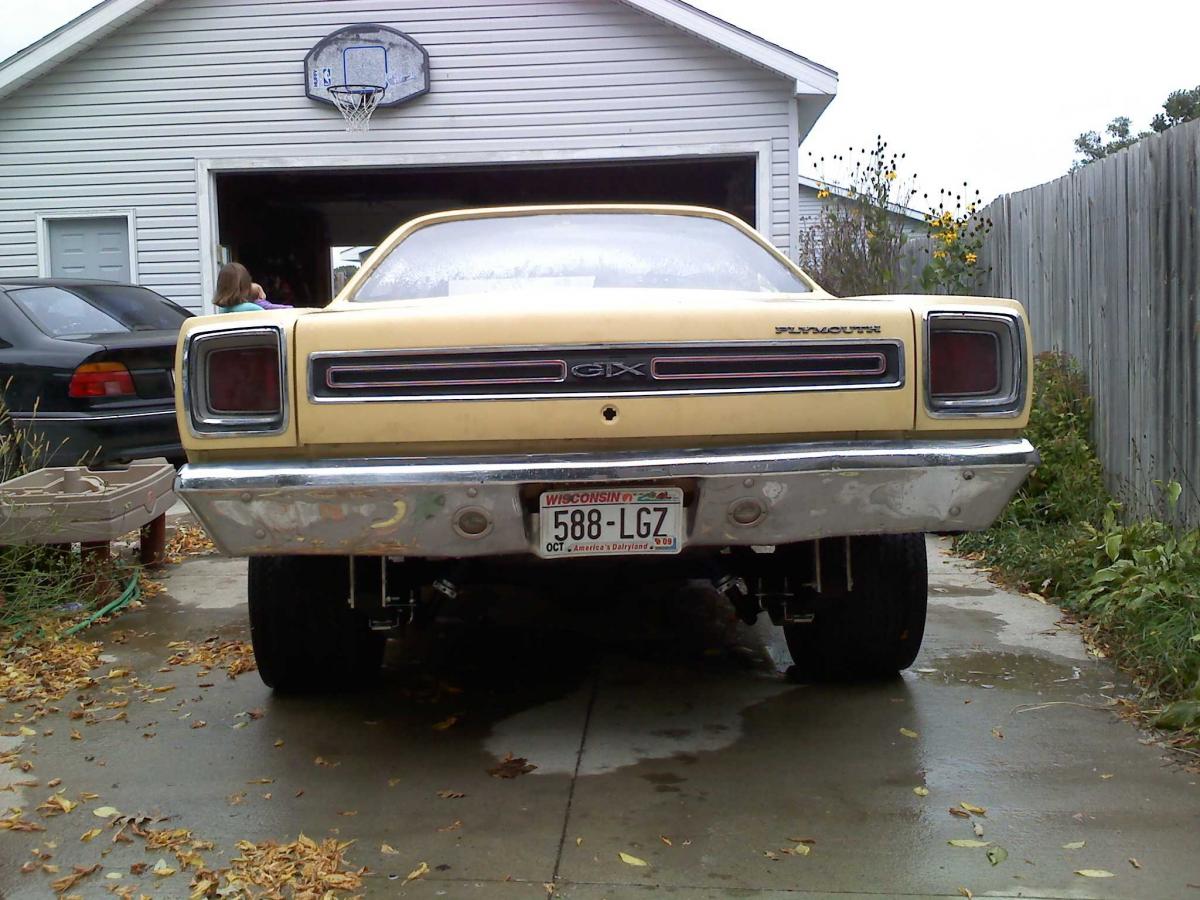

Off the top of my head your car is a 383 auto built at the LA plant. Color is yellow with black interior. Decor package usually means a trunk finish panel (similar to the GTX pictured) and I think full wheel hub caps. Road wheels were and option. I'll look up your tag when I get home.
The A87 decore package didn't include trunk trim like a GTX. It had rear armrests with ashtray, B pillar trim, exhaust tips, partial horn ring steering wheel, bright door panel trim moldings, and bright arm rest bases. Console, buckets, fender mounted turn signals, drip rail moldings, AM/FM radio, and longitudinal accent stripes

OK, here's your car: A01 = light package A87 = RR decor group C16 = Console C55 = bucket seats L31 = fender mount turn signals M21 = Drip rail molding R21 (looks like R) = AM/FM radio V7X = aforementioned hood stripes.
A87 calls for vinyl trim (probably for a top as most came with vinyl tops), rear arm rests with ash tray, B pillar molding (for vinyl top), exhaust tips (exc w/N97), deluxe steering wheel with partial horn ring, bright door trim panel moldings and bright arm rest bases. N97 = noise reduction package. Makes sense why no tips. No mention of wheels or trim panel.

V7X = side stripe. The hood performance treatment is V21.
The Vinyl trim = upgraded interior to the H2 vinyl bench seat or M6 vinyl buckets.
A vinyl top would be coded on the tag and this car is not coded for one.

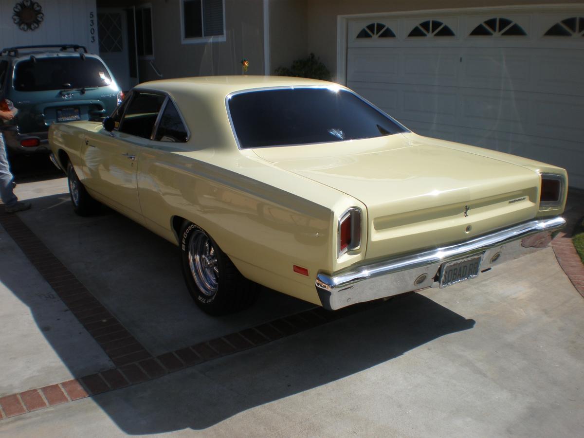

My father purchased this color Roadrunner, and it was called Yellow Gold. It is the lighter, pale yellow showing in the first photo of the Roadrunner. We purchased it new in the summer of 69. The car had no black hood stripes. The interior was kind of a bronze leather. It was a 383 4 speed. I owned the car in 75 when my father passed away. Sold it to my brother around 1980. He gave it to a friend for restoring, and use for a couple of years. The "friend" sold it shortly after, and we lost track of it.
:iamwithstupid: the Color is Y2 Sunfire Yellow or Y3 Yellow Gold, I can't tell by that photo above on my screen anyway
