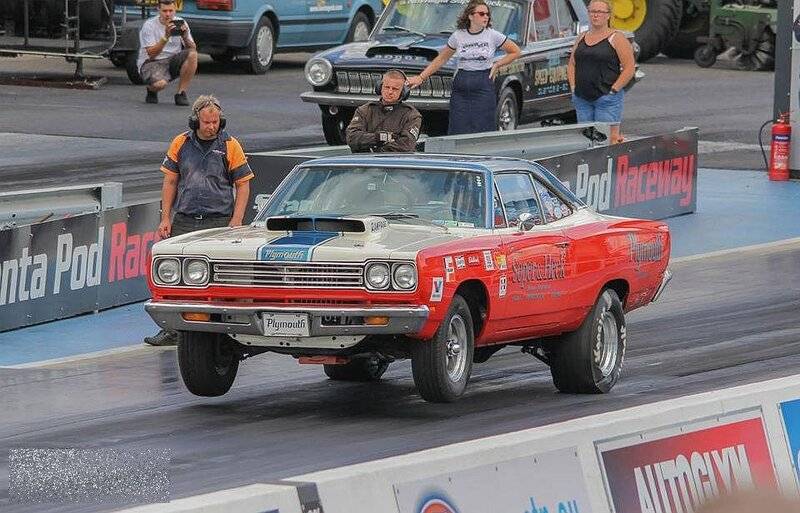

Getting better, 1.43/1.43/1.45 60's, 10.45/10.45/10.49 ET's, not killing the tyre so much now@16psi, some ways to go yet, we have a competitive brkt car now apart from the 1st round red light loss (-0.012).. 10.45 on a 10.44 dial, not good enough>
Nice!!
Great looking launch pic:thumbsup:
X2 I was just thinking that! The front tires look like they both came up the same height. What kind of frame/body stiffening structure(s) does the car have? Roll bar? Subframe connectors? And/Or?
I just had USCT subframe connectors and front and rear torque boxes welded in, and front inside and outside leaf spring hanger reinforcement plates installed.
I have a 541 stroker planned, block on order, so I'm getting my car setup for it.
Excellent launch attitude. Great 60'. If you don't go red sometimes, doubt you will win much. Of course I may be defending my MANY red lights. LOL
thanks guys...nothing exotic, frame connectors and a 5 point cage, he didn't want a bar in the passenger side:rolleyes:. Forgot to say bottom hole still on caltrac bar with 1.0 flat preload and 9-ways on 7 hard not that the info will help anyone, let me tell ya caltracs/mono's ain't easy to get right, were still not there yet although John is happy, me not quite so, perhaps I'm being a bit too hard.

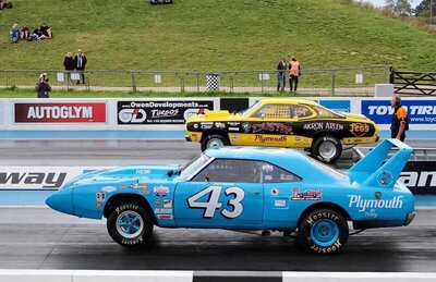

And this was the car we lost to, thought it might go down well>

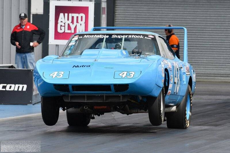

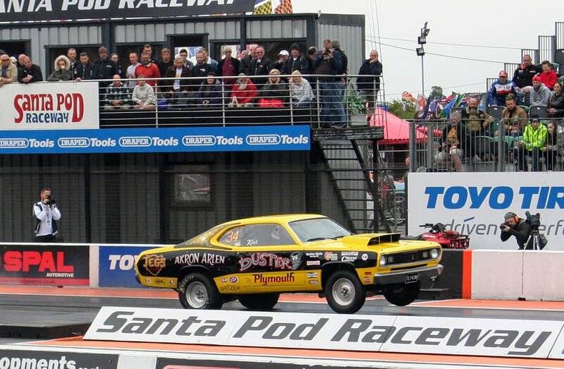

Well here's one more and there's others, like the orginal SS/IA Rod Shop challenger.....its like going back to the 70's...UKNSS is growing to be a very popular class>
There's no 1 setting for all cars as you know Bio, sussing it out hasn't been easy and we still haven't got it real good.

I'm biased...the Roadrunner you are working with and the Superbird were GREAT!!!! Funny thing is, as much as I love the 70 Roadrunner, 69 and 68 as well, and as great as that 'Bird pic is lifting the front wheels at the launch-nose cone, wing, and all, and for me to own a Superbird tribute car (twin turbo Gen 3 Hemi powered, made to handle, stop, and go on the open road) would be a (another) dream come true,, I just find quarter mile 'Birds and Daytonas "out of place".
Well, the blue one is cool, and then there's THIS!!
I've got a t-shirt from a different, tho similar power, voodoo hemi.
The one I saw had a blown hemi too, in a 37 Airflow coupe.
Edit: my mistake, 35 Airflow sedan. Google voodoo hemi airflow.

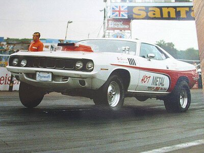

Yeah birds don't quite look right in d/racing to me as well, the 43 tribute car runs a 572 Hemi with 2 x Doms and has gone in the 9.6's@142, the voodoo Hemi runs a lot@SPR, has gone 5.90's, recently suffered a bad crash but back together now. As 33IMP said, they do have a nice advantage with the nose cone in a close 1 in the traps, there's quite a few '65 Belvedere's and a '66 charger, only car we don't have is a 70>74 Cuda racing, keep thinking about it but always come back to the fact that I've been there and done that 30+yrs ago.....And there's only 1 mopar using SS springs, every other car is mono's/ caltracs.

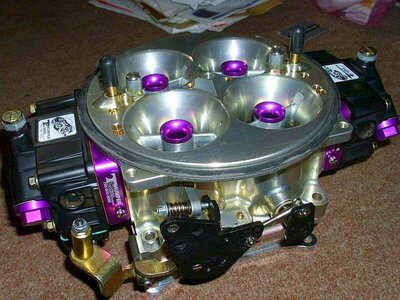

We got a real nice Thumper BLP Billet Dominator carb to try at the track over that puny 830cfm (950hp) which pulls 2hg@6000, reckon there could be a 1/10th or so in that (even though he doesn't really have enough converter) and some mph as were a bit down, but it won't be going on till next year I'm told, thats if I don't sell it first, don't want it sitting for 8mnths really, personally I would be itching to try it, we got enough motor for it (589x6000+3456x101%=1032cfm....Last outing Sept 27>28...so at least I won't bore you lot with all this till then:)
