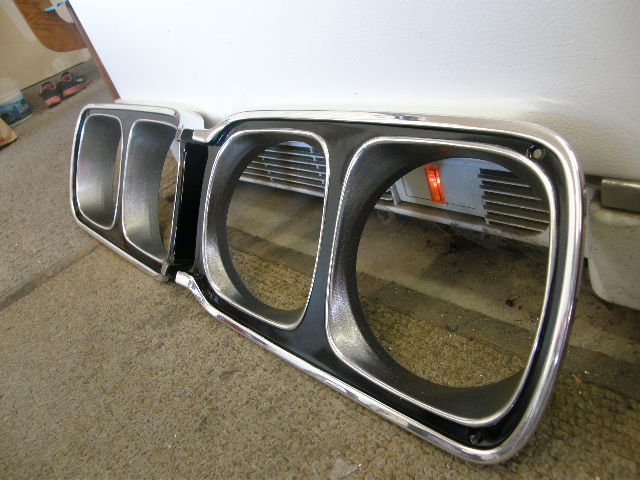

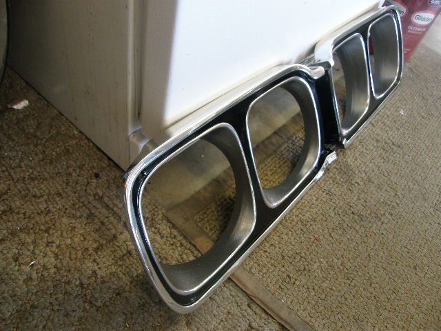

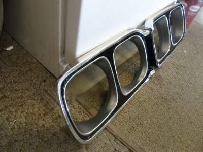

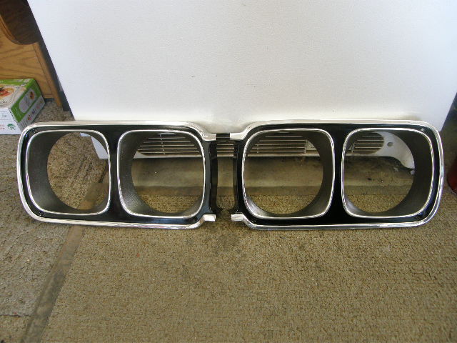

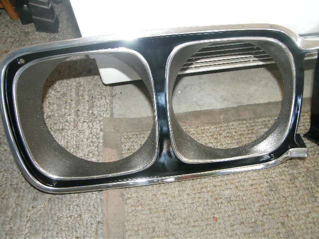

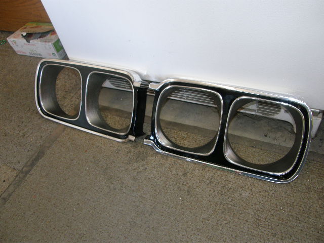

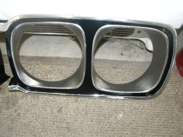

Bezels are finished. Now to paint the grille and I'll be done.

It's done!!! Going in the "for sale" section.
