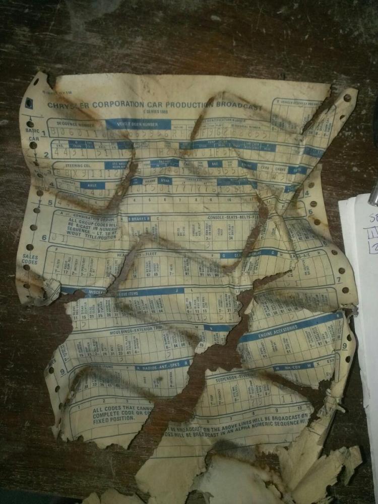

The broadcast sheet is in pretty bad shape. But I'm keeping it anyway. You can make out about 97% of the codes on it.

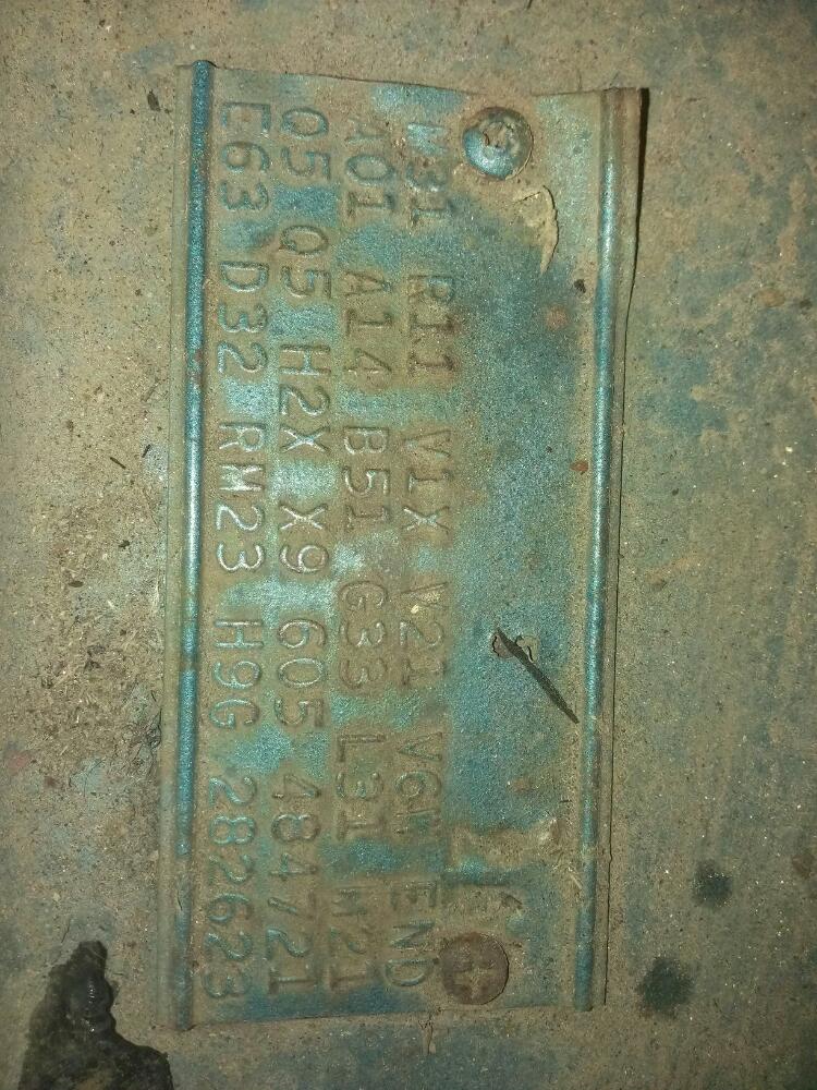

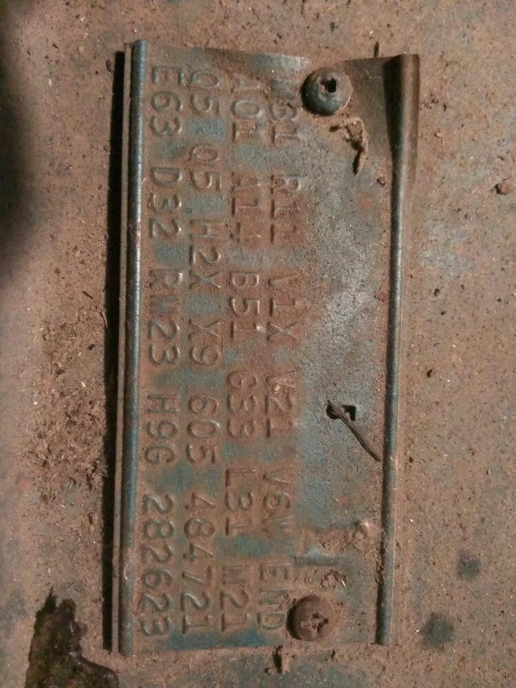

And here's the code plate. With and without flash.

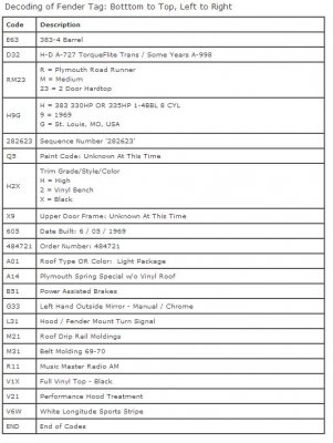

Great project car & pretty damn solid to start with, from those photos anyway, that Q5 Seafoam Turquoise Poly paint is cool, very much like the LL1 Surf Turquoise Metallic from 68, great color....
Sorry to hear about your dad but it is a great story keeping that old Bird alive and Q5 is pretty rare.Great color as well.Incredible what great condition that floor is in.I've just done my first bit of restoration on my 70RR which was kept to the engine compartment but it was a blast...enjoy your build...cheers
