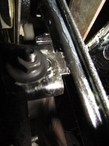

There is an adjustment down at the bottom of the front slide! It kicks the window in and out.
Double check the two roller assemblies that attach two the vertical bar. The ones with the smaller steel rollers. I missed one and it went up and down but was way out of adjustment. Corrected that and had to go back to all the original settings.
