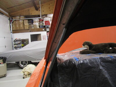

I've installed all my side windows and the chrome piece that attaches under the drip rail. I also installed the weather striping in that rail. The front and quarter window match the seal perfectly. The rear quarter window curls in toward the interior of the car when rolled up. I have used up all the adjustment in the mechanism and repaired all the nylon rollers. They were sliding on the pins that held them in place. the mechanism and the windows came out of the car, so know they should fit. The rear of the quarter window is almost in the right position. It's the front that is at least 5/8 in off. Any suggestions?
There is a bottom adjustment too! If it came out of the car, it should fit! I'm putting my quarter glass in soon
so I've done exactly what you have so far.
There is an adjustment down at the bottom of the front slide! It kicks the window in and out.
Double check the two roller assemblies that attach two the vertical bar. The ones with the smaller steel rollers. I missed one and it went up and down but was way out of adjustment. Corrected that and had to go back to all the original settings.
I have moved the bottom adjustment as far as it will go. I fixed all the plastic rollers that run in the frame. most of them were loose. I pinned them in place. There was one floating roller that road in the back vertical rail. I left that one alone. I have adjusted every adjustment screw in multiple combinations. No luck. I'm giving up for the night. Tomorrow is another day.
You have something out of place.

I have a profession glass installer here to put in the windshield and back window. He tried to adjust it and came to the conclusion that the curvature of the glass may be wrong. I tend to agree. I just needed another set of eyes. I'll buy a replacement piece and try that. If it works, I'll get one for the other side. There a hundred different places to get the glass. I think they get them all from AMD. AMD supplied me with a wrong curved glass for my Super bee door window. They did replace it, no questions asked. Unless someone has a better source, I will order from them. I'll wait to hear any suggestions.
