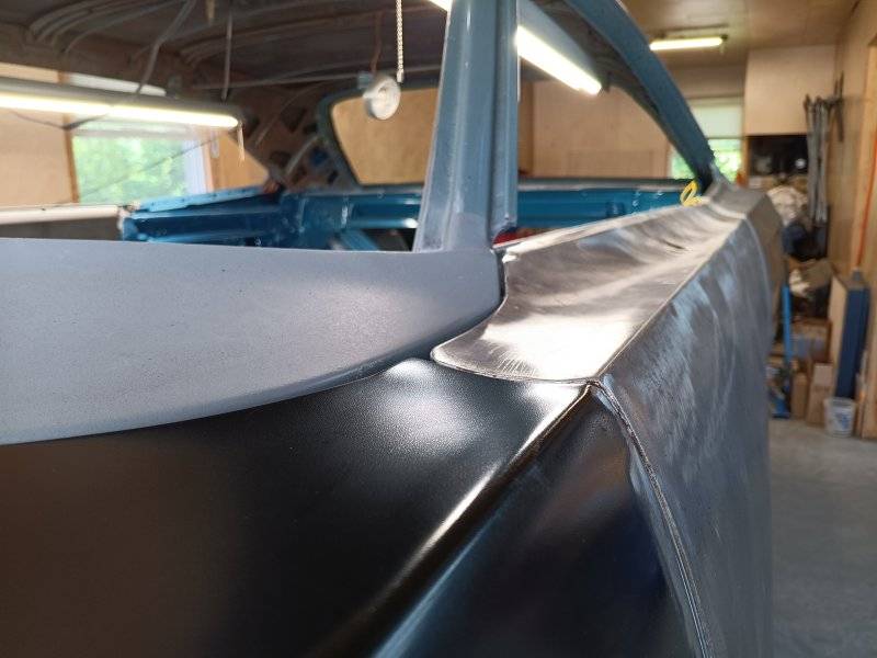

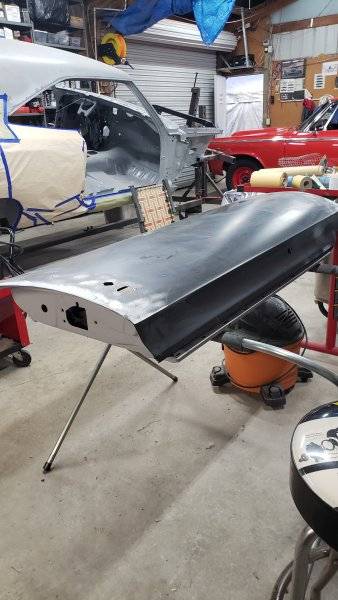

Coming up on the end of the bodywork and just got everything fitted back up. Needed a new PS door and at the time could not find a good used doner door, so went with an AMD replacement. I know new parts will never match original but it is what it is.
Any thoughts on fixing the fitment, i was thinking bending the gap out brings it close and adding some metal to the brace that comes across to keep it placed. Any other ideas or anyone have the same issue? Also the inner part is lower than the outer a decent amount, not a huge issue, but it bugs me the more i see it

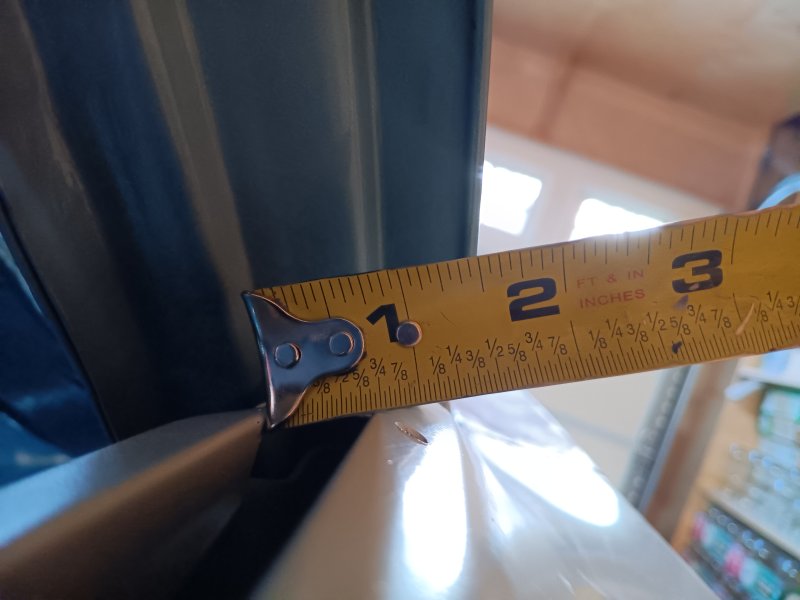

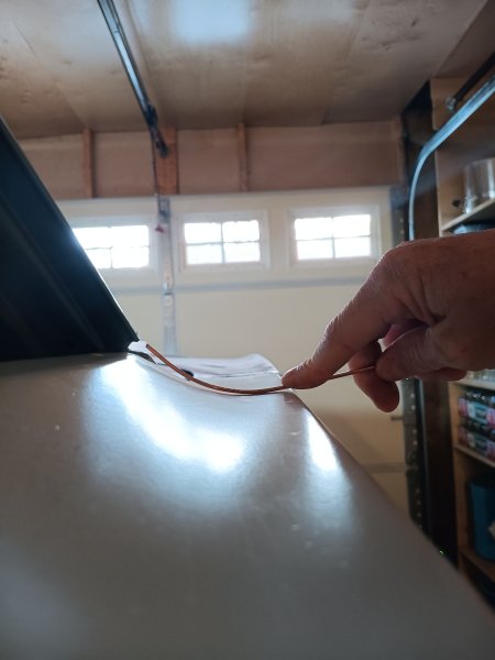

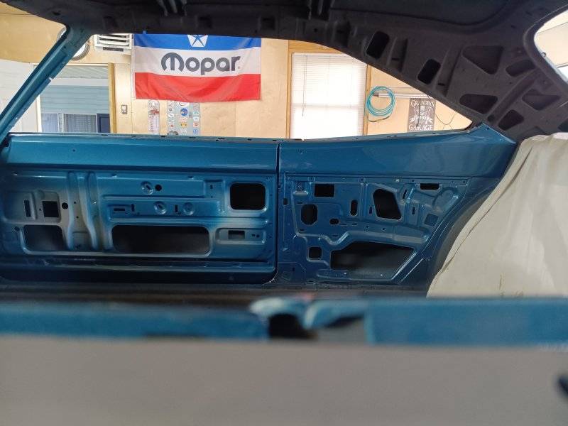

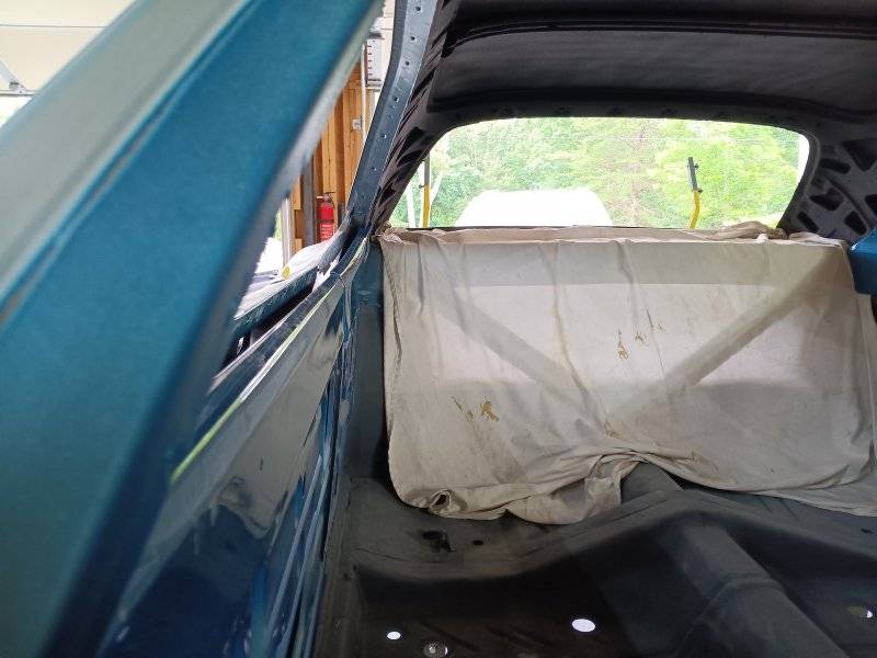

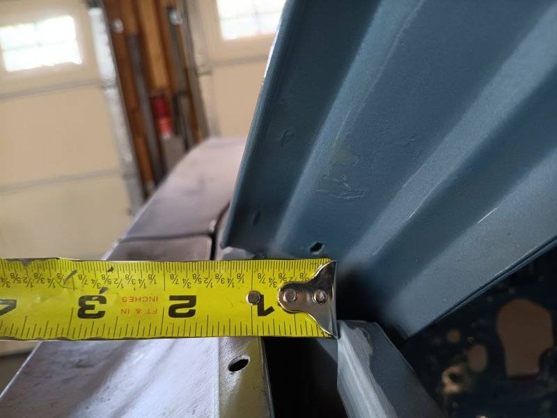

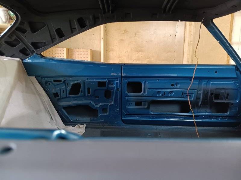

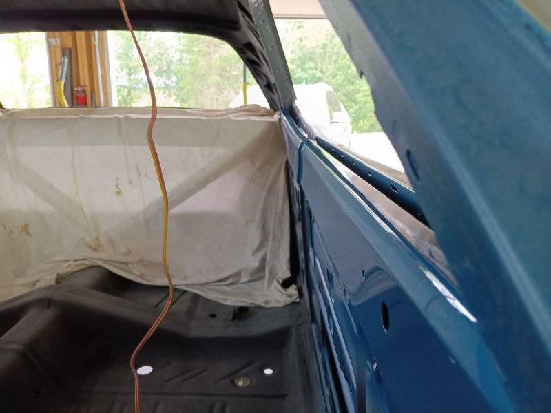

So been a year,should be painted hopefully within the month, only two months late from the 2nd date to paint, so 11 months late all together. Anyway all the internals and window felts fit. Little trim here and there along with some bending, but nothing major. Wouldnt get a repop again, unless 100% only option. Here is something that wasnt expected, didnt really notice. The interior upper panel is shorter in height than an original. Mabye this is a one time miss bit if you buy the repop check before you body work it. Here some pics if you can see the height difference in doors 1st two is factory DS. 2nd two are AMD door. Might have to zoom in.

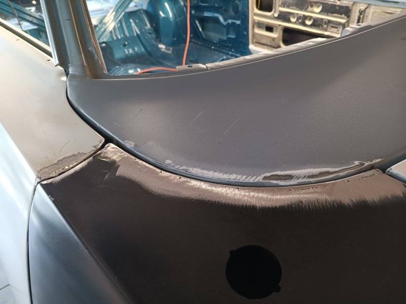

Ended up with a temp spacer to hold the profile and tacked the upper inside just forward of the vent window to hold it in panel spacing
