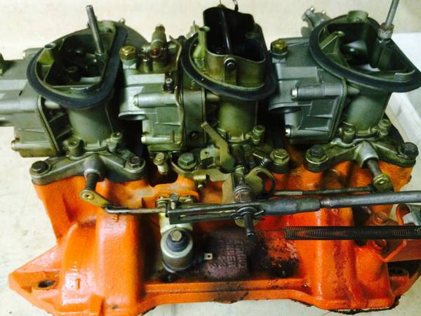

Here is a picture. Does the linkage look correct?

Doesn't look like aluminum from here, and like said the bowl on the center carb should not have the vent, and all the list numbers on the carbs need to be for a 69 if your looking for correctness.
The solenoid is correct for 69

Center carb is wrong; I compared it to mine. Since, the center carb is wrong, the value goes down. I would still buy it and then find a used or buy a new center carb.

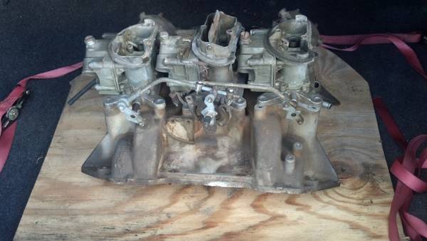

what about this set up ??

i just bought this intake and carbs (3412046) with date code correct carbs and an original 69 1/2 A12 lift off hood with all pins and hard ware for $2K
