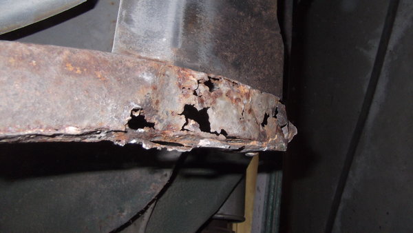

I started on the passenger side. Cut off the quarter and the wheelhouse was worse than expected. So, ordered a new one. They dont make one for a convertible, but after some research, I figured if I cut the new one down(like they did to make convertibles). Still I didn't remove the old one till I got the new one , to compare. Some pics for you junkies:headbang:

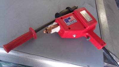

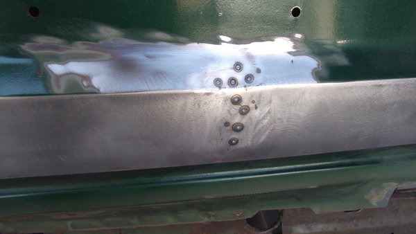

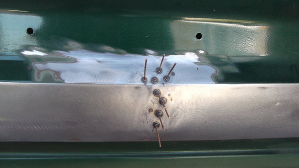

While I waited for the wheelhouse, I worked on a dent on the trunk lid. It was in a tough area where I couldn't really get behind it. So, I could take it to a body shop to use a pin welder on or I could use this as an excuse to buy a tool. Guess which I chose? I have wanted one for a while and although I won't use it everyday, it's an invaluable tool. Here's my ebay score and the dent.

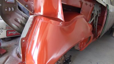

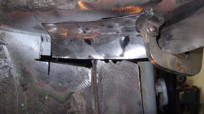

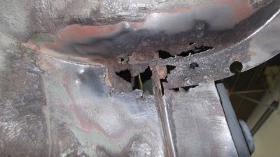

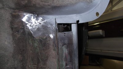

Anyway, heres the latest. Wheel house had some rust at the top front. It was hiding under a big glob of sealer. Had to patch it as it was on the inner wheel house, which is staying. There were two layers to patch. First I cut through both layers. Patched the one layer, then patched the other layer. Finally, I cut down the new wheel house and welded it in. At the front, I spliced it as I didn't want to deal with the flange. That would have been alot more work as the flange goes to the inside of the car. The conv. top cylinder is there and i'd have to remove that and maybe the top to have access.

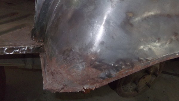

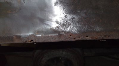

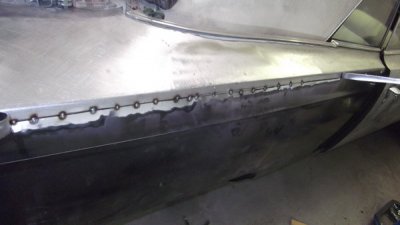

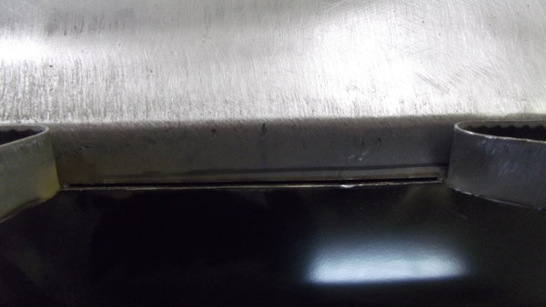

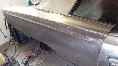

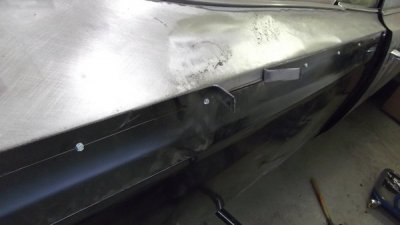

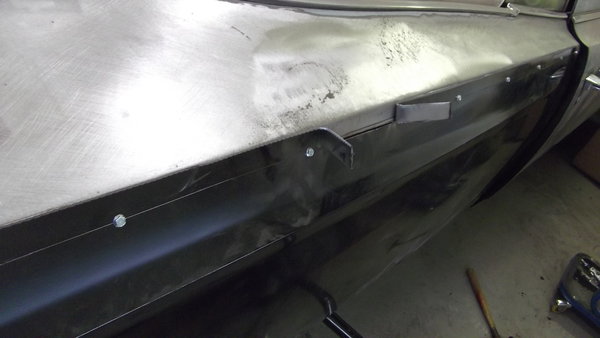

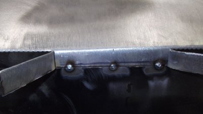

Passenger side quarter skin is on! I did a better job on this side. I think the experience of having already done the other side helped. Overall, I'm happy with the AMD skins. They fit pretty well. I did have to rework the spot where it meets the lower rear of the door(like Northerndave did) but just on one side. Also you have to make little triangle fillers to seal up the area where the panel curves in for the bumper(original panels are more of a 90 degree turn there). The other area is where the skin mounts to the rocker at the lower front. Amd has a lip which shouldn't be there and has to be removed. I have some pics showing the technique I used on the pass side. Worked really well. Enjoy the pics

nice matal work. i like doing quarters it always looks so good when the fresh metal is on! the prep work kinda sucks but the end result is nice.
Wow, excellent work and the pics of the raw, and the done areas is awesome to behold! I like how you even went inside the qtrs and painted them up too, man, that's a real craftsman folks! And thanks for the good words! Oh yeah, TV shows SUCK compared to this site, most (if not all) are product-placement events and geared for the part time hobbyist, but never for the industrial scale level, and they are SOOOOO long, laborious, and way too clean, way too shiny and way to 'brand new'. This stuff here is all real, and very educational too!
