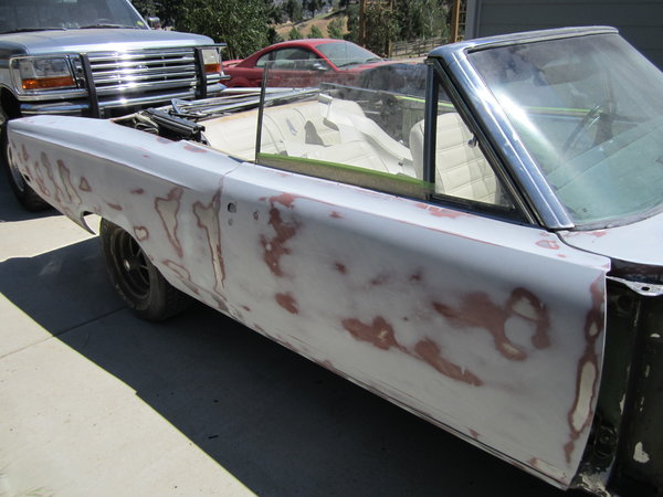

Haven't updated in awhile, camera is broken. I have been doing bodywork on fenders, cowl, and quarter panel tops. For me, this means applying bondo then sanding it off. Then repeat numerous times! I really wish I had taken a bodywork class. Anyway, I now have the car ready for SPI epoxy and quick sand. I'll try to post pics when camera gets fixed.

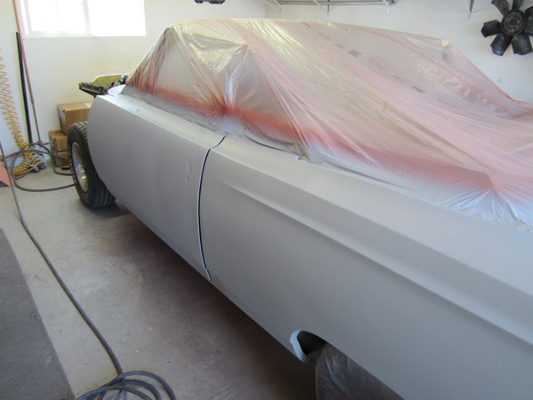

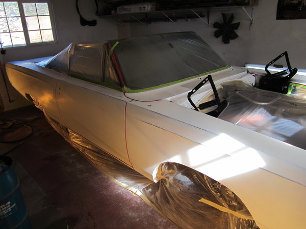

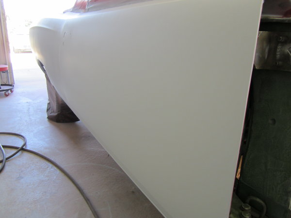

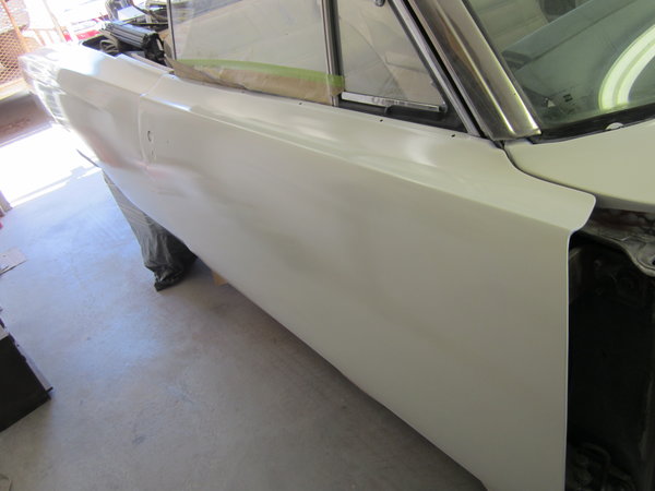

Resized a couple more pics to post. After blocking the first round of primer, I put on two more coats of primer and blocked with 180 then 320 dry. After that, I covered the body in white epoxy. Here's where i'm at now. Hoping to paint drivers side jamb and door tomorrow.

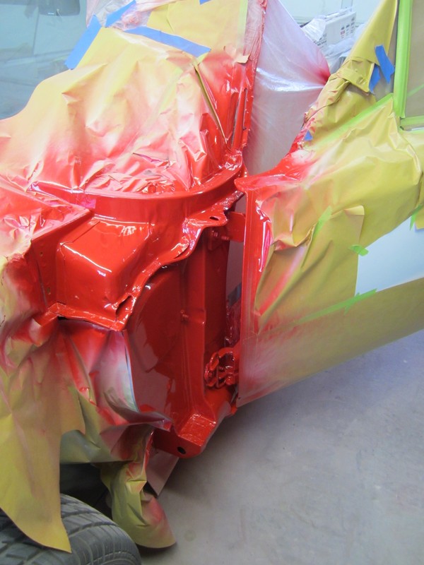

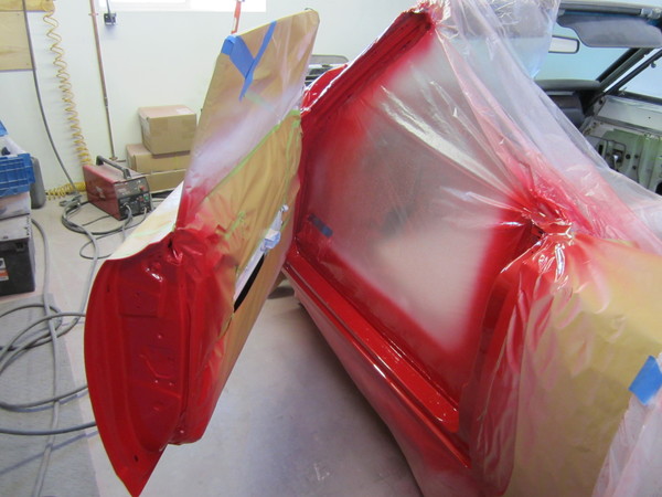

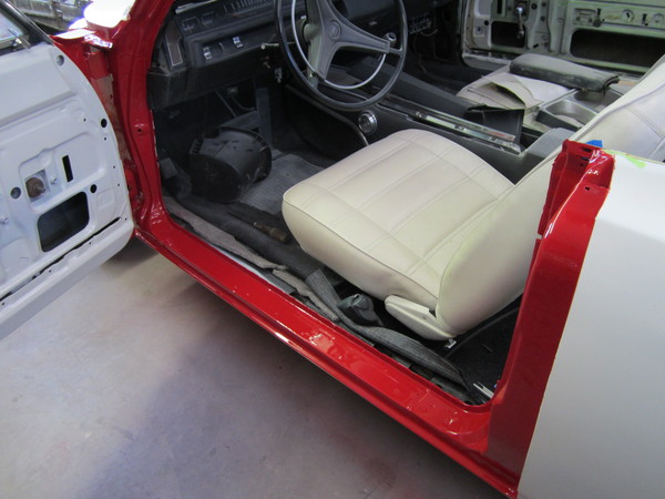

Finally some color!!! Did the driver side jamb today. White on door was done earlier. Enjoy the pics.

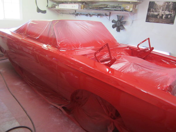

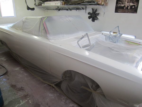

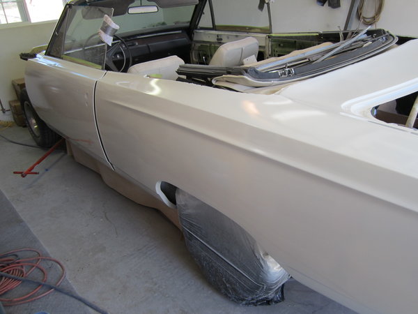

Been making slooooow but steady progress. Shot sealer then finally color!!! Pretty happy with the results. No runs but does have a fair ammount of dust/trash. Looks like I'll be color sanding and buffing. I better read up on those subjects. It will be the first time doing that too! rsz_sealer_and_color_014.jpgrsz_sealer_and_color_017.jpgrsz_sealer_and_color_018.jpg
