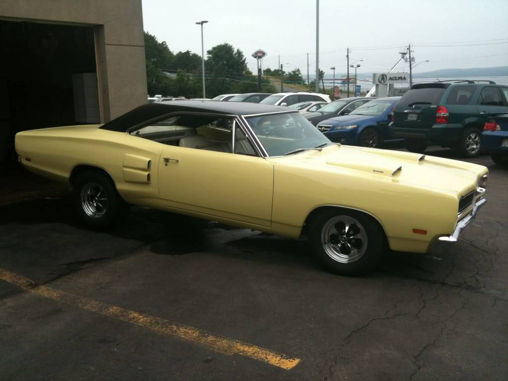

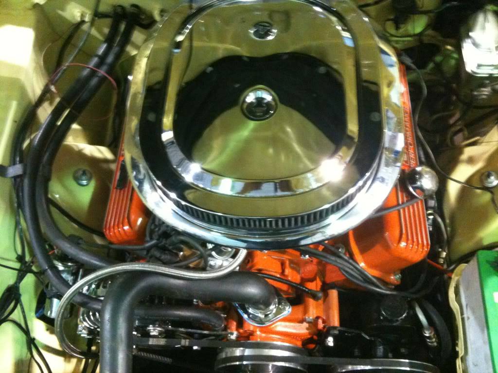

Just "finished" my superbee build. a few specs on the motor 454 lift cam, edelbrock aluminum heads, 800 cfm holly 4 barrel msd ignition, and full length headers to name the jest of it. It performs good but not as good as I expected. The stock intake manifold is holding it back. Any guys out there who have done some fabricating to make a high rise work with the ram air. Any help is appreciated.
Very nice Super Bee! Back in the late 90's, I used a modified aftermarket fiberglass base that was cut down at the carb base to clear the Ram Charger box and fit properly.
Im sure others have modified the original bases as well. The base for 440 models (R/T & GTX) is a bit shorter as well.
One must have for that set up is a good torque strap. Otherwise under hard launches or acceleration the air cleaner will raise up and smash the the air box into the hood causing it to chip and break. I found that out the hard way. I would use one that limits the engine movement as much as possible, like the Schumacher one.
Good luck and again, Very nice 'Bee.

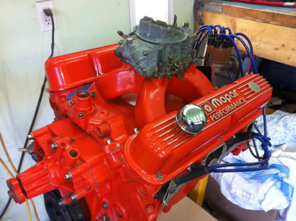

Thanks for the info guys. I want to run an m1 high rise. I think this added with the gear that I am already running would really turn it up.

I lied a bit I think what is on it now is a edelbrock dp4b. I called it stock because it doesn't look like that big of an improvement over stock to me. As I said above I would really like a high rise m1 to drive some air into it. Its the missing part of the equation there is more fuel, more spark, lots of room to push exhaust but I think it needs more air.
looking at the pics again, you have an edelbrock performer (a dp4b derivitive). back in the day i had a 383 4spd '68 road runner. i had a set of 1 3/4 hookers, crower 201hj camshaft, dp4b with 780 holley, 4.1 gear. it'd run low 13's, with a couple high 12's, all day long sliding around on 7" tires. i'd re-visit the camshaft, tinker with the heads and tune-up. i don't think the intake is an issue. 383's don't make a lot of torque. big tires and tall gears will make them lazy on the street.
My friend who helped and guided me with the build has a 68 charger 383 4 speed stock heads that he gasket matched, similar cam to mine, m1 intake manifold, same size carb, and 3.73 gears (same as mine). and his is noticably faster. Looking at that is what has had me think the intake is the missing link.

you already have a '60's era high rise. a modern "high rise" would be an edelbrock rpm and it really won't fit the fresh air stuff. there are two types of m1 manifolds. the stock replacement dual plane and the racey type single plane. the m1 dual plane is a step back and m1 single will probably sacrafice torque below 3000rpm for a modest gain on top. without a little headwork, some compression increase and better cam the benefits of the single plane won't be realized. go after the tune-up before you spend money on an intake. maybe the fuel pump isn't keeping up, recurve the distributor, is the jetting correct? look at other stuff.
