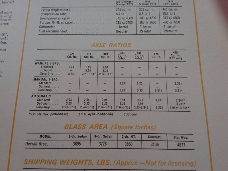

Don't forget some 440 4 speeds got the 3.31 Dana :thumbsup:
3.31 Dana? Only two I know available are the 3.54 and 4.10 ratios

The 3.31 dana 53,9 1/4" was used in 440 4 speed C bodies, and was intended for 440 4 speed B bodies as well, but I don't know if any were made that way. It would be rare. My 67 shop manual lists it for B bodies with 440 4 speed.
