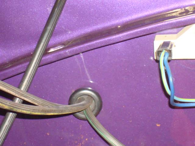

x 3, and the centre of the hole for your air grabber grommet is approx 80mm above the centre of the heater hoses (if that makes sense)
Please excuse the dust and marks on my car...hasn't been used in a while

Many thanks for the additional information! Your measurement confirms that the location is where my car has a dimple in the firewall - so it should now be easy to drill! I just have to wait until the heater box is out and I can do it properly without messing up the firewall insulation or anything else. I don't want to blindly drill through the firewall...
