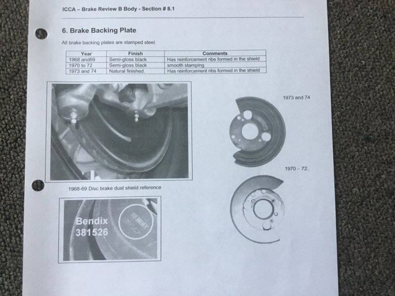

On the 70 to 72 B and E-Body equipped disc brake cars, can anyone tell me the finish on the disc brake splash shields as they were installed on the assembly line? Thanks for the input!
This is from the Plymouth handbook for 68-70 B bodies. Luckily it gives a little bit of info for later years as well. I would think that Dodge is probably the same so hopefully someone else might be able to clarify that for you.

Glenn,
Thanks for the information. The reason that I am asking is that the current reproductions are all offered in a stamped steel configuration other than a light coating of oil to combat flash rusting.

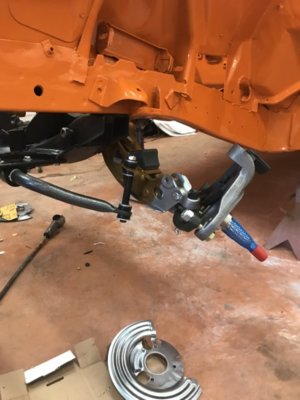

Best I can do Richard... my '70's on my SuperBird. Still have the Bower Bearings in the hubs and rotors had never been turned until I did so in September.

Wayne,
Thanks for the picture that you posted. That appears that the ones installed on your Bird was in fact a semi flat black finish. That is the kind of information that supports the different finishes and in this case that they were painted as installed from the factory.
Much appreciated,
Richard
